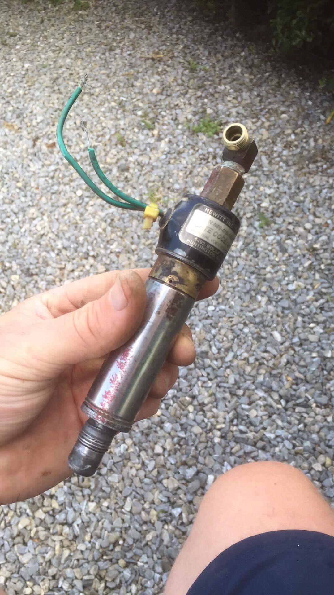

  1. Finally got to the bottom of the shutdown issue, after taking the interior apart and tracking the wiring, locating the Kysor system and sensors it comes down to a faulty acuator solenoid. Looking back I should have taken this off and tested it first however it's been a good process, getting to know the truck in more detail and where some parts are. Below is the faulty part, I have a new one coming from USA be a good week + before I see it here in NZ. Thanks for all the help guys,. It's been greatly appreciated.

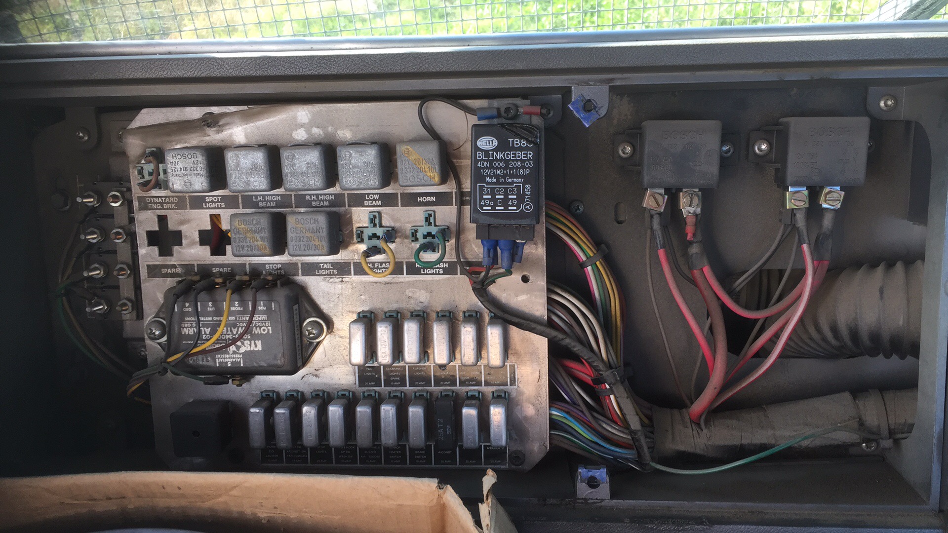

  2. BC Mack I would say your pretty much on the money mate. I found the Kysor system you were talking about and located the oil pressure sensor. I disconneted both the oil pressure and the water level switch and started her up, she ran for close to a minute and then shut down. I played with the wires on the water level and the buzzer altered pitch slightly. At one point the shutdown light on the dash turned off and I was hopeful but then it shut down again. Now I have most of he dash apart and the sensors located I might get a sparky to come and give me a hand.

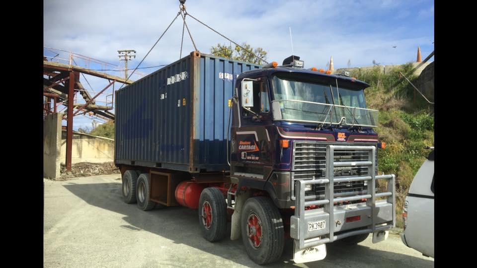

  7. Planning on shifting only one container. She's going to be a motorhome, semi-retire the old girl.
