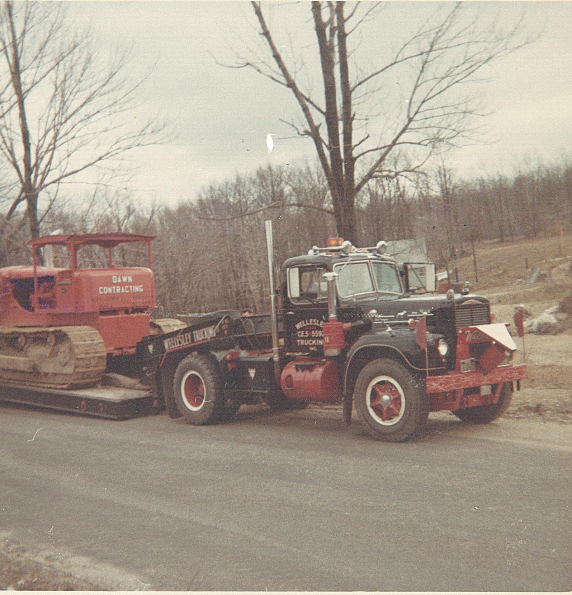

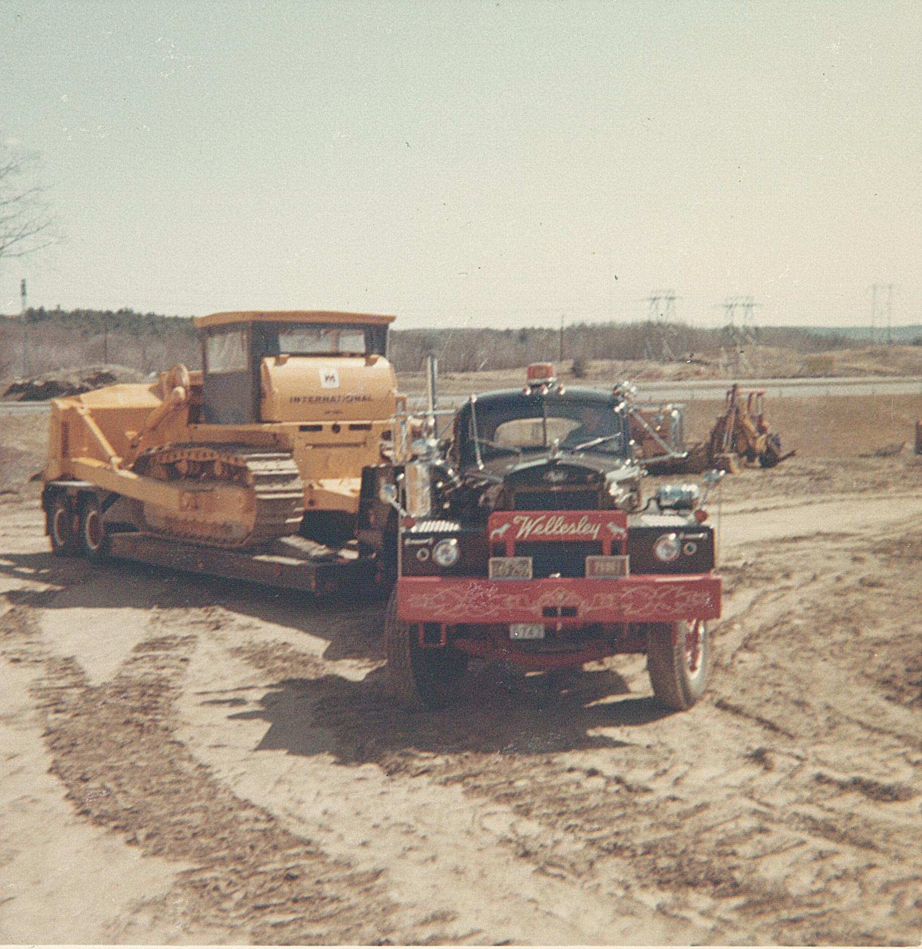

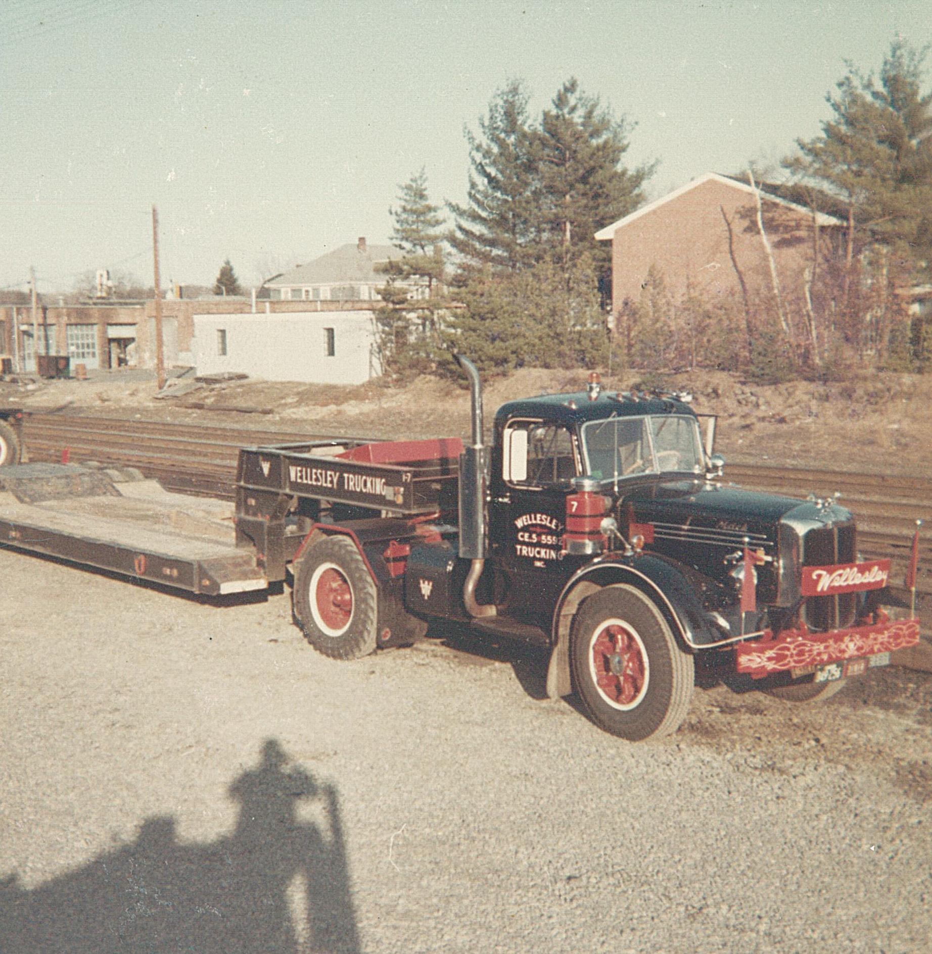

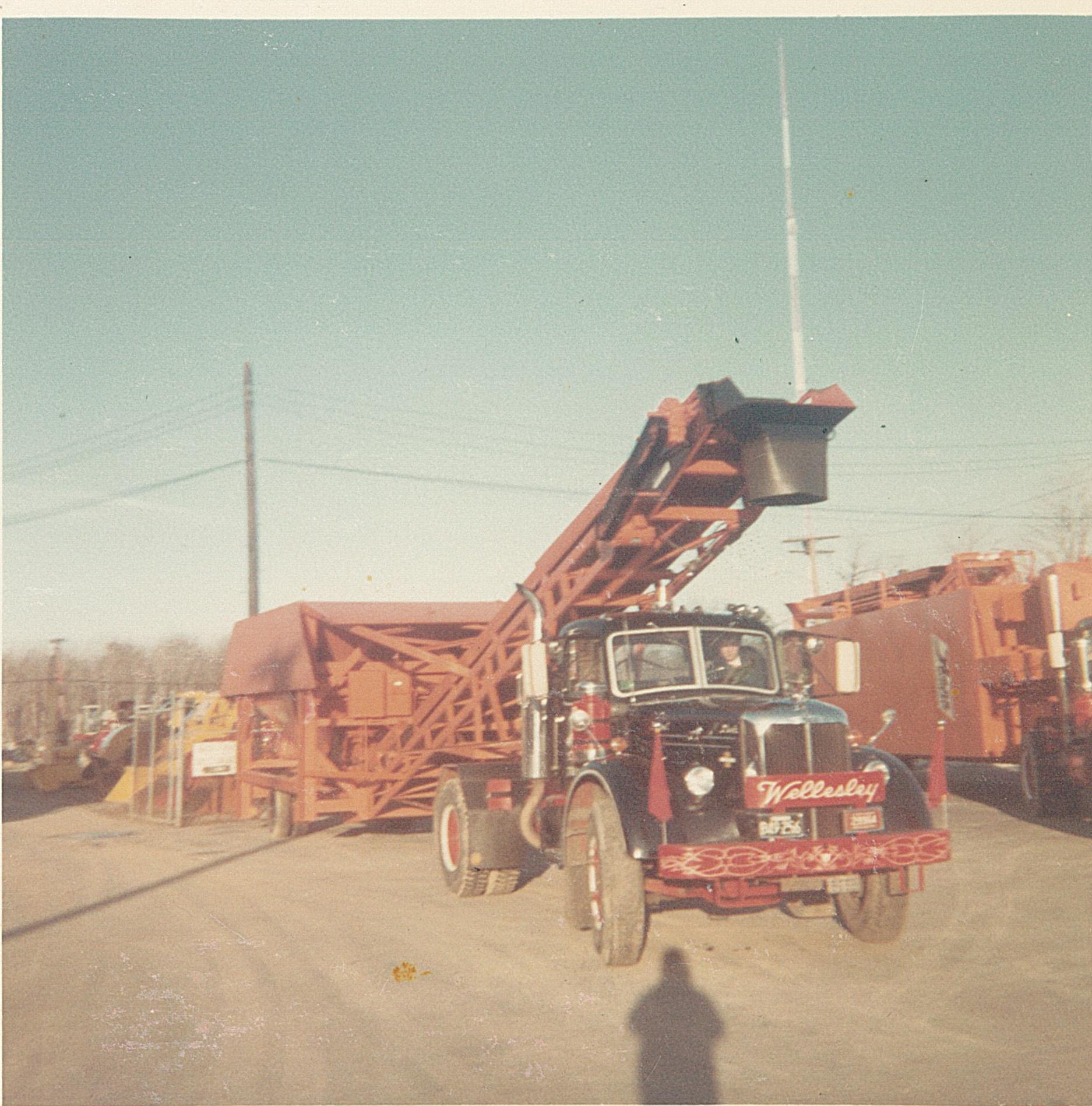

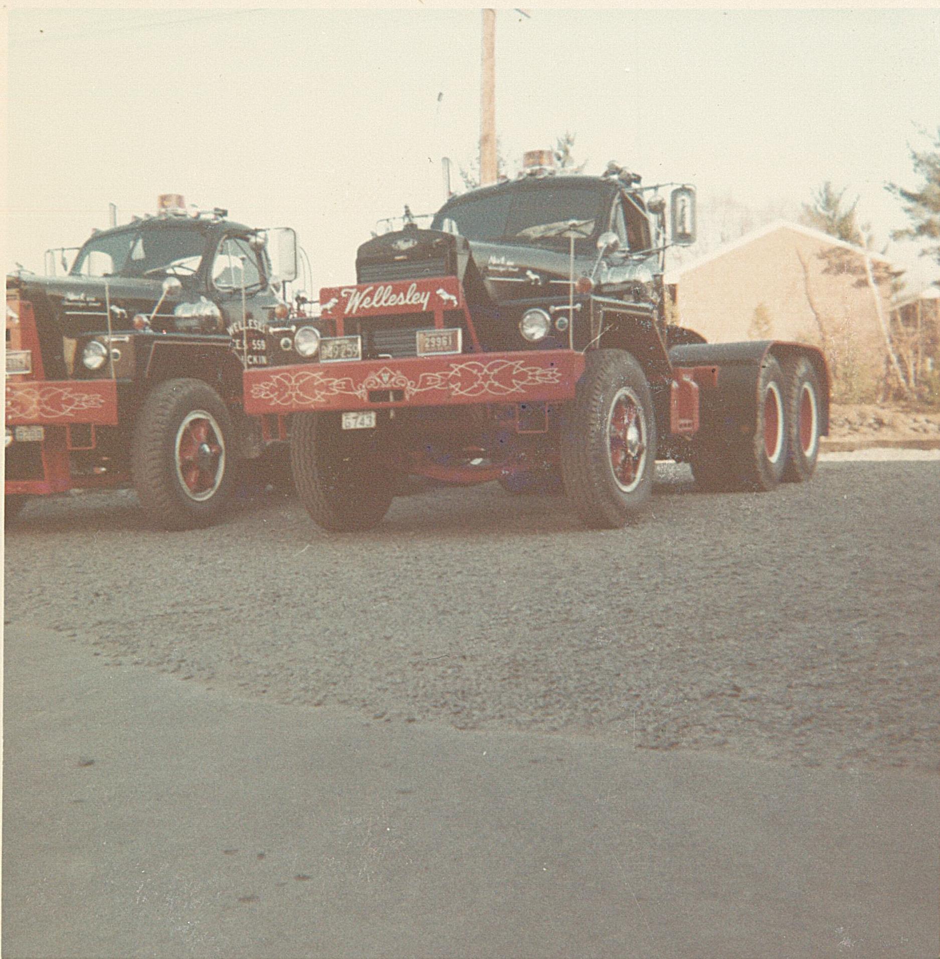

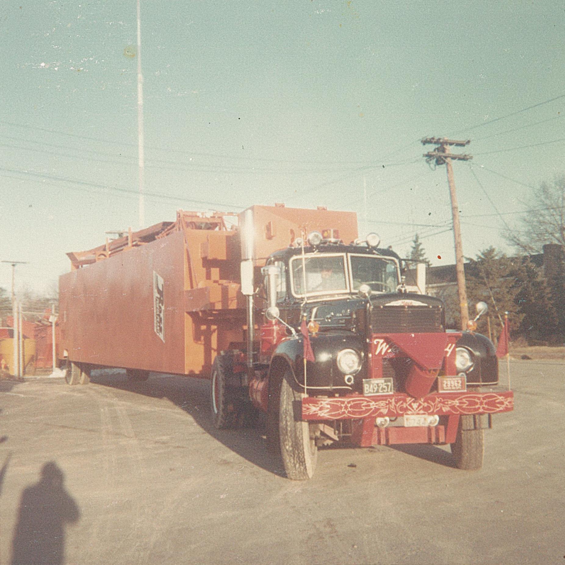

Been a while since I have been on; the political silliness just got too much for me. But, I have been chasing down these pics for a while and they are a pretty good representation of what a New England style paint job looked like and they are very good looking trucks. Thanks to my former brother-in-law Bill Oke who drove for Wellesley Trucking and shared these pics with me. All of the pictures were taken from 1966 to 1969. He did not list the specific models, but the pics captions state the top pic is a 1949 LJ, the second LJ is a 1952, the B-81's are 1966, and the B-75 is not listed. The fleet was two LJ's, two B-81's, and one B-75. His business was moving construction equipment and as you can see some pretty heavy stuff went behind the single axle tractors. The low boys were all Rogers. The B-75 has a plow frame on, and all of the rigs were so equipped for snow season. The goose neck was detached from the trailer and used as weight when the rigs were used as a plow truck.
