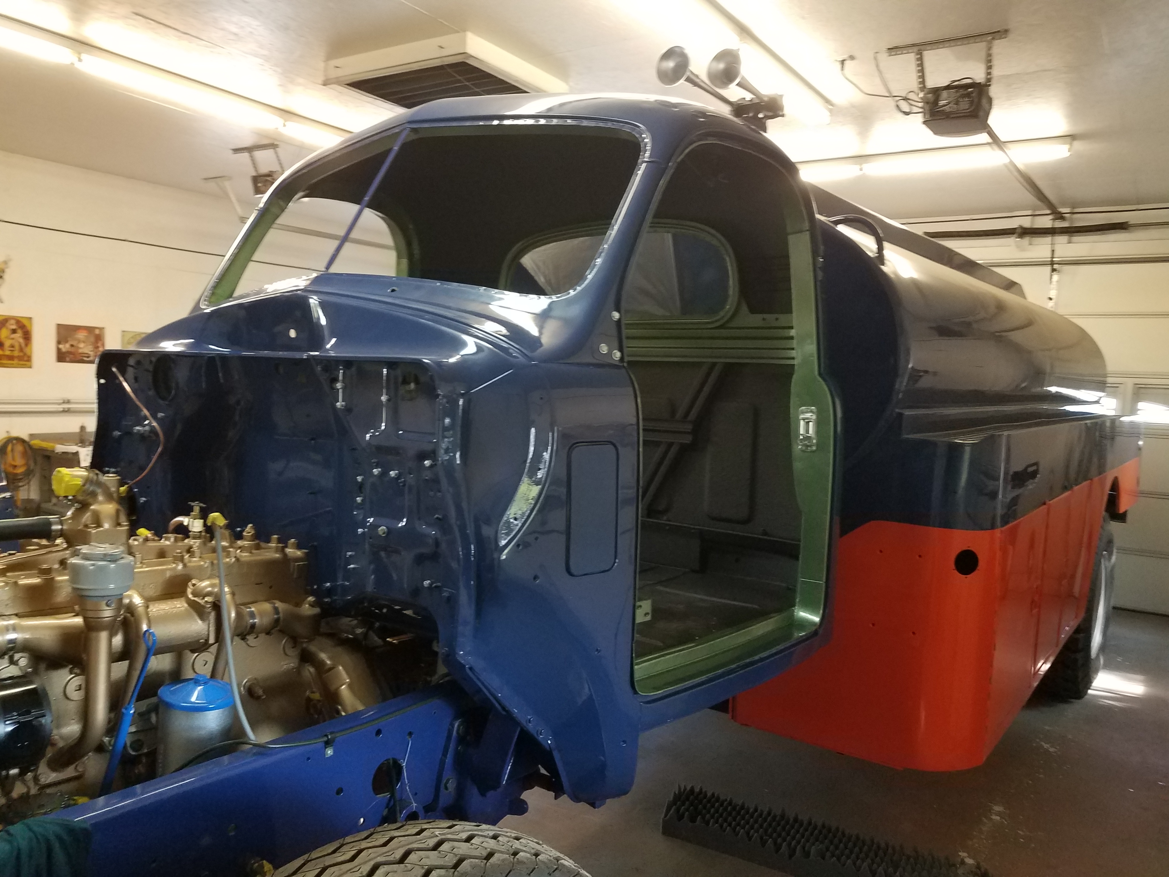

  18. After thinking about it and remembering the beginning of the project, I took the column and box out before raising the cab. I'm pretty sure I can thread the needle by going from underneath the cab. You did ease my mind after reading your post. Thanks!

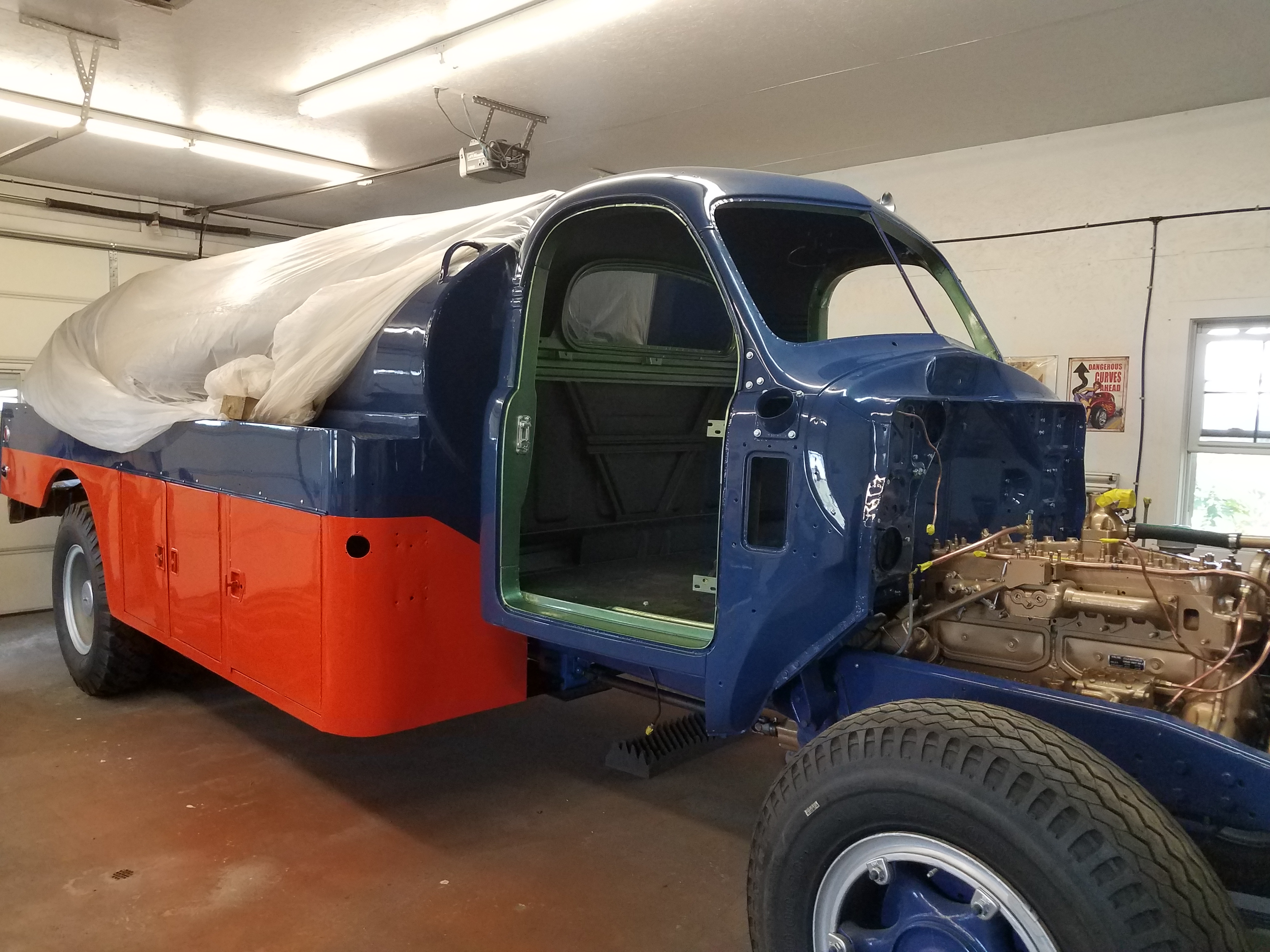

  23. Managed to get the cab on by myself last night with no damage. I used 3 ratchet straps crisscrossed across the cab floor and used the engine hoist to raise it up and place it on the frame. It was a challenge to balance it and roll the hoist at the same time. I almost went in and woke up my wife to give me some assistance. I may regret having it on there now with all the climbing up and down I'll be doing. 😁🤤 Don't pay any attention to the plastic sheeting on the rest of the body, I gotta keep it covered while I paint all those pieces that seem to come out of the woodwork when it's going back together.
