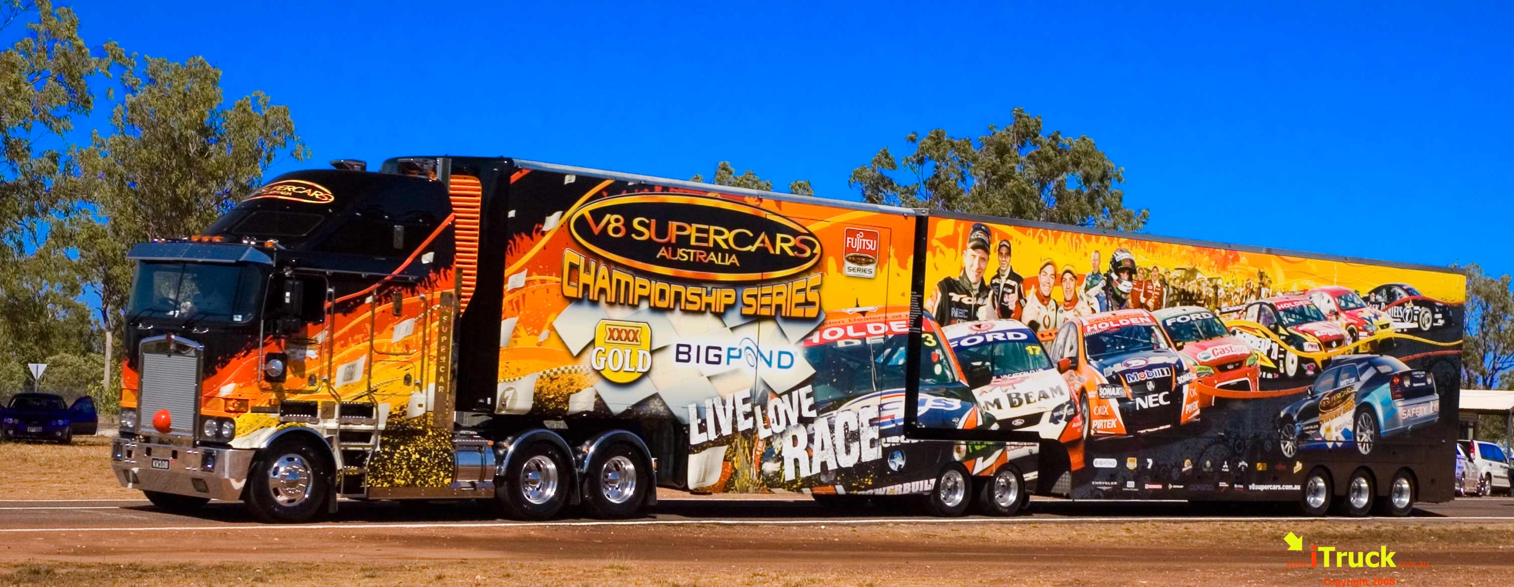

  20. Hello, B Doubles like one pictured? Grant
