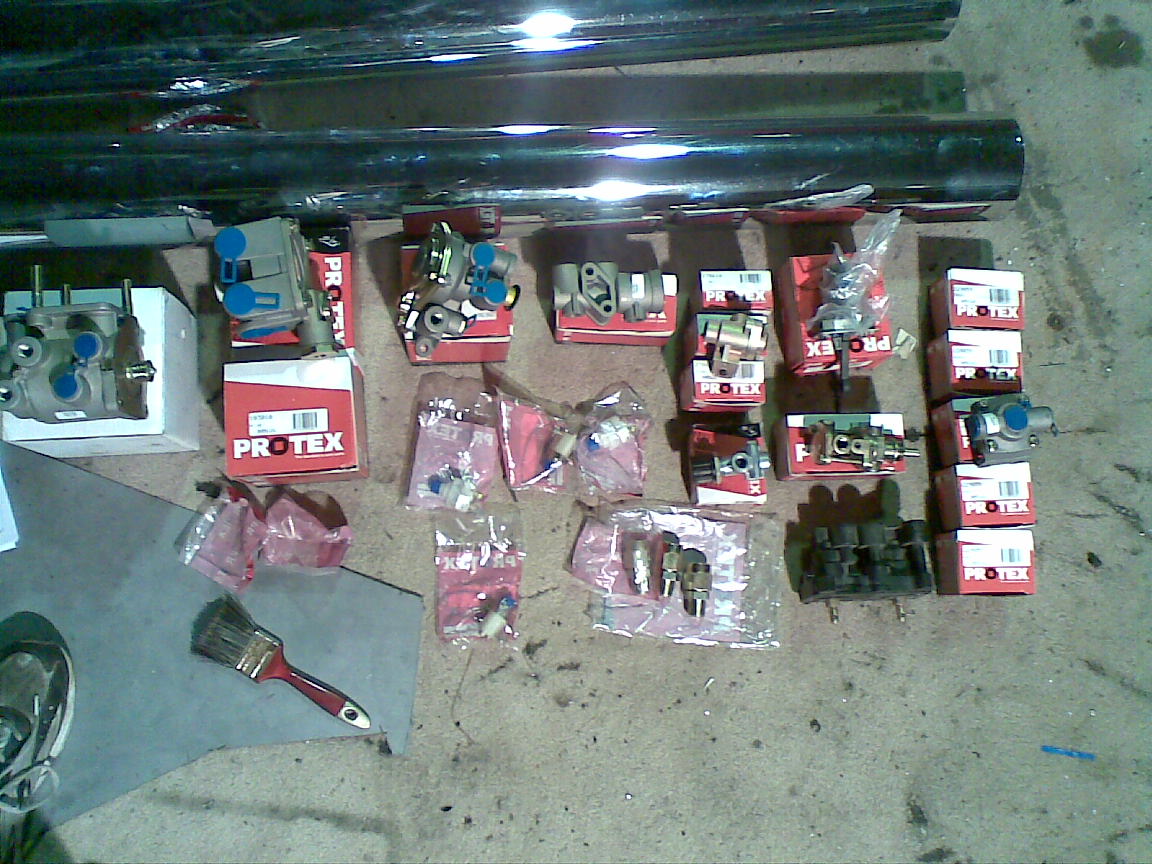

  2. Hi, there is a lot there. where they all go is beyond me at this stage, but will be a full bottle with it when its all on. I had to go all new, safety first, the thing has been sitting for 15years at least, so putting new stuff on is better, it has all new boosters aswell so if the thing doesnt stop I can ask why! safety first! all steering bits are new to, the motor,gearbox and diffs are not new, but they wont hurt any one if they fail. plumbing is going to be a challenge Grant
  3. Hi, there is alot of valves on these trucks to make them stop, i just bought 1300.00 dollars worth, 15 valves in total, what the heck do they all do? Grant

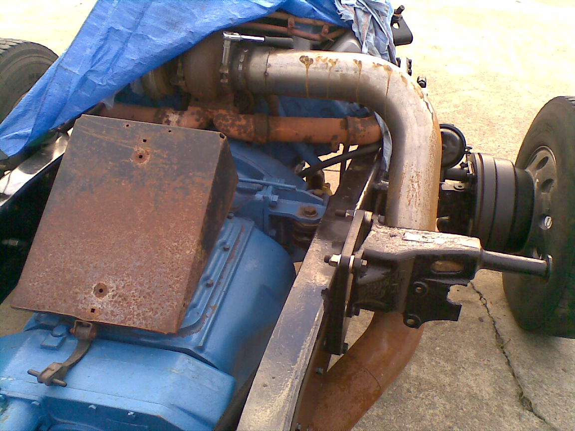

  12. Hello, no worries, thank you, so it runs direct off crank shaft then? its getting there. I cut the cab brace off to, will make again with exhaust there, have sorted the exhaust out now. the bolts at back of cab, I take it there to mount the exhaust? there is 2 1/2 bolts on either side about 3/4 up the cab. I am running twin 5inch straight through stacks, 5 inch off engine and then into twin 5s. Grant

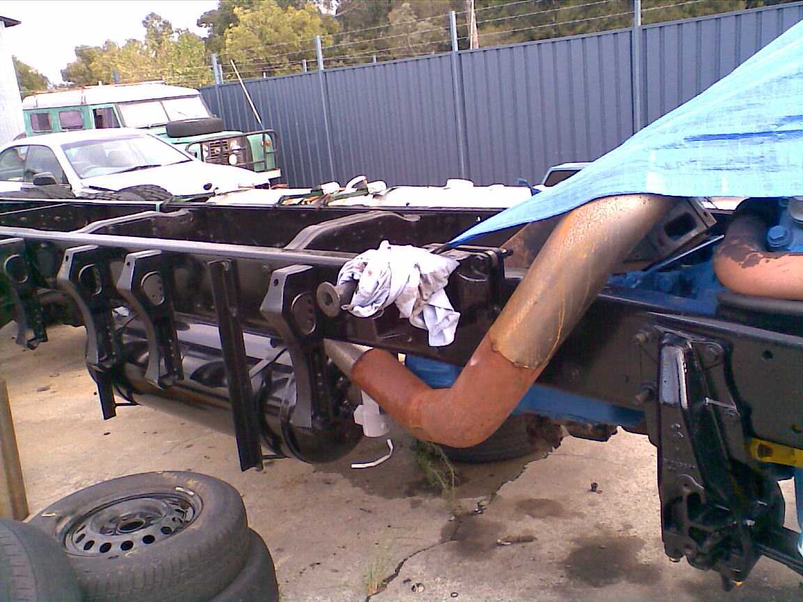

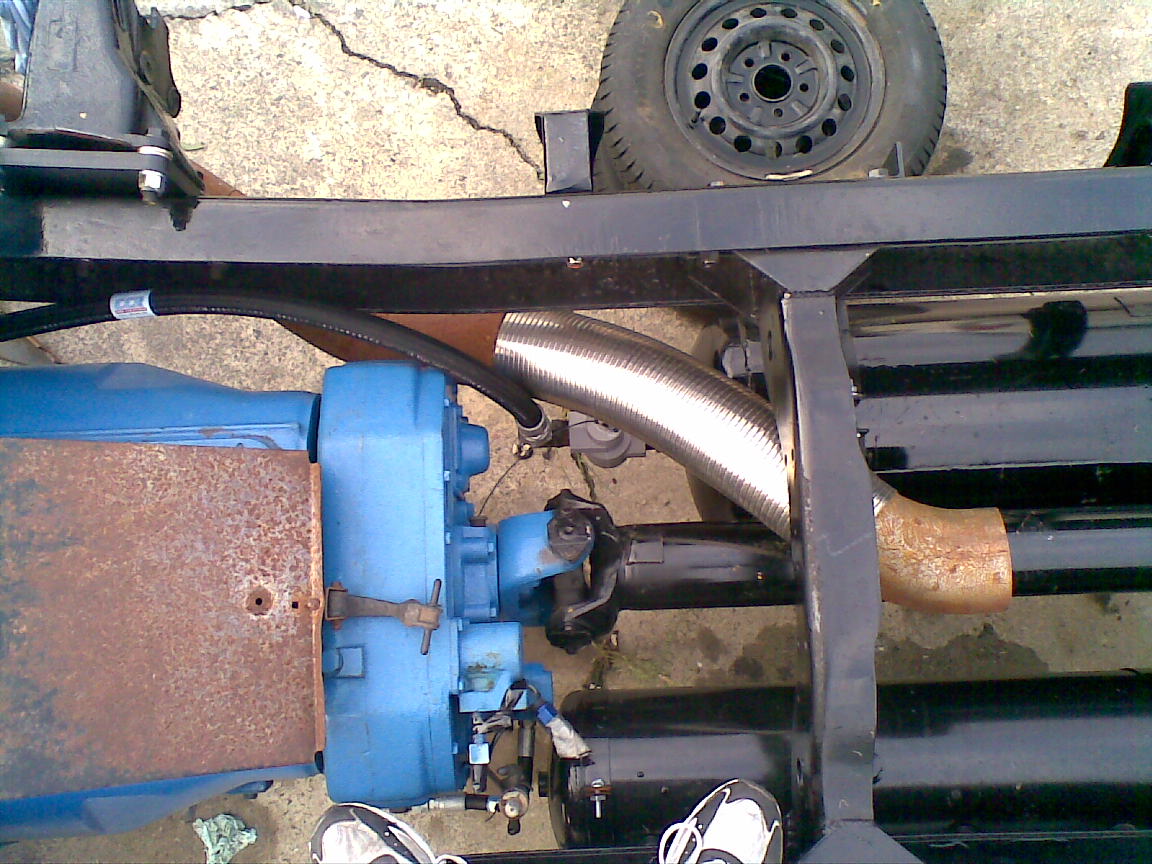

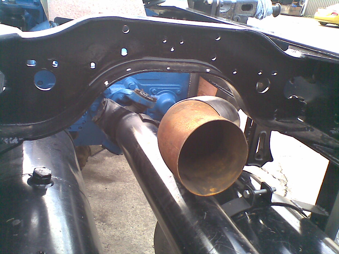

  15. Hi, hands are to full, i have run exhaust out side, then under chassis and back in, how ever that may change yet?? I have little room below chassis cross member and drive shaft to get a bend on the Y section and have it not bang and clunk, I am having another play tomorrow. Grant

  25. Hi, here is where i am up to so far, its 5inch, will pop cab on tomorrow and work out y piece and what room i have between cab and chassis, the air start tank has made things tite. Grant
