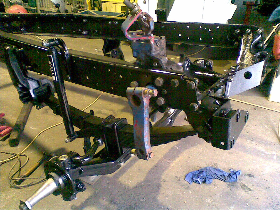

  11. Hi, I just fitted power steering to my 69 R model and found i had to drill one new hole in chassis and re size 2 others for the mounting plate. i fitted a Ross box HFB70 and it has changed the turns from 20 turns lock to lock down to 6 turns lock to lock. Grant

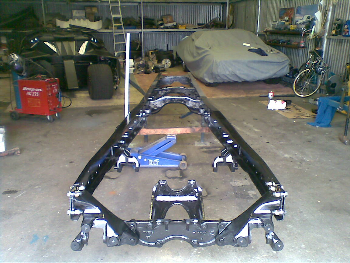

  12. Hi, welcome, atleast your not in an aerodyne! i am starting to put my 69 R model back together now. a few changes tho. regards Grant

  14. here is another pic, just trial fitted the new power steering box. now just have to get the drag link made up. Grant

  16. Hello, how you going? hope all is well over there. am just looking really, but interested in front suspension/steering area i am building one truck out of parts from 4 here, so i have parts scattered all over the place. have used all front suspension and axle out of the F model, steering box out of a valueliner, an just worked out they have a stepped back front axle, so have to make a new shorter drag link. i am still debateing wether to fit engine with mounts on block or try and source a notal mount for the 20 speed? not really sure on that one? Grant
