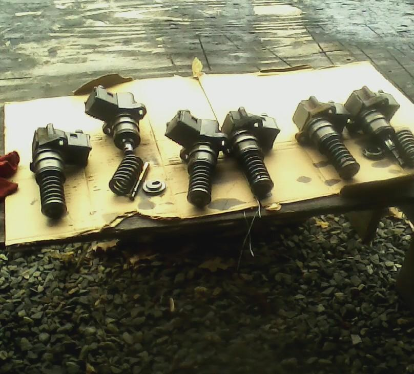

  23. my unit pumps pics I am thinking this was my vibration .
  24. I took all 6 unit pumps out today and 2 of them fell apart as they were coming out. I will be sending them out to get tested.
