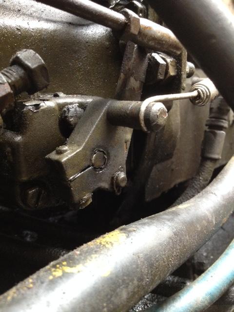

  1. Ok, dodged a bullet. In case this symptom happens to anyone else. basically the splined shaft coming out of the IP was skipping. The lever was just loose enough that when you gave the truck more than half throttle it would skip a spline then would idle high because the lever was hitting the forward adj. if I "snapped" the pedal hard the splined shaft would actually skip back. I clocked it and tightened it.. Problem solved.

  6. Have an ENDT 673 and today it started not idling. It idles fine until I drive it down the road then it won't return to idle. It gets stuck between 8-1000 rpms. If i snap the Pedal(fuel) a couple times it will idle normal again around 550 rpms. If I drive easy and don't give it more than half throttle it won't do it. Could this be the governor coming apart? I check all the linkage and there is no binding and I have pulled over when the truck is idling high and the throttle lever on the Inj pump is against the stop. f i try to lift up on the fuel pedal, nothing changes. The only way to get it to idle normal is snap the pedal a few times or shut the truck off and re start it.
