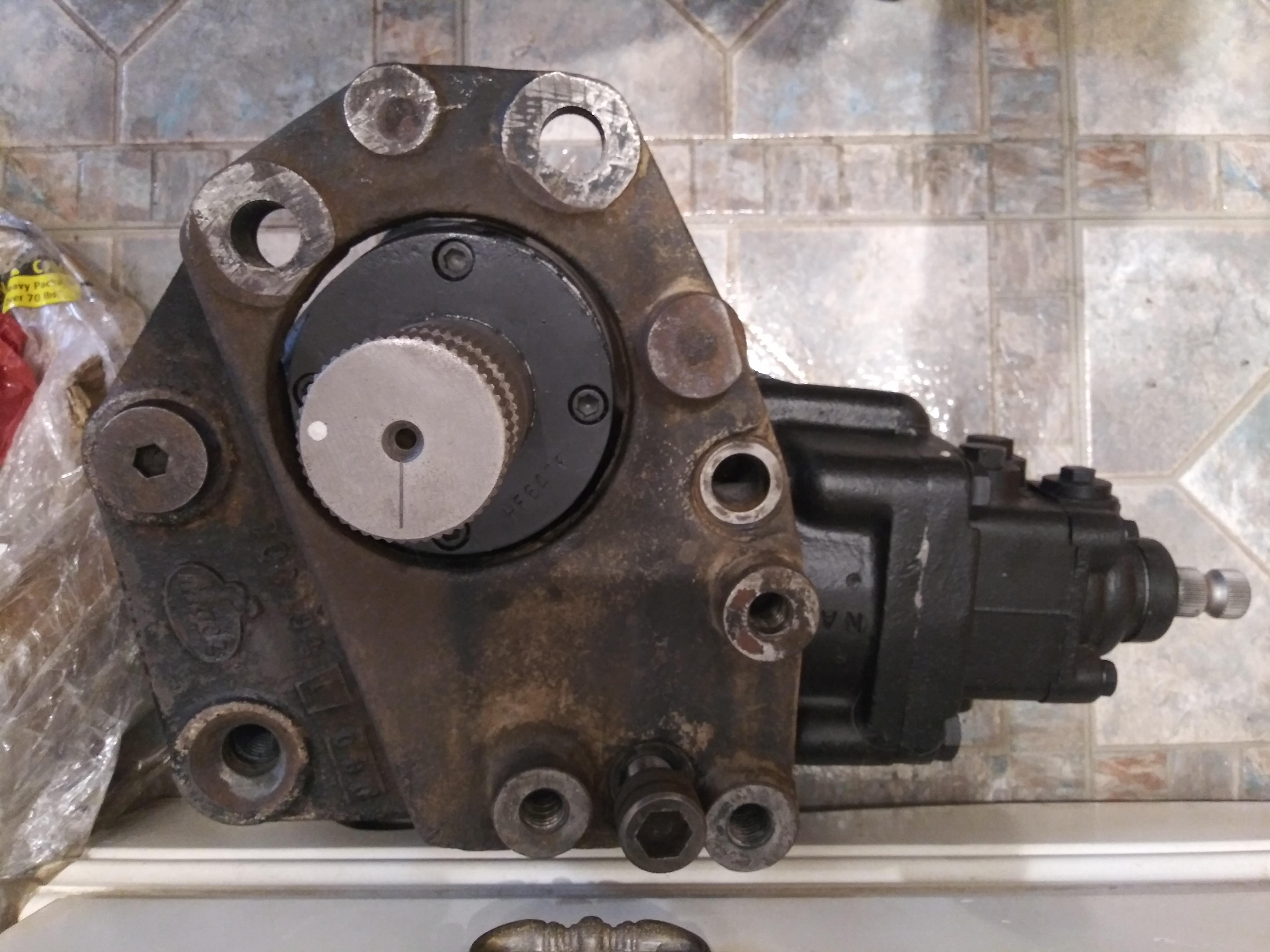

Good day everyone. I'm installing my new steering box in my R model tomorrow. It's a 1971 R795. It's a Ross integral power steering box. My question concerns the steering stops. The stops appear to be turned all the way in. Do the stops need to be adjusted at all before I do the poppet valve adjustment or just leave them be?? Before I had the box rebuild I had plenty of clearance between the frame and other components nothing rubbed or was even close to the tires. My TS442 manual states 1/8 gap between the stops before the power assist cuts out. The installation instructions state this also. Do I get that 1/8 inch from the poppet adjustment or do I first adjust the stops themselves then the poppet adjusters? Any help would be appreciated. Thanks and have a great day. Tom VB.

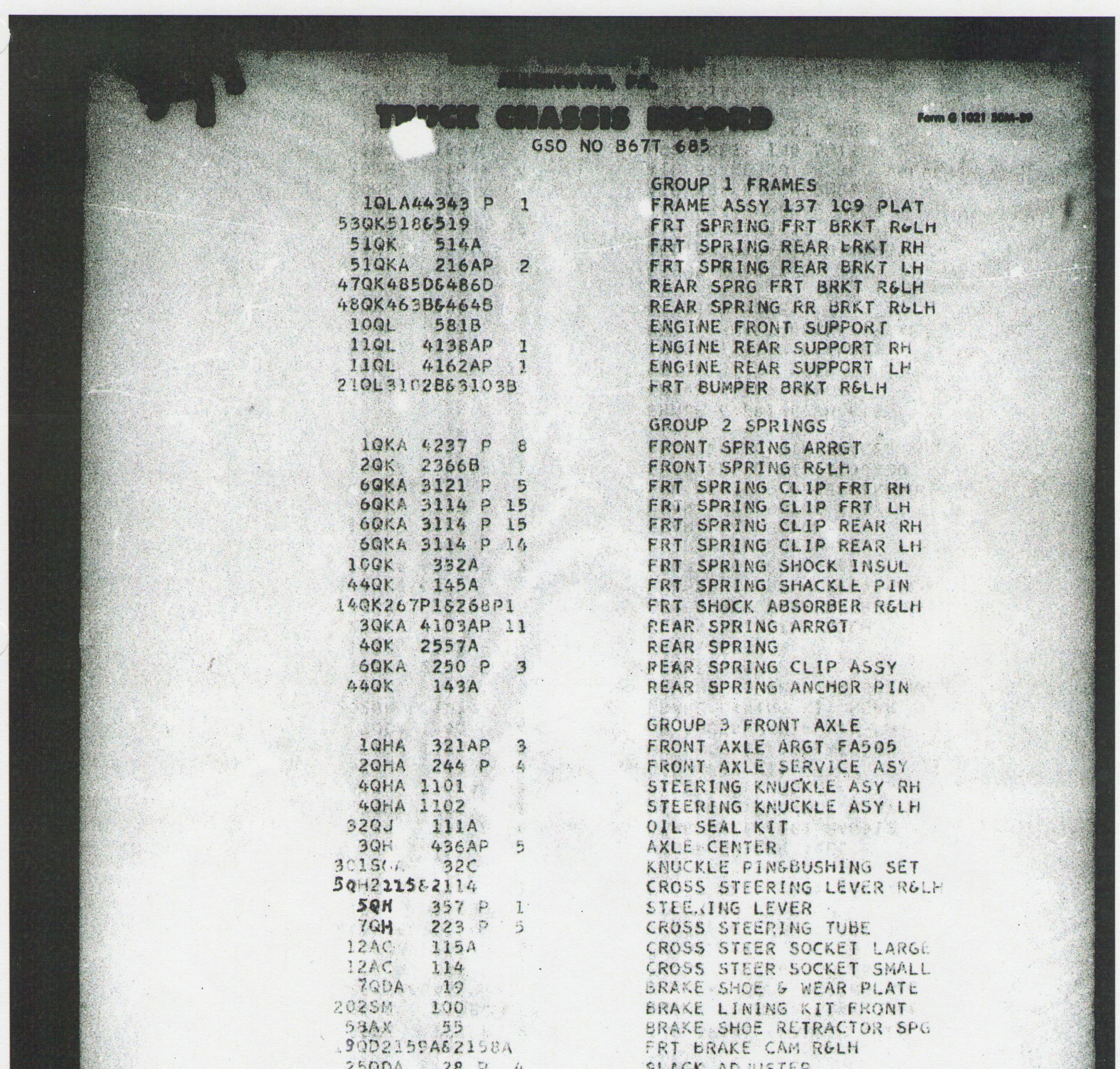

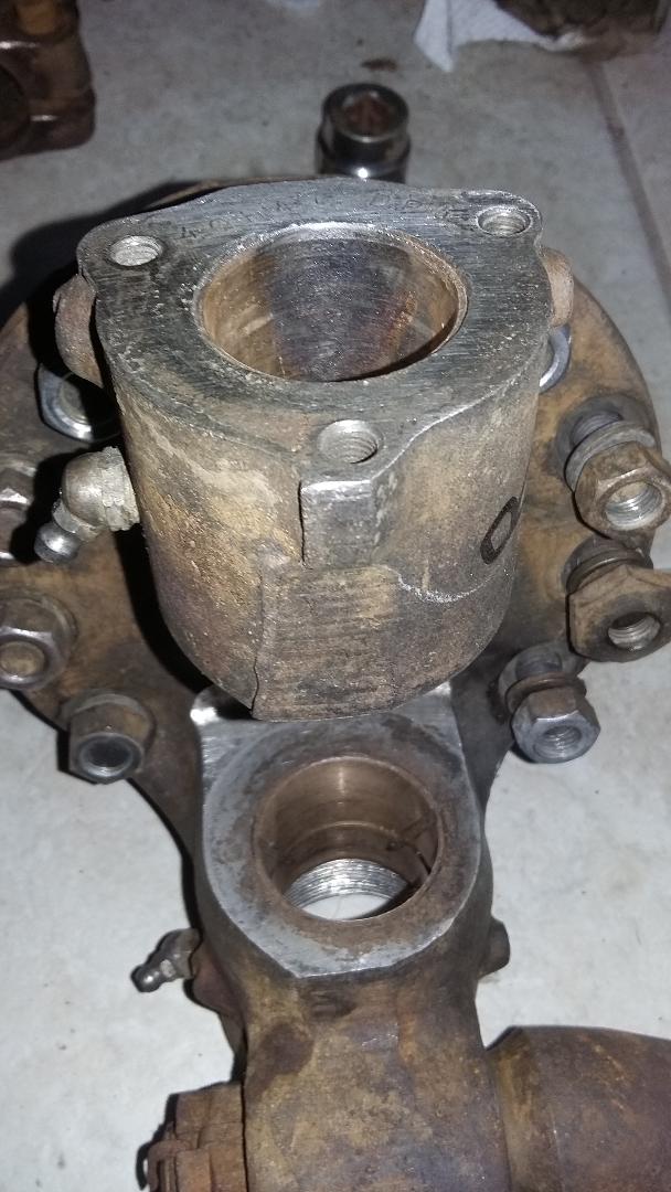

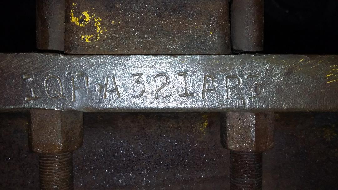

hello, where can i find the part numbers for the steering knuckles on a 1962 b67 with a 505 axle. i removed the 3 screws and popped off the kingpin cap on top of the knuckles. the number i found does not come up on my build sheet nor does mack have it in their database. looking for some suggestions. thanks.

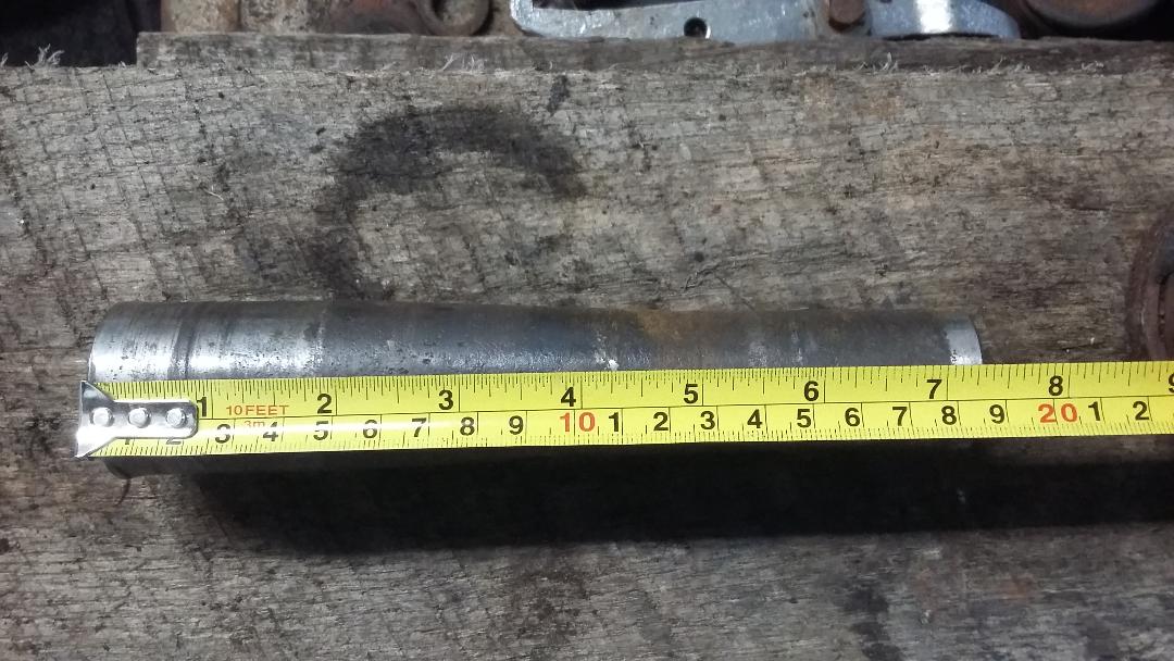

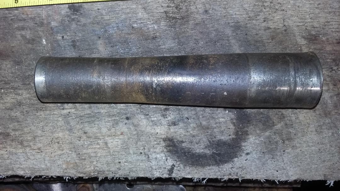

hello everyone, i know this discussion has taken place many times before. i have read most of the previous posts. i am trying to get the proper kingpins for my 62 b 67 with the fa505 axle. i called transedge mack in allentown and gave them the 1qha # and they came back with 301sq32c. now that number is what's on my build sheet from mack. however 32c reverts back to the 301sq32b and that's no longer services from mack. that's all well and fine, now i go to the aftermarket. most of us know the aftermarket pins are coming up short at 6.69 inches and use the fancy roller bushings. my pins are coming in at 7 5/16 or 7.31 inches. now the moog [#8592b] kit says it fits or replaces the mack numbers:::: 301sq32b , 301sq45a and 301sw45a however they are just like all other aftermarket kits with the seals and short pins. i took a look at my ts 442 manual dated 10/67 i got from mack and in section 9 page 11 it shows type 1, 2 ,3 and 4 steering knuckles. the type 3 knuckle [the one i have] changed at some point in time. the first diagram [figure 9-9] shows the knuckle i have with standard bushings and no seals. the next diagram [9-10] clearly shows the newer type knuckle with the roller bushings and seals. what year was this knuckle first used?? has anyone attempted to use the aftermarket pin kits?? i'm assuming that it can't be done since the pins are to short?? if anyone has i'd like to know how it worked out. where might i be able to get the correct pins from other then a machine shop? my last question is where is the stamped part number on the steering knuckles?? the number stamped under the pin cap is not the correct number [4qh 476 dp4] mack ran it for me and it didn't come up. thanks for your help. tom vb.

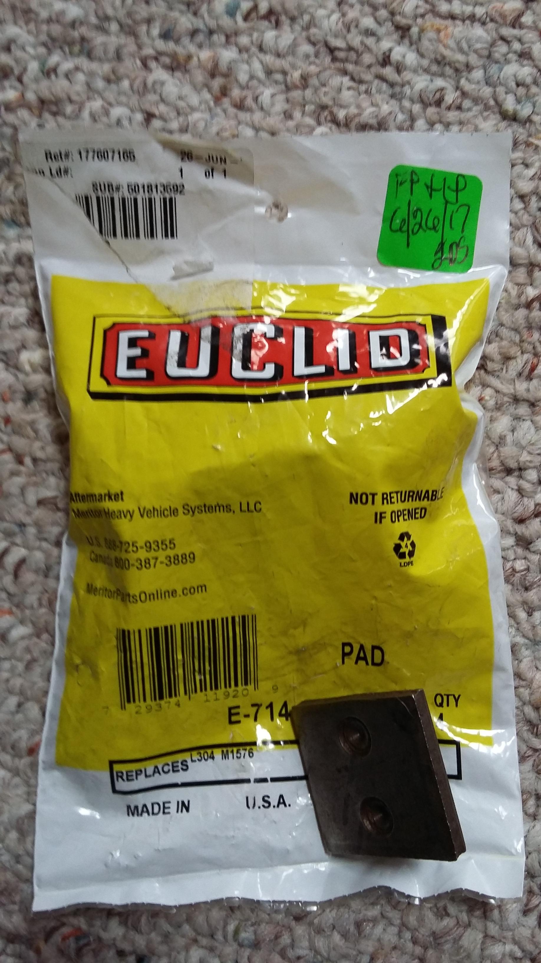

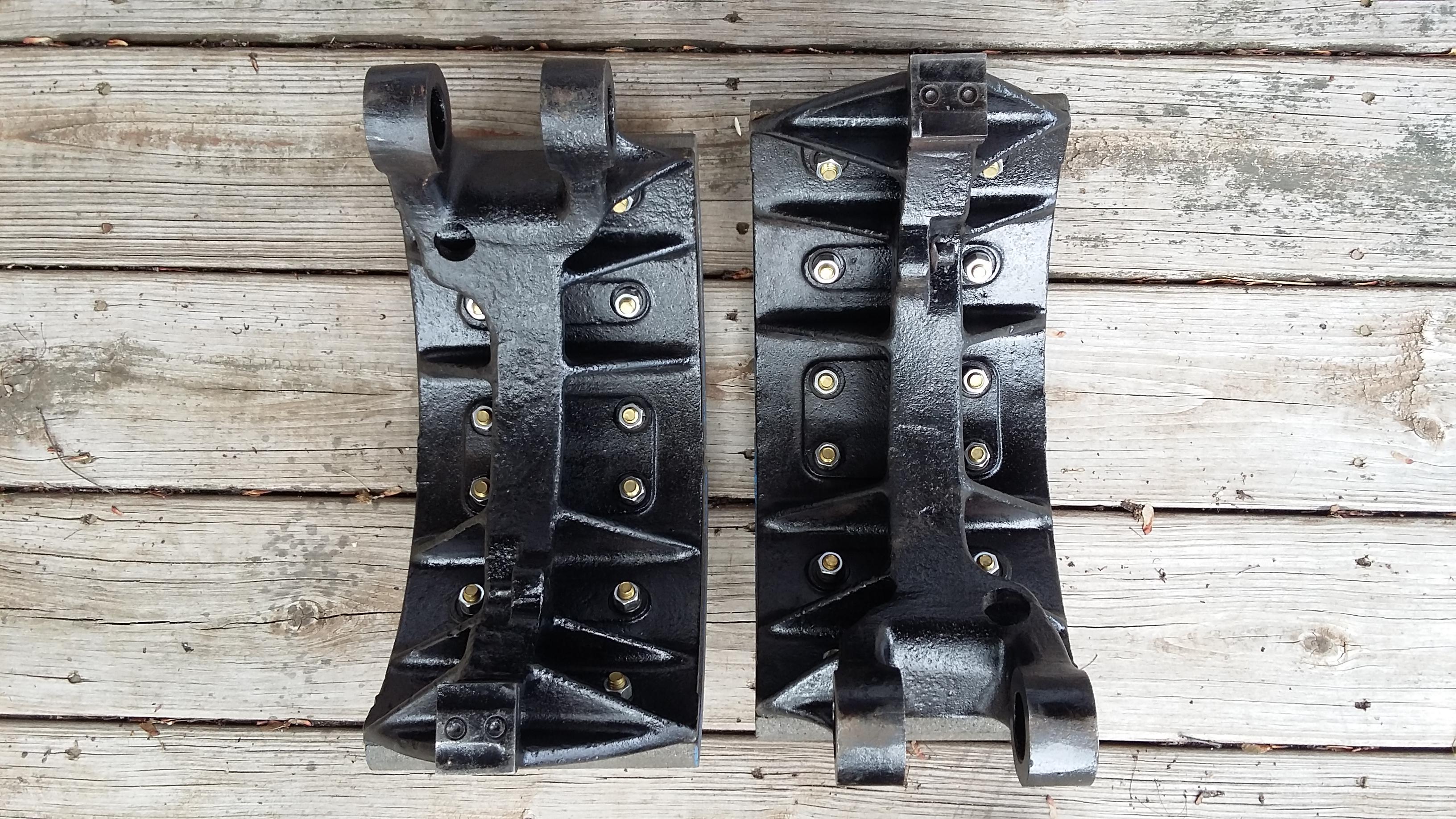

Hello All, Are the wear plates still available for the old pinned style Mack brake shoes [#6QDA 120]? The picture shows the plates are worn out. If the plates are not available can I press out the 2 pins and cut new plates out of standard 1/4 inch flat plate or are they made from heat treated steel?? Thank for the help. Tom Vb.
thank you. i'm going to stay with the old pinned set up. i found a place in new york city today that has new pins, bushings and all of the other hardware i need to rebuild the rear brakes. again thank you.
