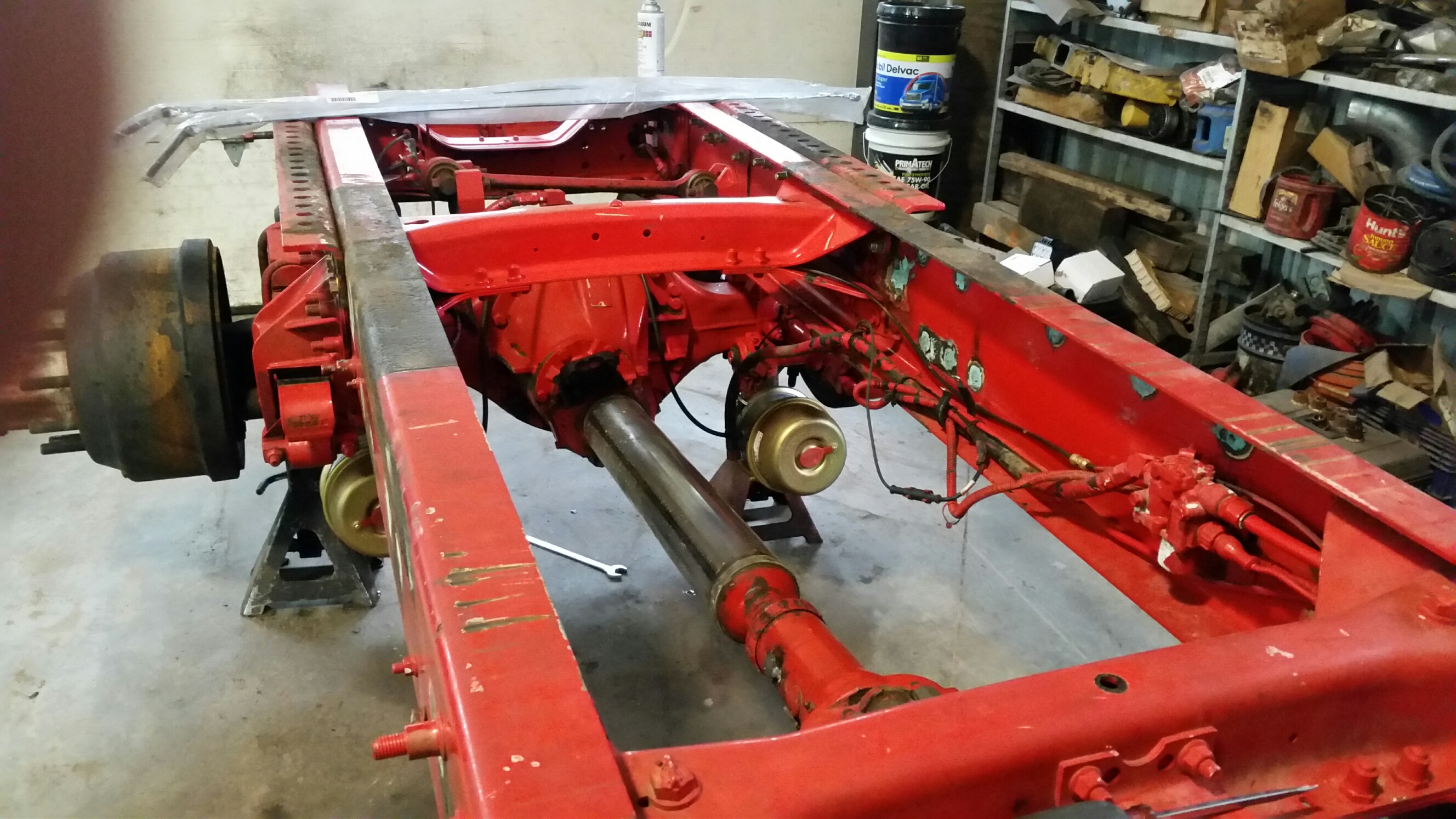

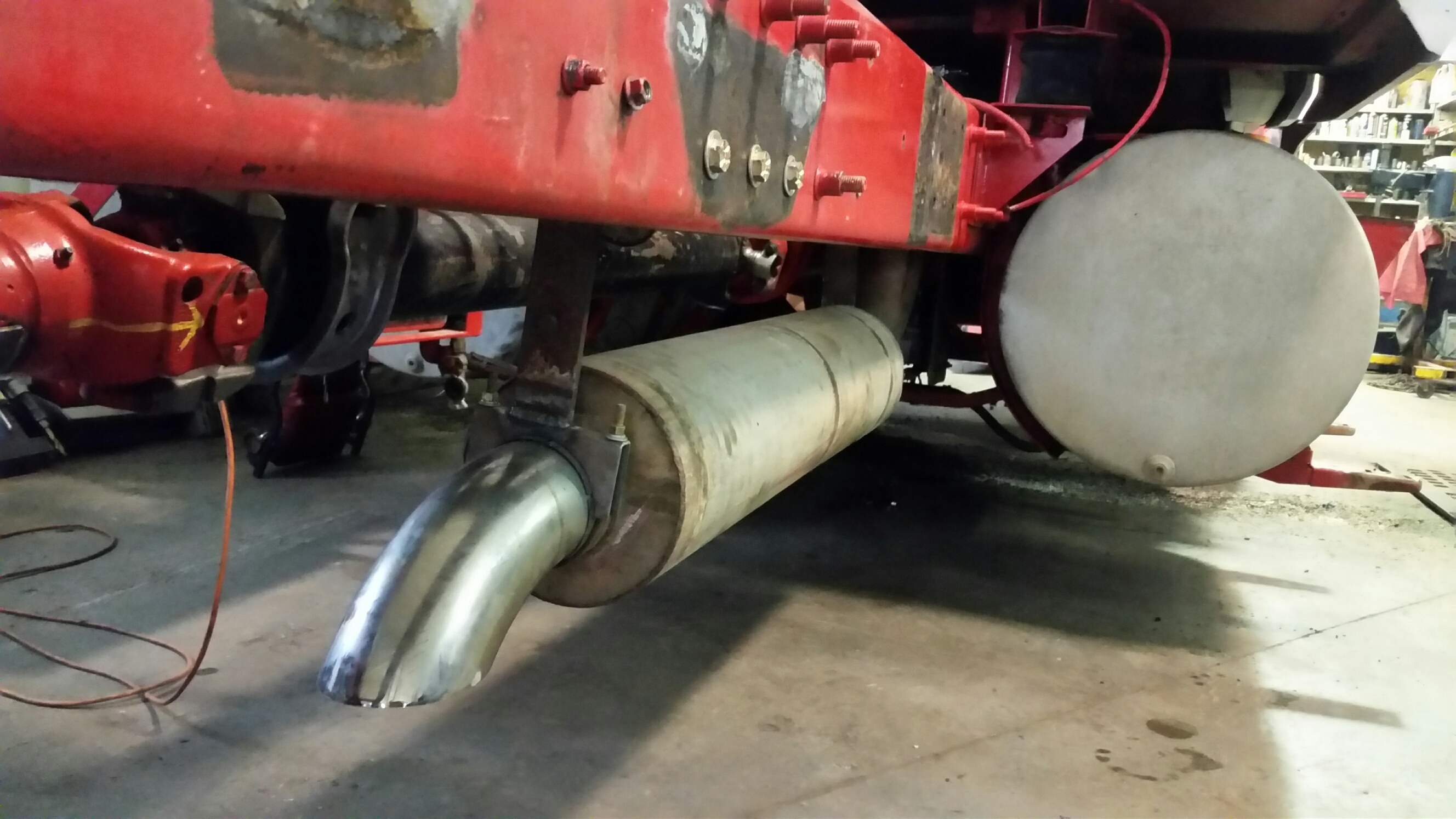

  1. Yes, the extra holes in the frame were welded, as for the method I do not know but will ask the guy who did the welding for me. I couldn't get two pieces of metal to stick together if my life depended on it, I have a few friends who are professional welders that take care of that.

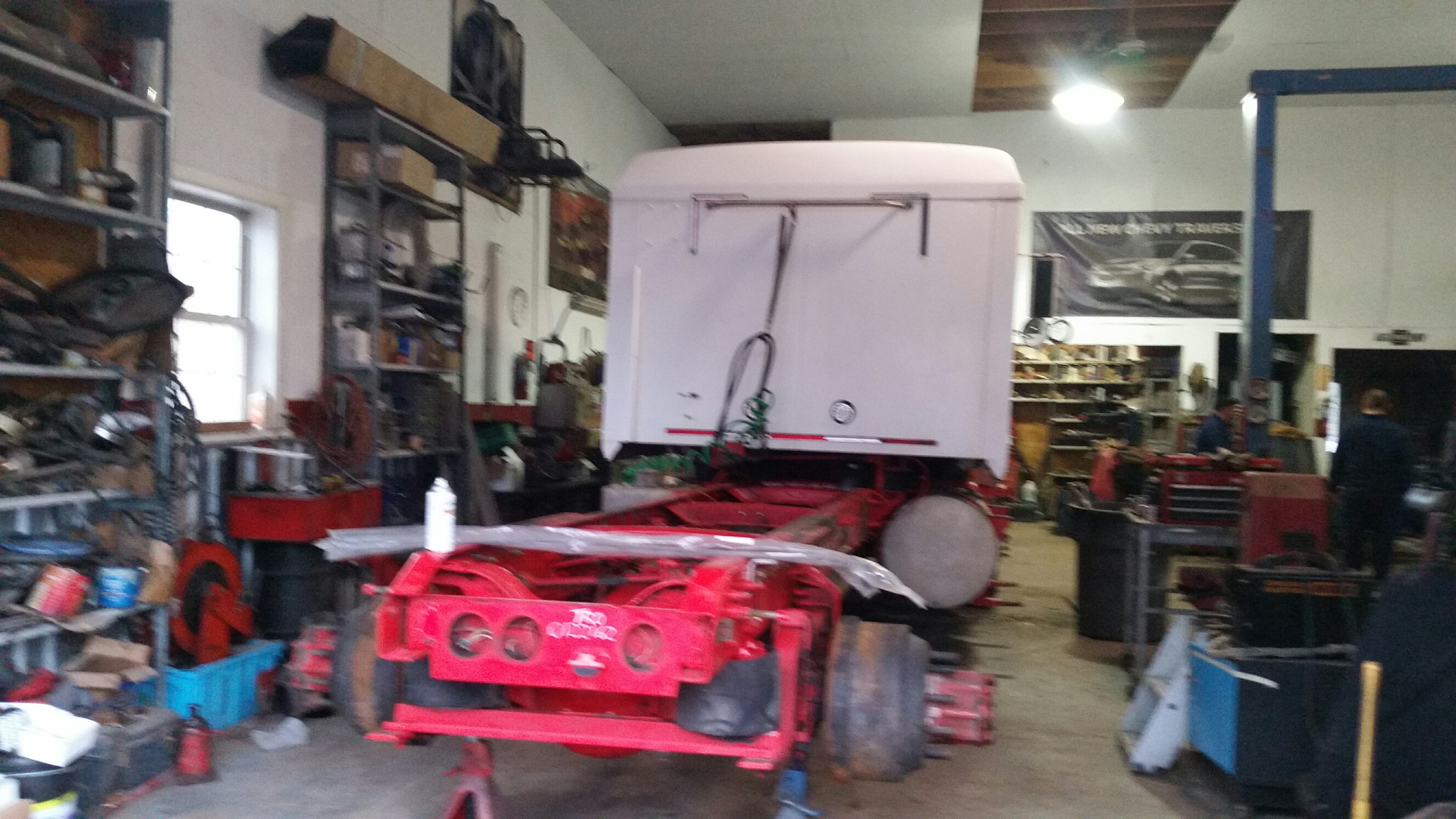

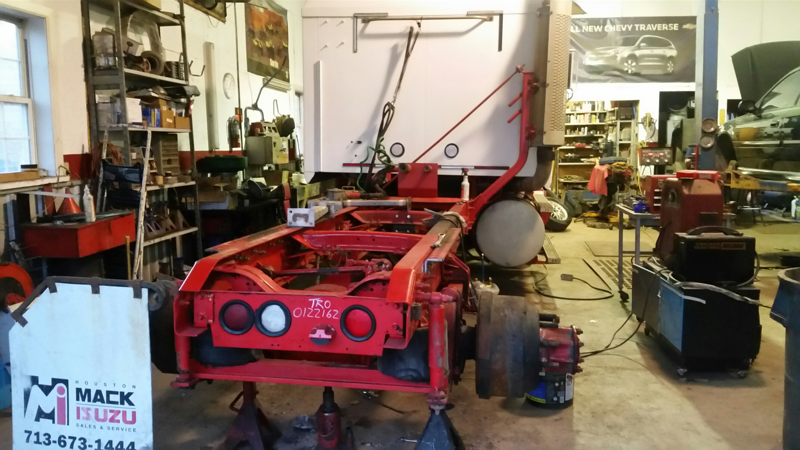

  3. Some more pics of the work as it progressed.

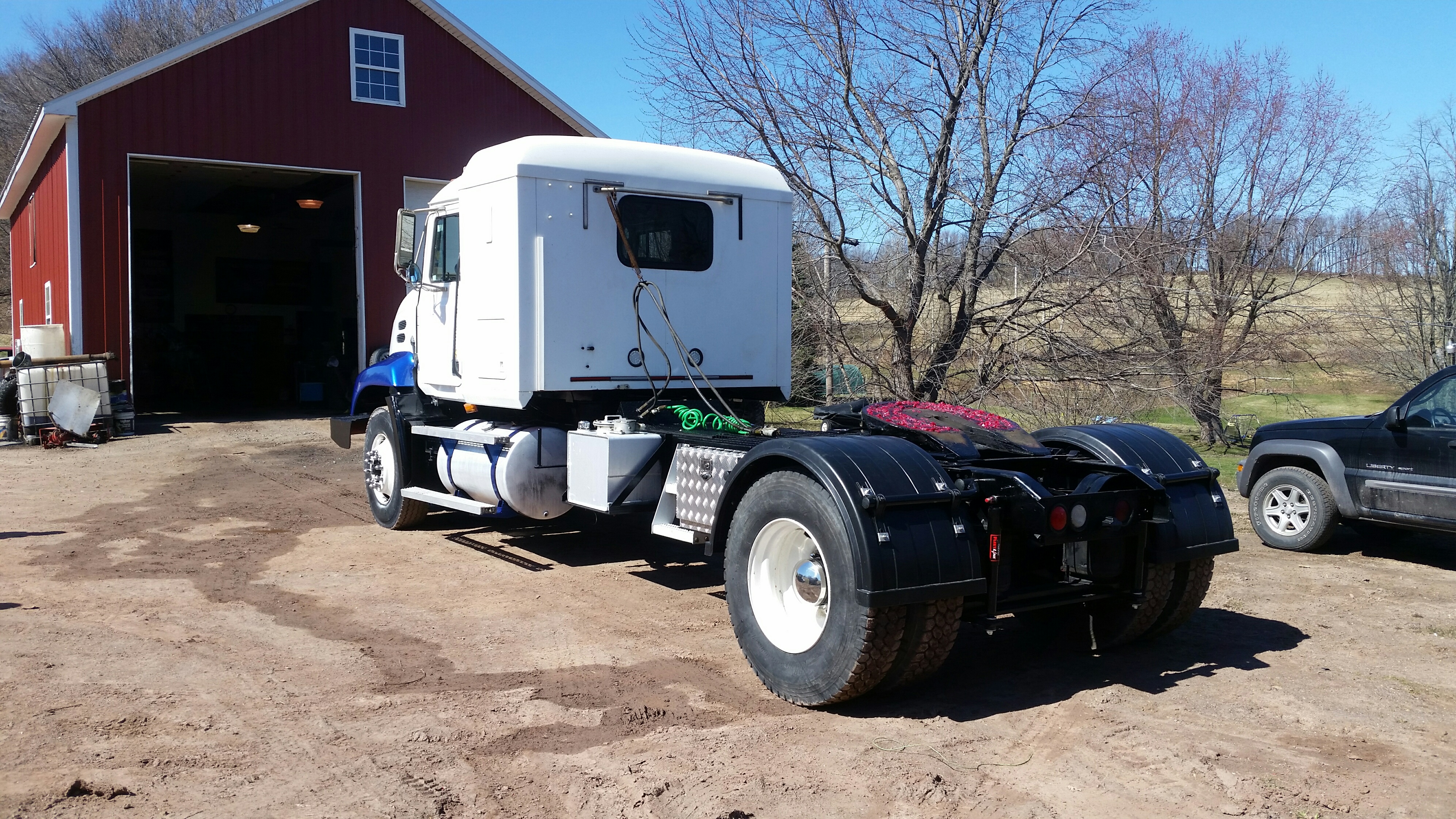

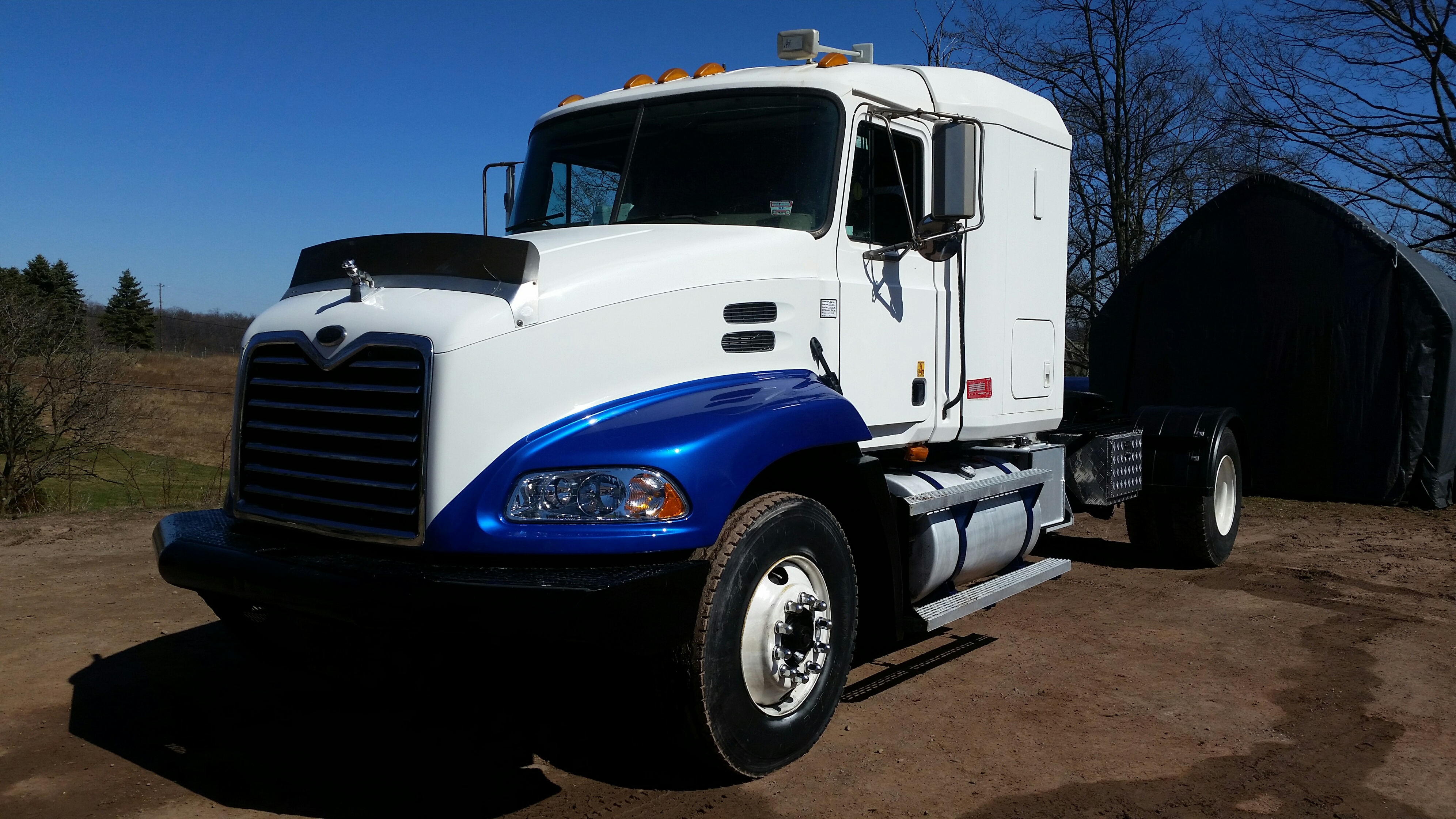

  4. It has been two months since I brought her home, the project is coming along nicely. I had to put her into service sooner than I wanted due to a rust through spot on the frame of my Volvo, so the interior and some little details have not been completed yet. Thought y'all would like to see some shots of the progress. 2000 Mack CX613 Vision E7-427, 13 speed Eaton originally with a Eaton DS-405 tandem rear, now with a Spicer 23,000 locker, 3.70 gears

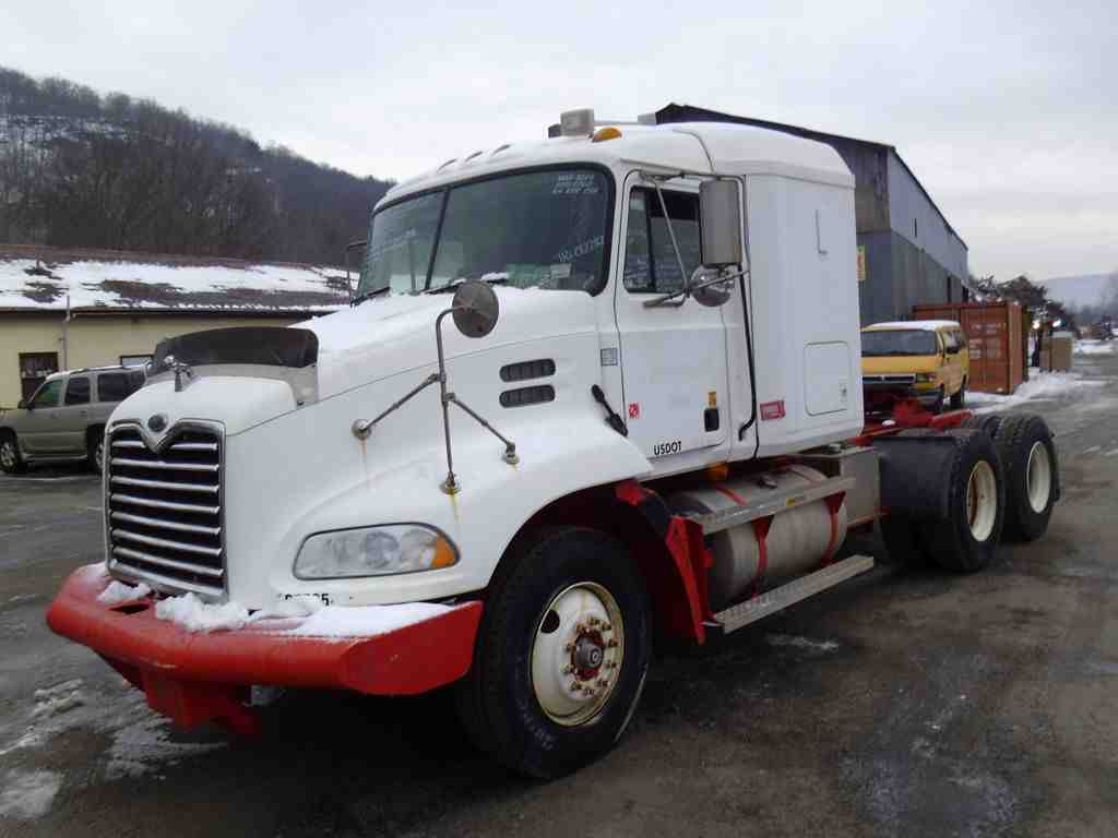

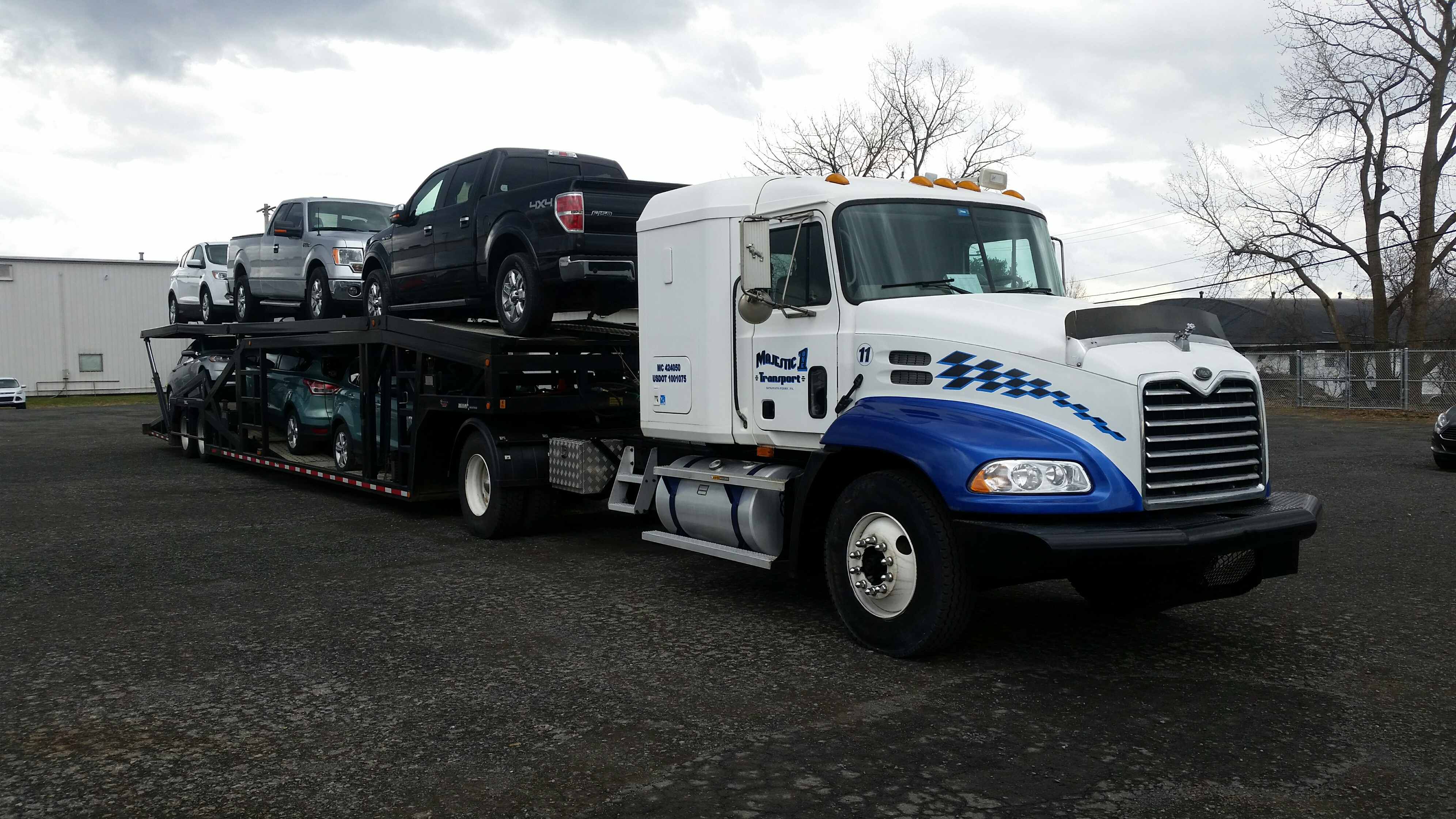

  8. Hi. My name is Brian and I just purchased my first Mack, a 2000 CX613 that I am cutting down to a single axle to pull my car hauler with. I have been a professional driver for 23 years, and have operated many Mack trucks in the past but this is the first I have owned. I have been in the auto transport business for 12 years now, and prior to that I owned a towing company and repair garage, I will try to keep everyone posted on the progress, I just started the tear down of the truck today. Thank you for the great resource. I have attached a pic of the truck I am building right now, and a Mack wrecker that I operate from time to time. I hope you enjoy.
