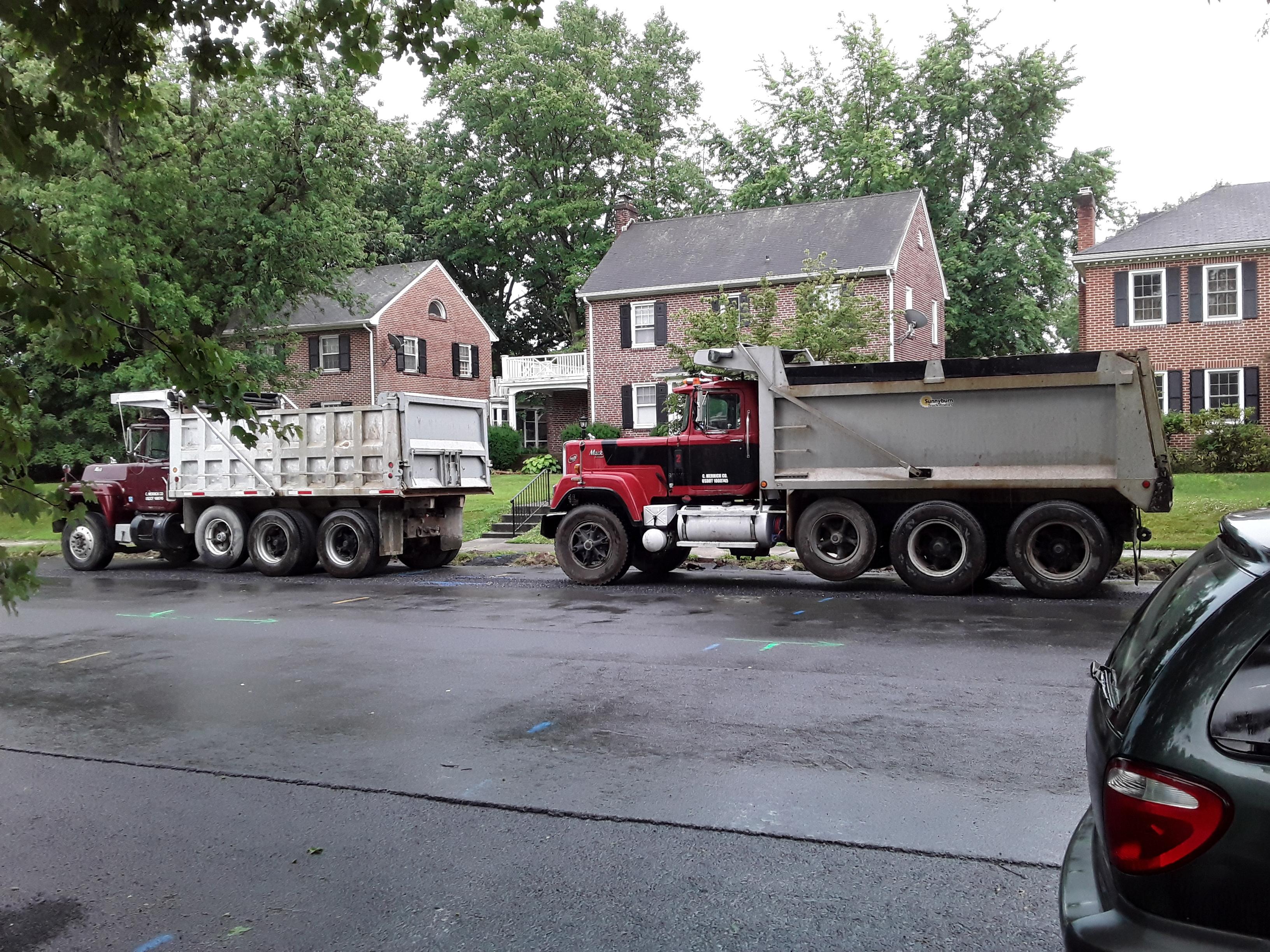

  12. Interesting how we all like different things. i much prefer the pre-facelift hood. I do wish the 87 RD had the air-ride cab that the green one has though. Not exactly sure why but The superliner rides like a cadillac compared to the other two.
  13. You know whats funny so do i. What a dummy. well i'll change my answer rd-690 is a maxidyne made after 1987. seriously i have an 87 rd686 and the remnants of a 88 rd690 only big difference is 88 has a em6-300L and t2060 and the 87 has em6-300 and a TRXL107
