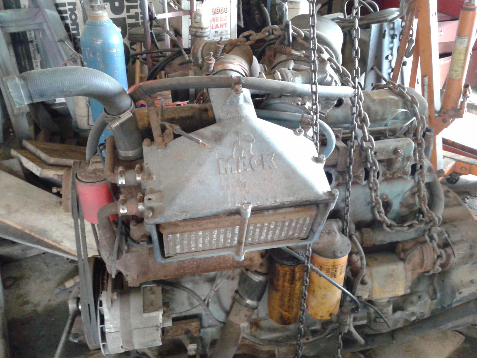

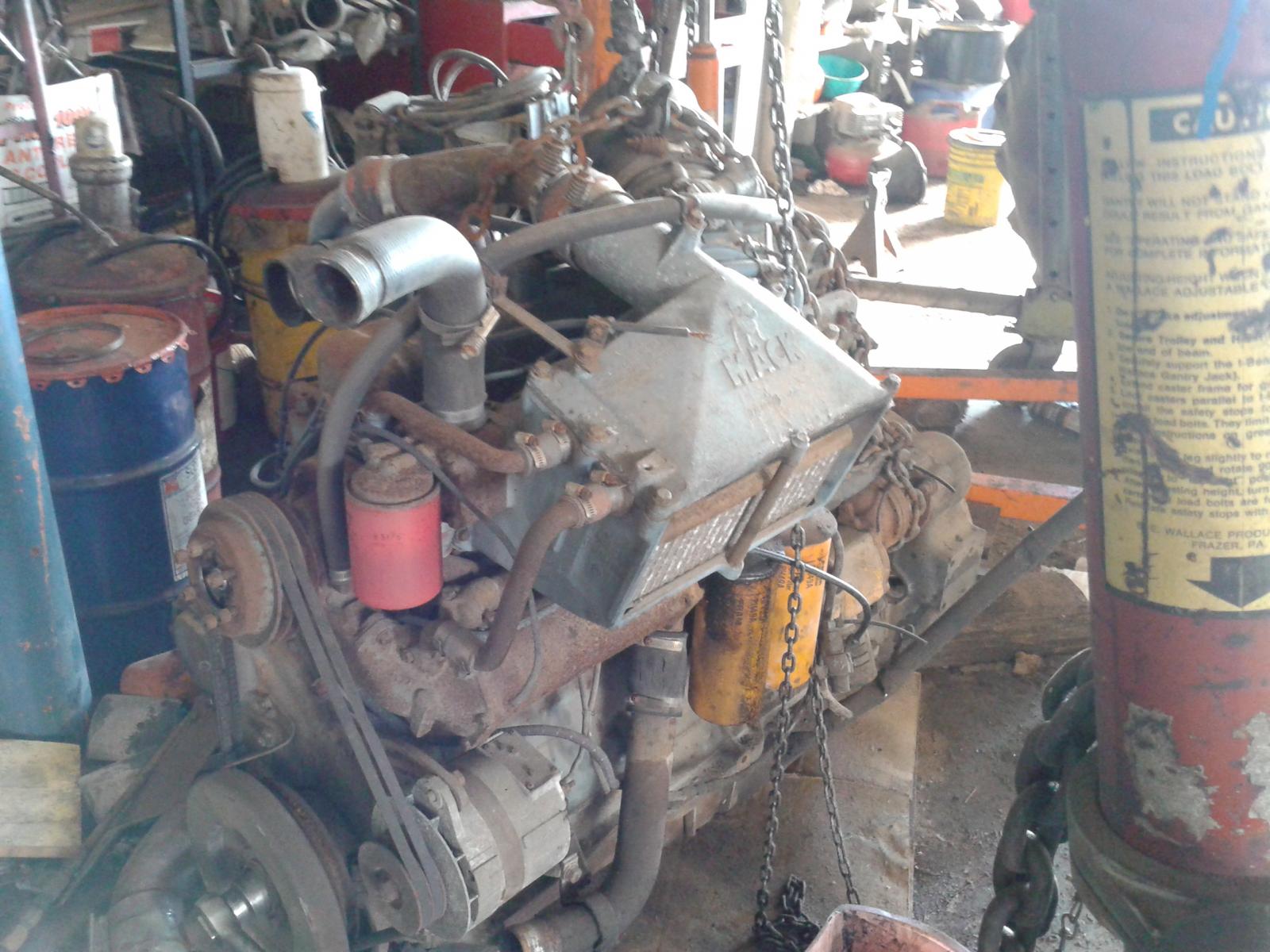

  12. I don't know that much about tip turbine. i thought they all were had water cooling. Anyway the one i has two small water pipes going into the front of it. s One thing i have been wondering about is the turbo. will the one from the e6-350 work with the tip turbine.

  14. I have a 2ve6-350 that was air to air and i want to change it to tip turbine so it will fit in my b61. i also have a complete 285 that i can get parts from. What were the differences between tip turbine 350s ( endt678?) and front mounted air to air e6-350s. I was going to just put the 285 in the truck but i would much rather have the econdyne than maxidyne.

  18. I picked up a used engine this weekend part of the intake manifold was broken from improper lifting. I have never seen mack with lifting eyes like other manufactureers. So are the best lifting points? I know its not the water pump (Have seen more than one ripped right off). I would make some brackets but where to bolt them?
