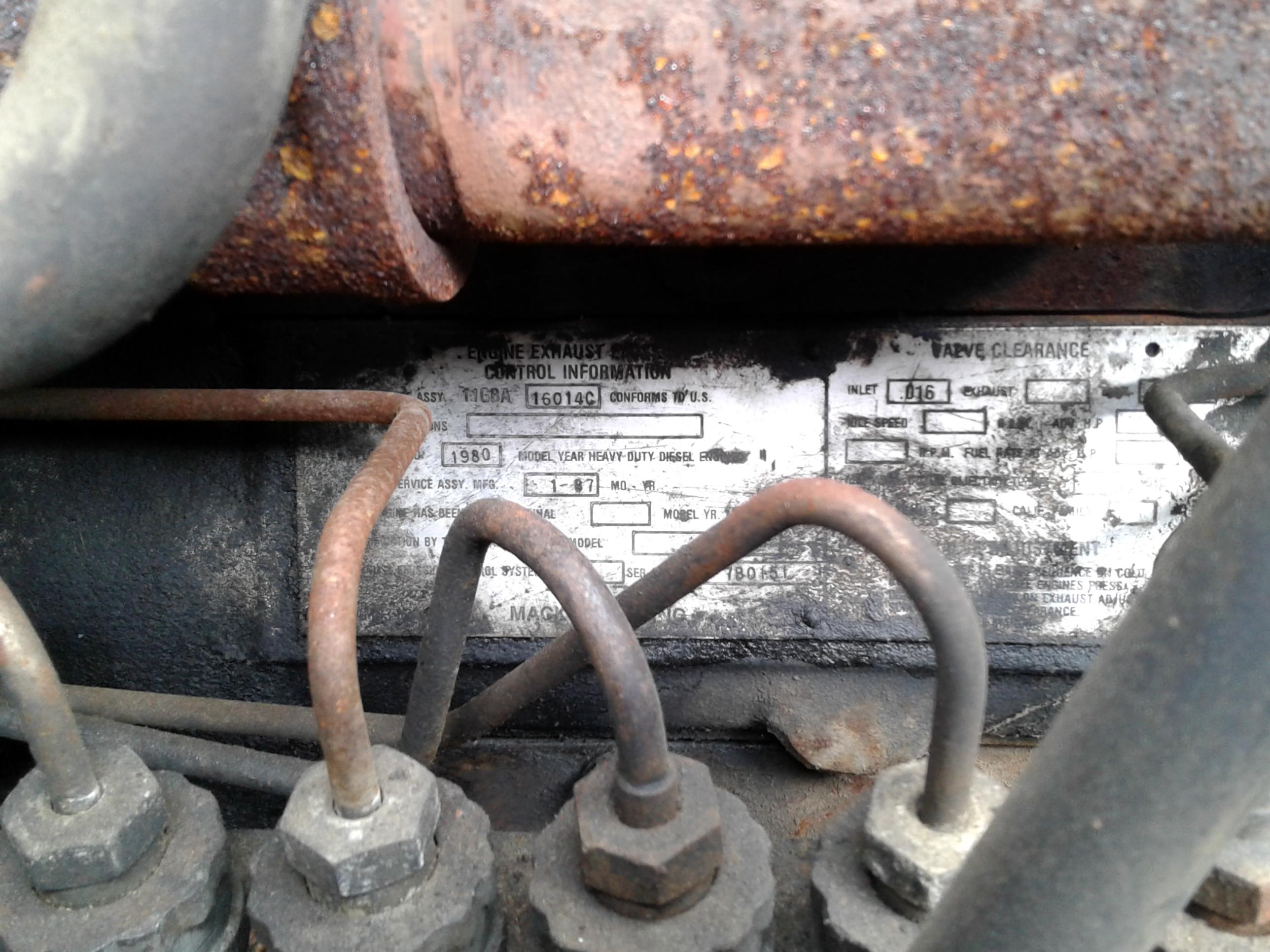

  8. Plugged the air line feeding the relay valve and she runs much better. Now i need to determine if the relay is messed up or the puff limiter is shimmed wrong. Didn't have that much time today.

  11. Today verified correct injection pump and a p8 relay valve. Next i think will plug air line to relay valve and see what difference that makes. If it makes a difference then i will check the shimming of the puff limiter.

  14. I"ve bought a 1987 Rd with an em6-300 Back around the first of the year. It doesn't pull down low like it should. it has OK power if you can keep it above 1700 rpm. But that ain't easy to do with a 6 spd. Before i dig into it i want to verify that it has the correct injection pump on it. It has a 313GC5163p2. I don't (yet) have a tune-up specs book for engines that new. So i was hoping someone here might have that info for me. Thanks
