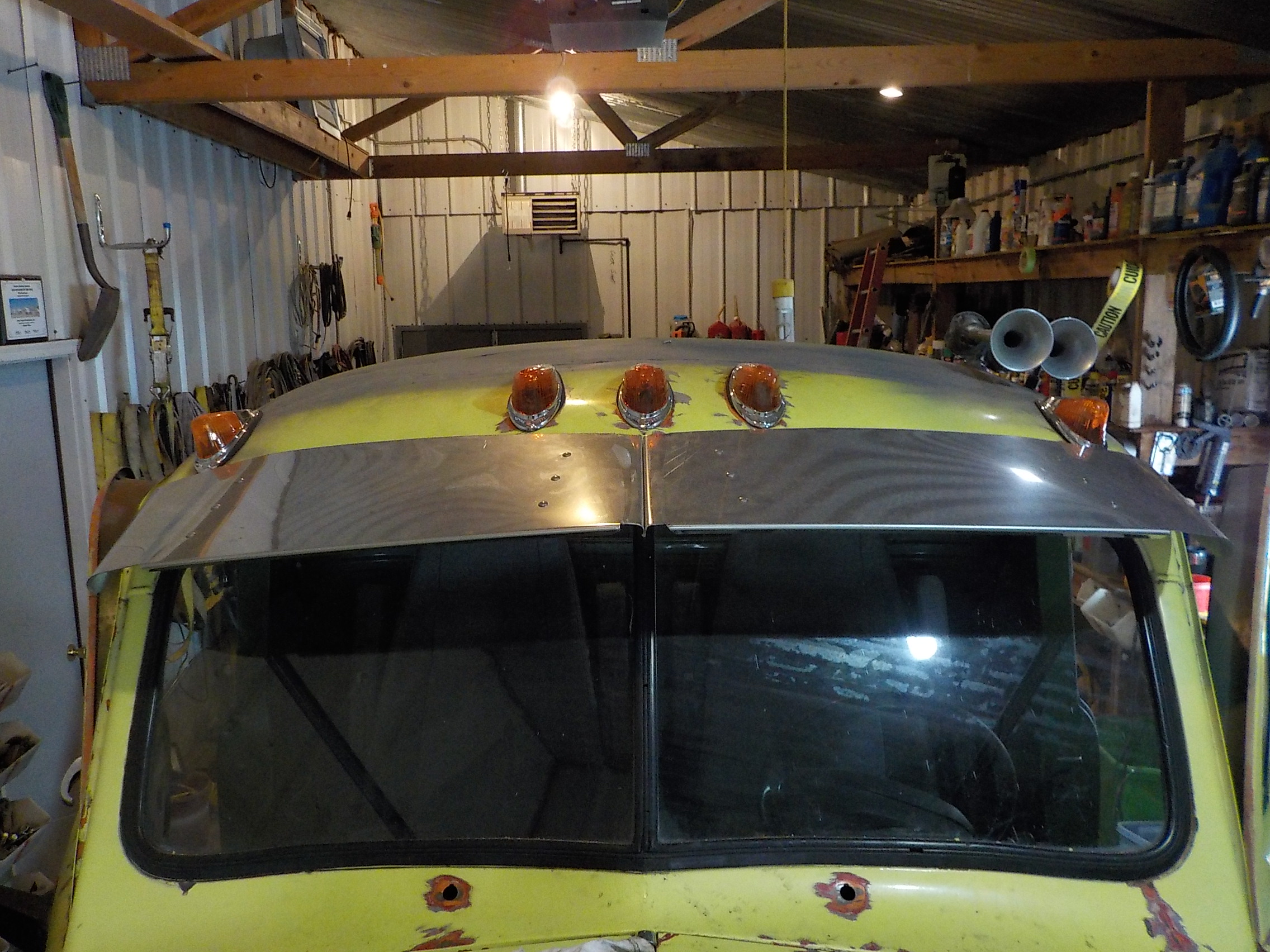

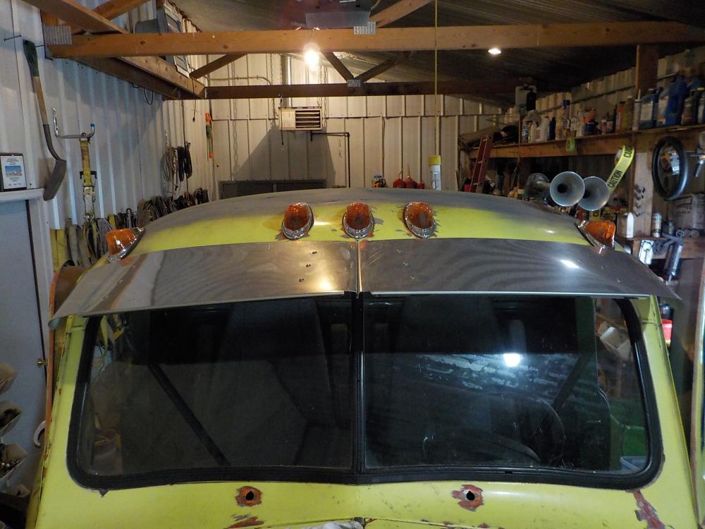

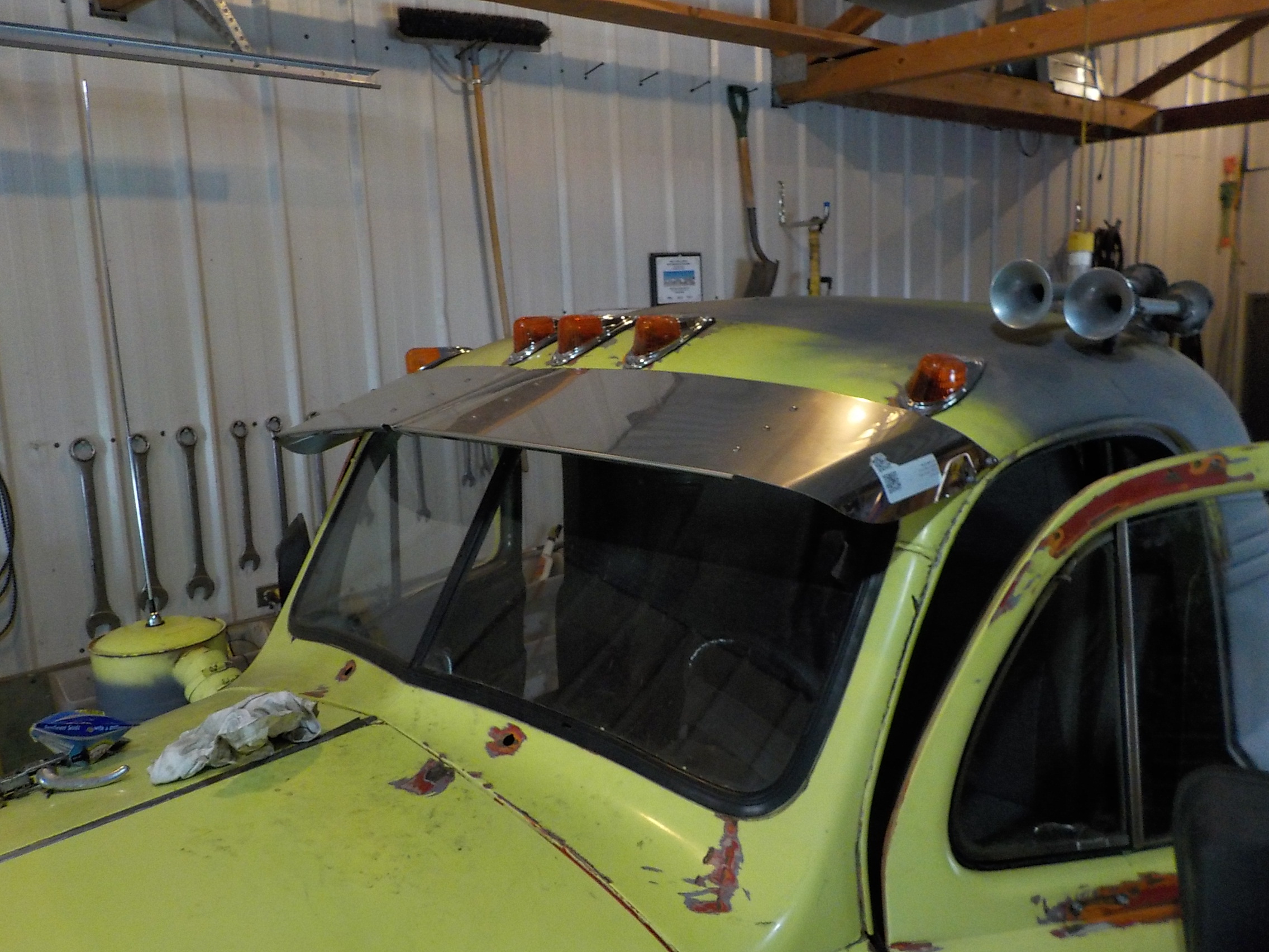

  2. Finally got around to taking a picture of the visor I made for my 58 B model out of a Peterbilt one.
  3. Just FYI. I went to the truck salvage yard and got a S.S. viser of a wrecked Peterbuilt for $100 that was in like new condition. It was to wide and the angle in the center was wrong. I mounted one side on my 58 B model where it fit best. The mounts had the correct angle and mounted with the bottom edge at the top edge of the windshield rubber. I then pulled a string from my bulldog over the viser to the center of the clearence light because it was to long and had the wrong angle and marked it according to the where the string lied, I cut the viser 3/4" long and bent it down like the original bend where i had marked it. I re-drilled the holes and did the same with the passenger side. I bolted it back together in the center and remounted it I then trimmed the outside to match the rain gutter and bolted it to the cab. It turned out great. My wife thought it was a brand new one I had ordered.
