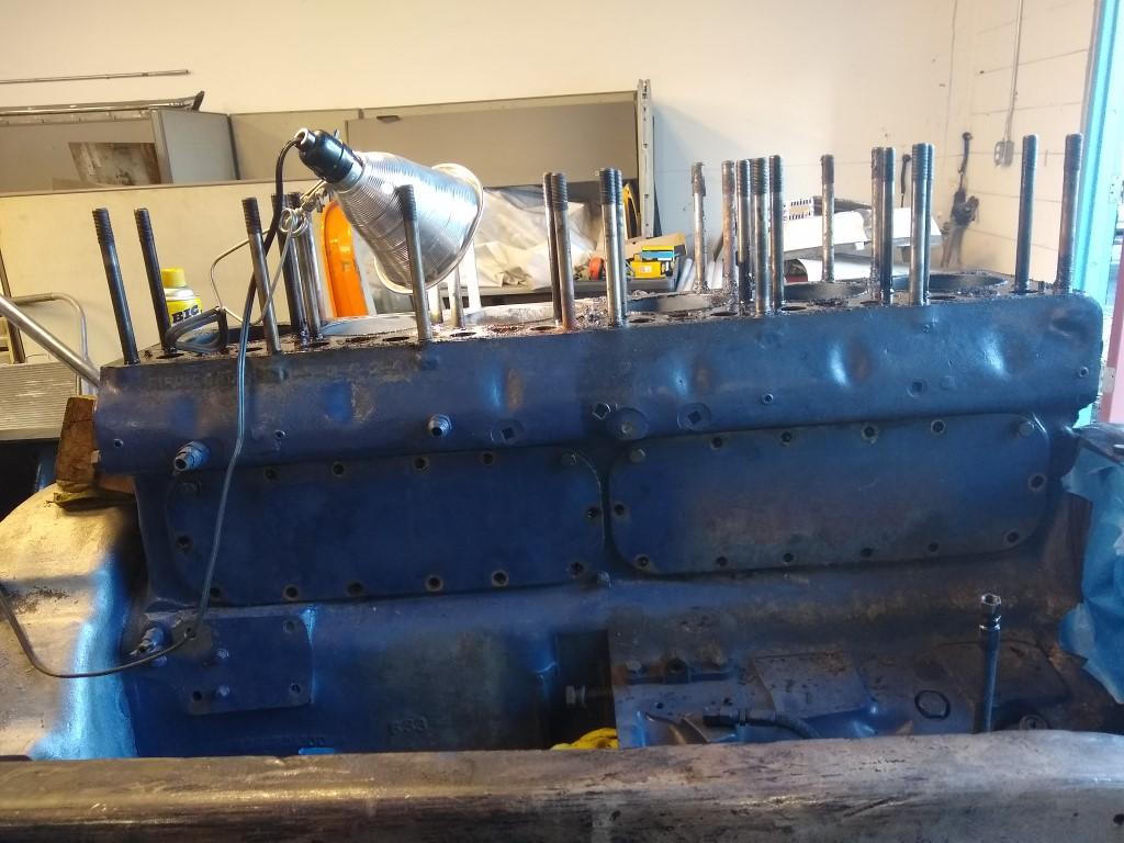

Pulled the engine yesterday. An d yes, that counter-weight is a fifth wheel plate - the round plate was for the lifting airbag. Transmission appears original - dated August 12 1953

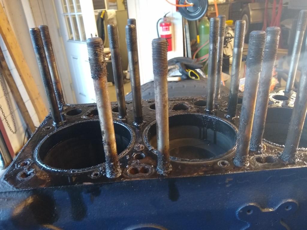

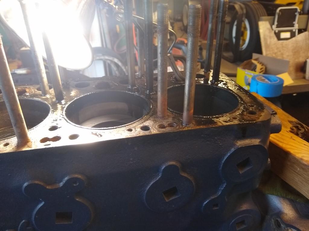

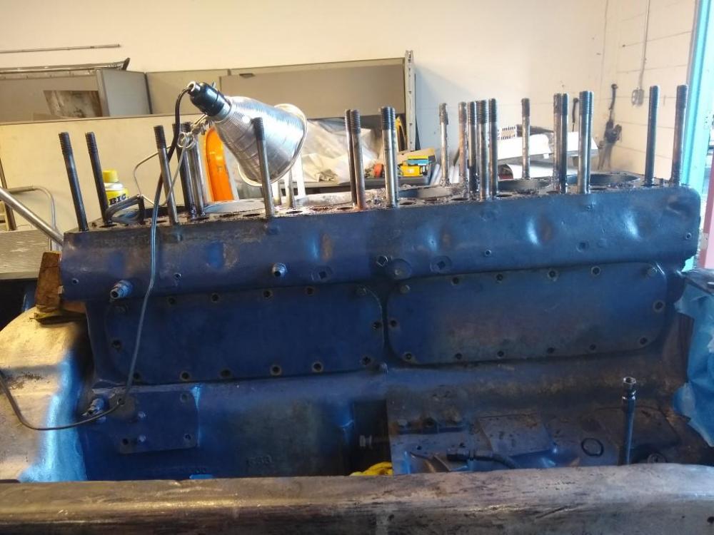

All the stud are 9/16-18 x 6.75". A few are little rust-pitted, and a few more show minor marks from using vise-grips. I was able to easily remove the nuts on all but one of the eight studs that unscrewed from the block. I'm confident the studs will torque up.

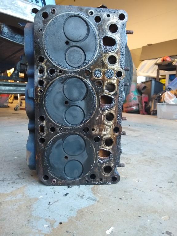

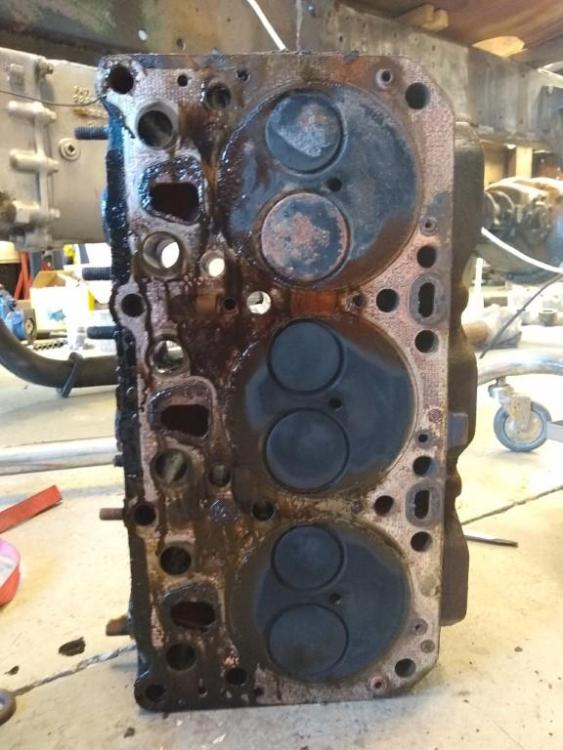

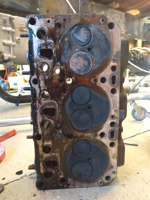

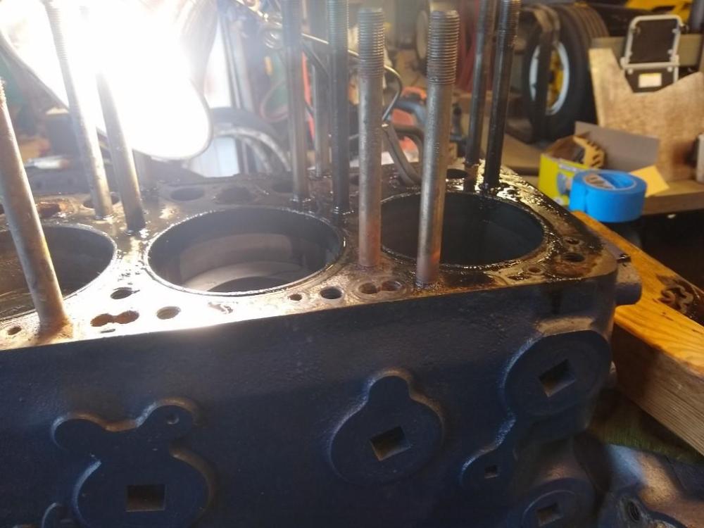

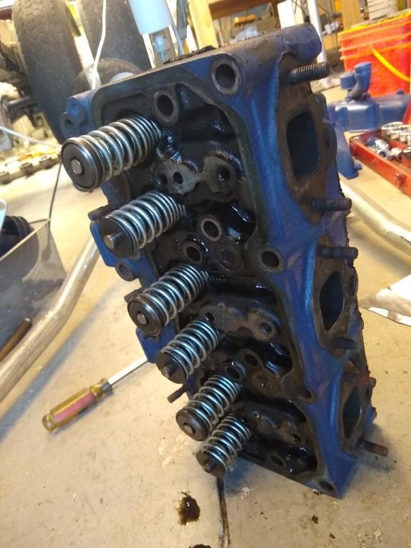

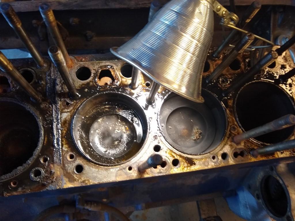

I'm finding a lot of things look good until looking at the details: Cylinder head studs & nuts My 673 uses 9/16-18 x 6.75" PAI has the 6.75" length... but only in 5/8-18, nuts too. Pistons, liners and head gaskets Pistons... maybe. If the 673 pin diameter is 2" and 15:1 or 17:1 compression Liners - all seem to be for use with the Fire Ring heads & gaskets Head gaskets - Only for 20 stud heads/block. I found a set of 18 stud gaskets - $375. Fuel injection Don't know if the injection tubes leak. Water got in #4 cylinder somehow? PAI has replacement tubes, but do the fit? It's easy to spend a lot of money before knowing what I need and what's available. It's hard to get dimensions of new parts. I'd like to rebuild it just because I like this stuff. But not if I can't get the parts I need for a nice, quality rebuild of the engine and accessories.
Head gaskets seem to be the biggest issue. PAI only list 20-stud gaskets.

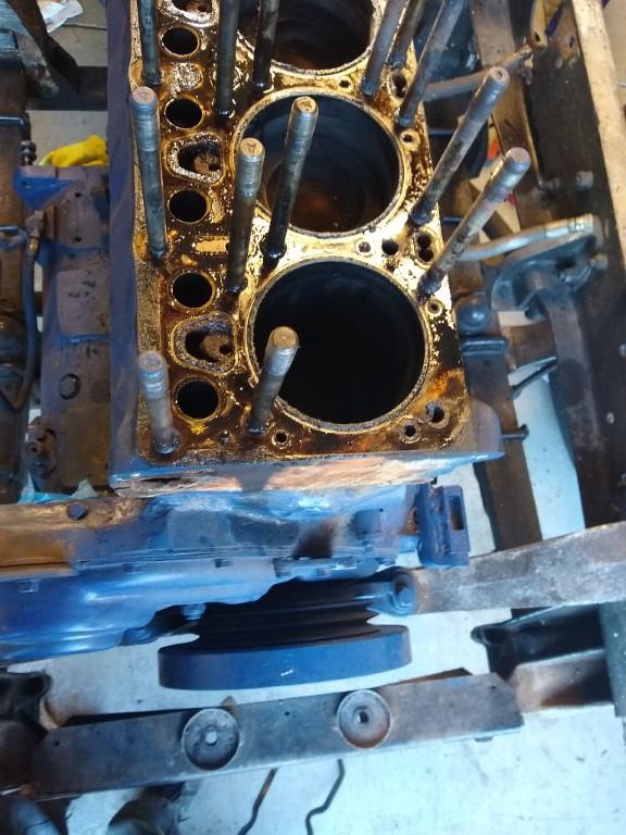

Cylinder #4 is rust-pitted. PAI has a lot of parts for the E6 with notes that include the END673. Except for the head gaskets, most pieces-parts "look" correct. Are the major components for the END673 and the E6 comparable?

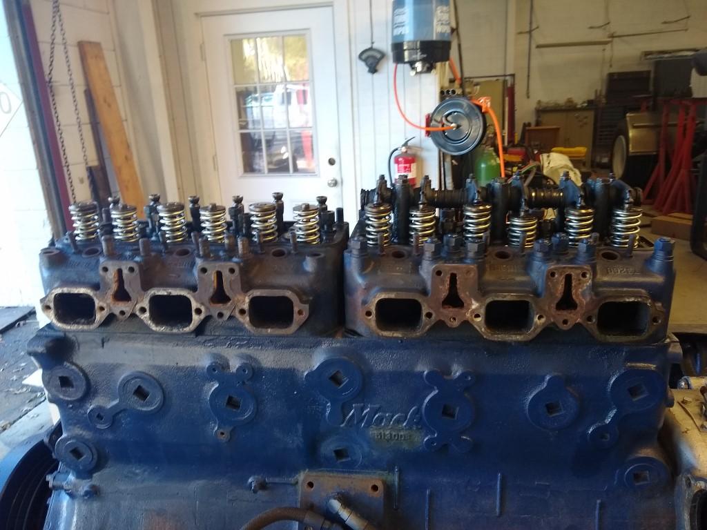

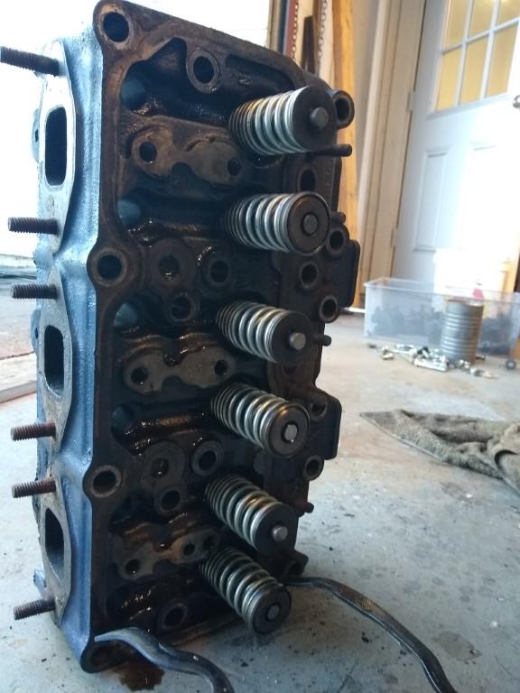

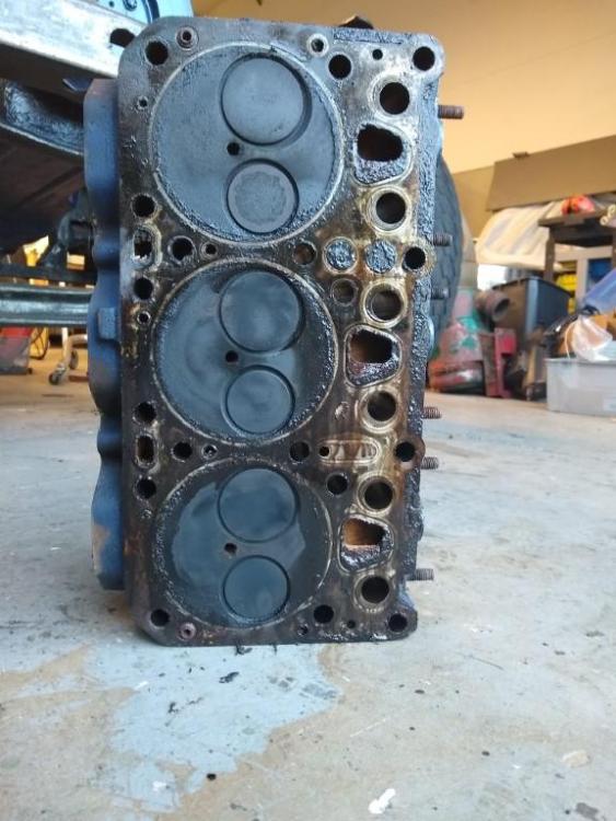

I'm considering a complete rebuild of my END673. It's not the original engine. Fuel injection: Needs new lines. Straight or pre-bent are sold as a pair - if someone is interested in a set. Injectors "look" OK for a quick (not expensive) rebuild. Cylinder heads: Pulled the valve covers, it looks like a fairly recent valve job - or at least new spring! Found a broken flat-head phillips screw sitting there doing nothing - no idea. A lot of carbon buildup on the intake and exhaust ports. Slight sign of water on #4 intake valve Pulled both heads Cylinder #4 shows pitted rust. It's not seized. Some head studs had been removed/installed with vise grips - I've seen a lot worse, but. Two different heads Two different head gasket types Two different rocker shaft mounting brackets - one was stepped, the other solid. Haven't dropped the oil pan yet. Thoughts on a complete rebuild?
