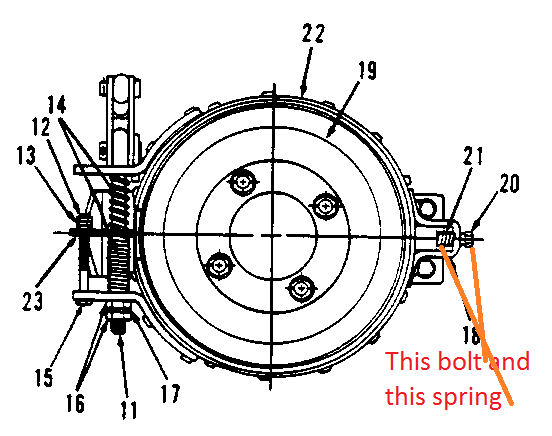

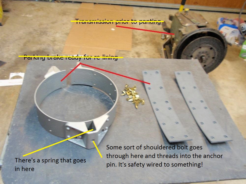

  6. Hey B-Modellers, I'm looking for pictures, parts, or source of parts for my eMack's Parking Brake. Specifically, I'm looking for: The anchor bolt The anchor spring The picture shows what I'm looking for. If I have a picture of the bolt, I can make it. I can fudge the spring.
  7. There is no engine, so no compression too slowdown or hold the vehicle stationary. Automatic transmissions have a Parking Pawl that jams into a cog that indirectly locks the transmission to the chassis... sort of like a driveshaft mounted parking brake. Except instead of a cog and a pawl, it's friction band around a drum.
