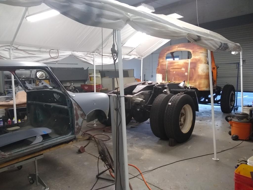

The passenger side photos with and without fuel injection are really good and make sense. It looks like there are several configurations for the non-turbo driver's side. For some perspective on two of the five vehicles I have in the shop: On the left is a 1990 Mini Cooper - curb weight: 1,500lbs. On the right is the '53 B61 whose current weight (estimated by the hauler) is 13,500lbs. -

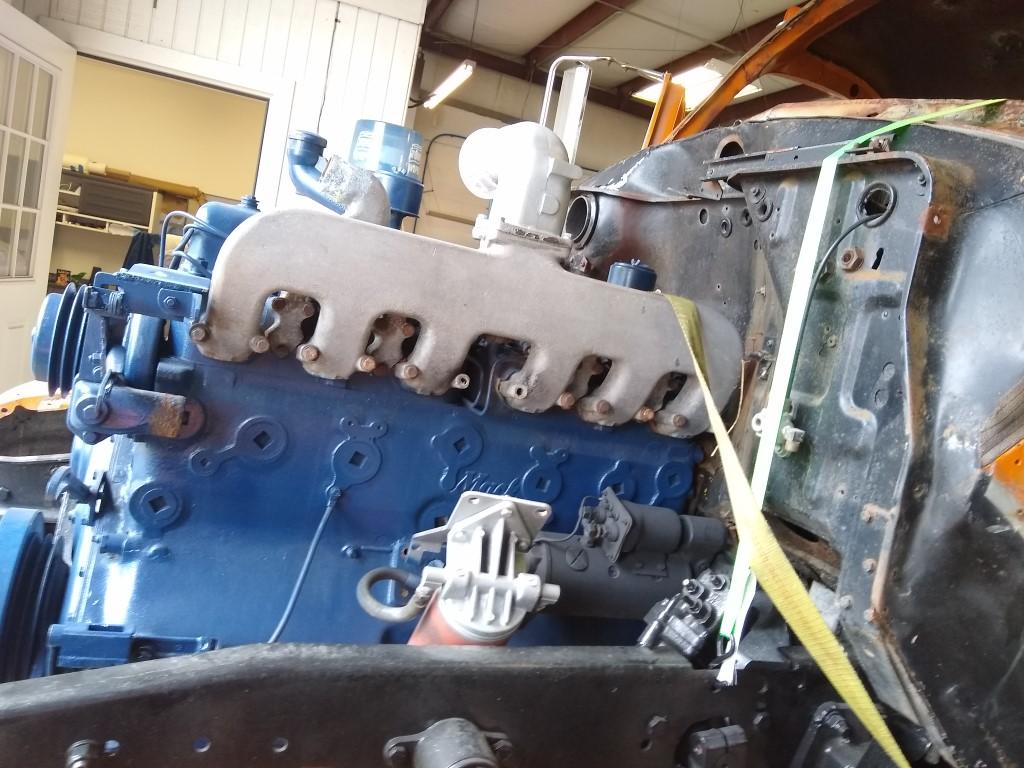

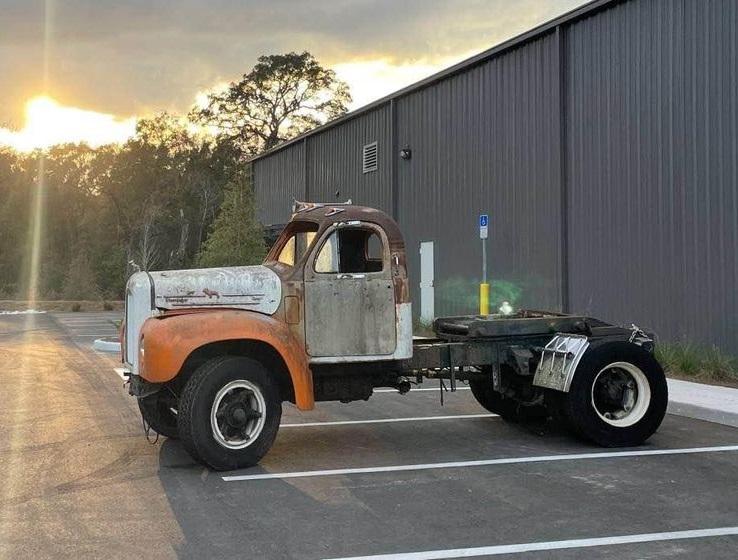

I bought a rough and partially assembled '53 B-61T with a END673. The engine supposedly runs/ran. I'm not sure what's coming from the Mack Museum, so I'm looking for diagrams and photos from a running B61 with an END673. Specifically: Fuel injection lines - to and from the pump. This is what I have: See above photo: Engine compartment air lines and routing: See above photo Air intake routing What mounts on top of the exhaust manifold - Engine accessories - generator/alternator brackets. Someone "installed" power steering. Steering gear FYI: I'm not converting it to electric (but I may install electric power steering).

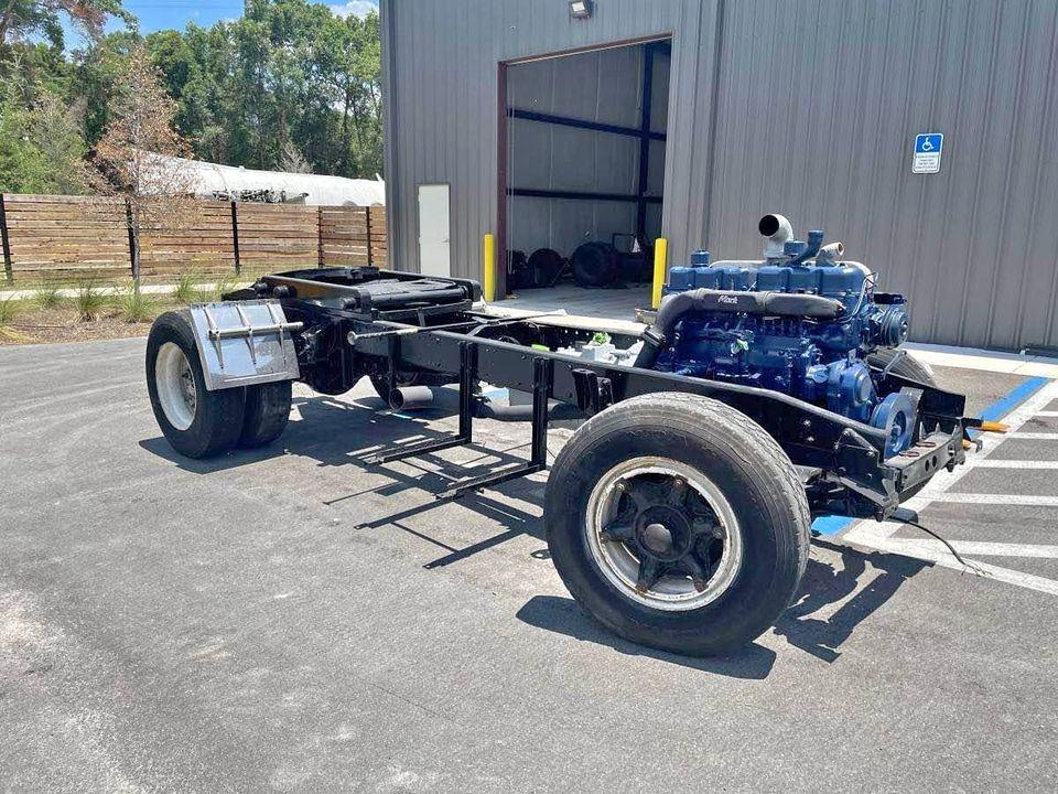

Nothing new on the Mack B-46E... I have a retired helper, but his skills are limited to rough sanding, rust removal, painting (spray cans). Very little work for him on the Mack B-46E. But... Friday I looked '56 B-61 Don't be fooled by the pictures - especially the chassis. Yes, it was painted... lots of paint! Engine supposedly runs. Good price Haven't officially talked to my wife about it. But, considering she is willing to spend $6,000 on her 2006 mini Cooper for paint and new clutch... -

I moved the shop and then got sidetracked on the eMack. And then the owner of a 1976 Alfa Romeo Spider wanted his car restored and converted to electric - rust had taken its toll and if his mother wasn't the original owner the car would not have been worth it. Not sure what my last post here was, but here's a flickr photo link to my various project - including the eMack. https://www.flickr.com/photos/emack/albums I've also attached a couple videos. Mack Movie.mp4 1574113594_MackMovie3.mp4 -

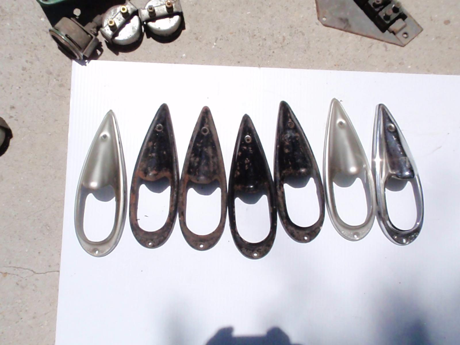

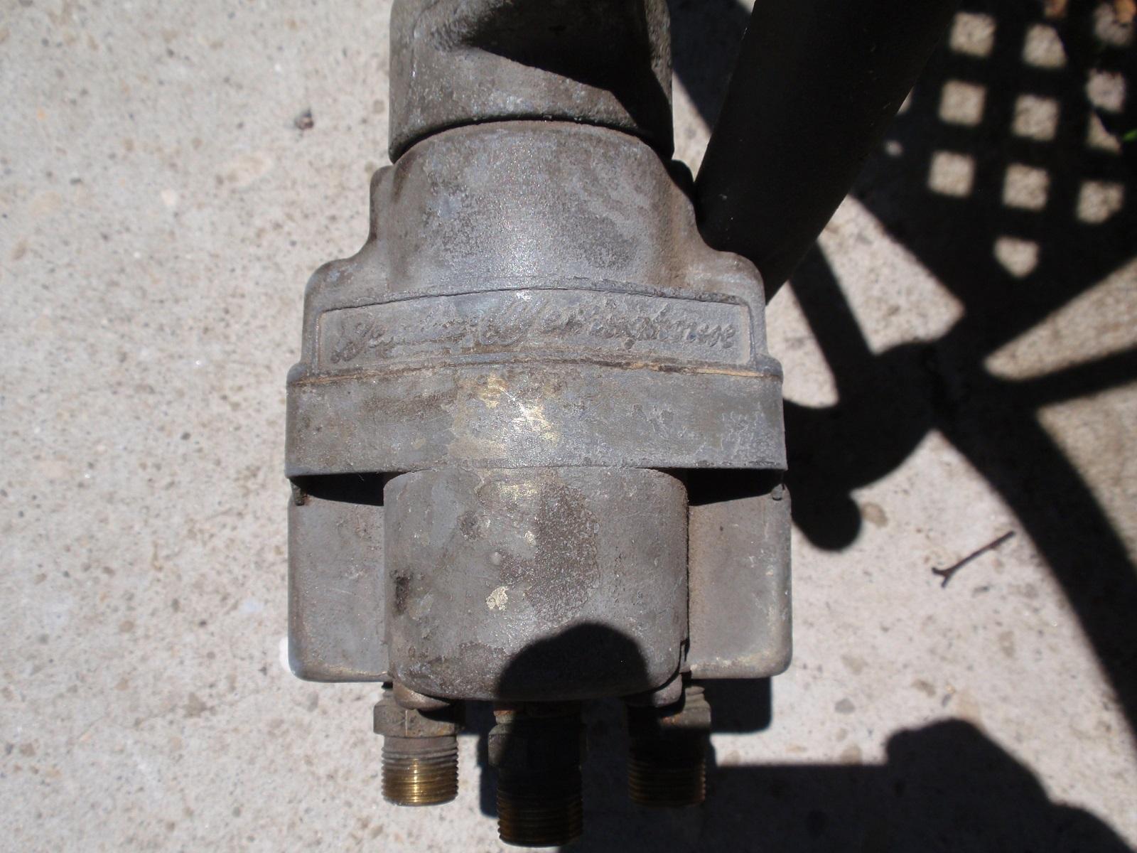

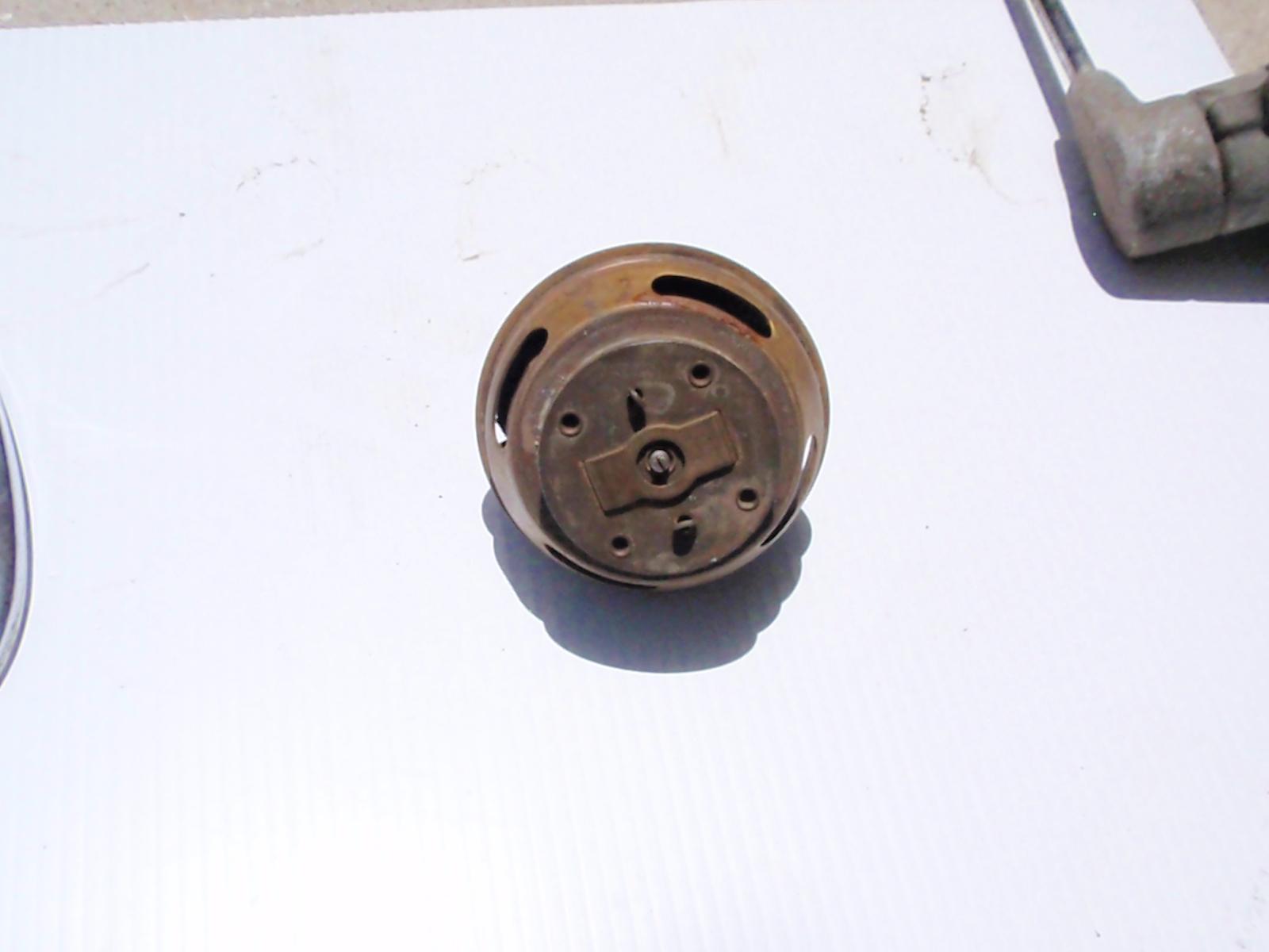

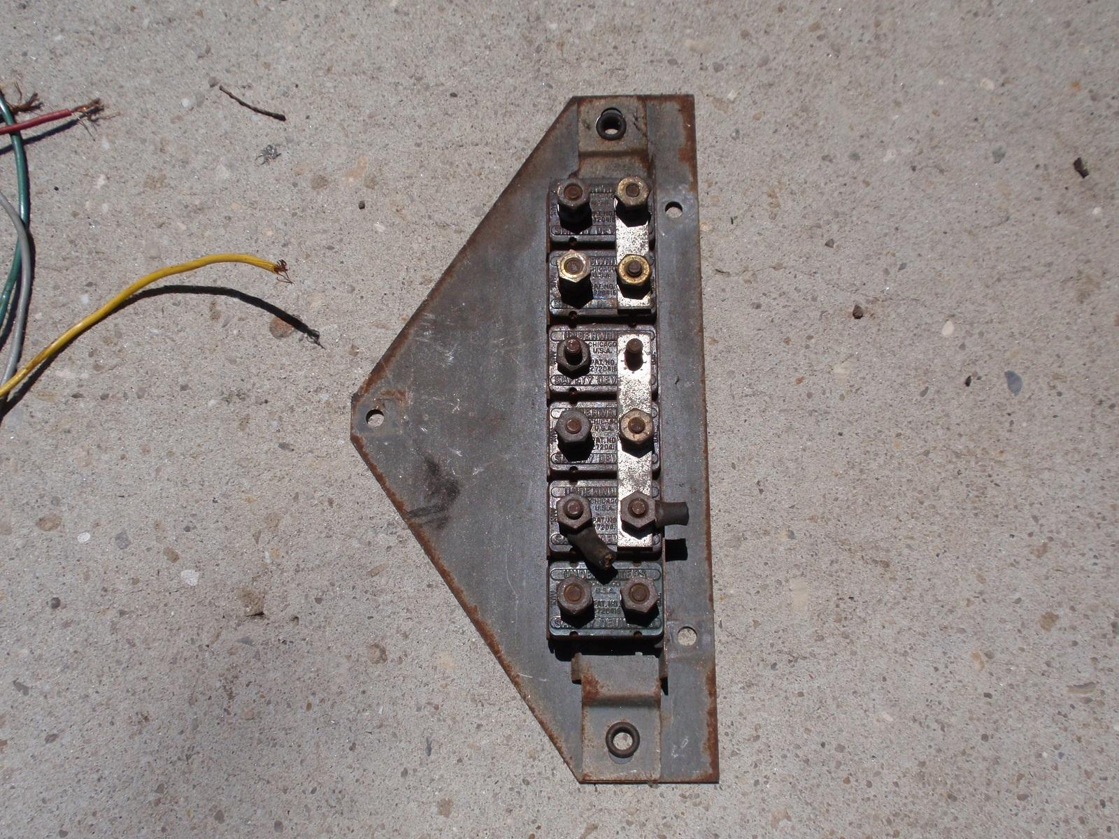

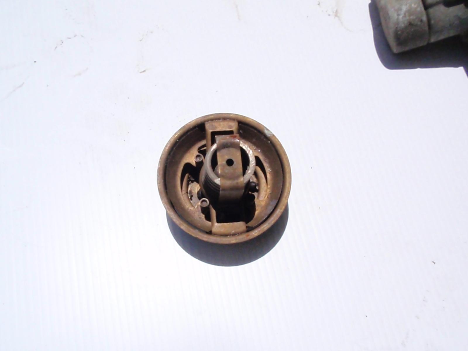

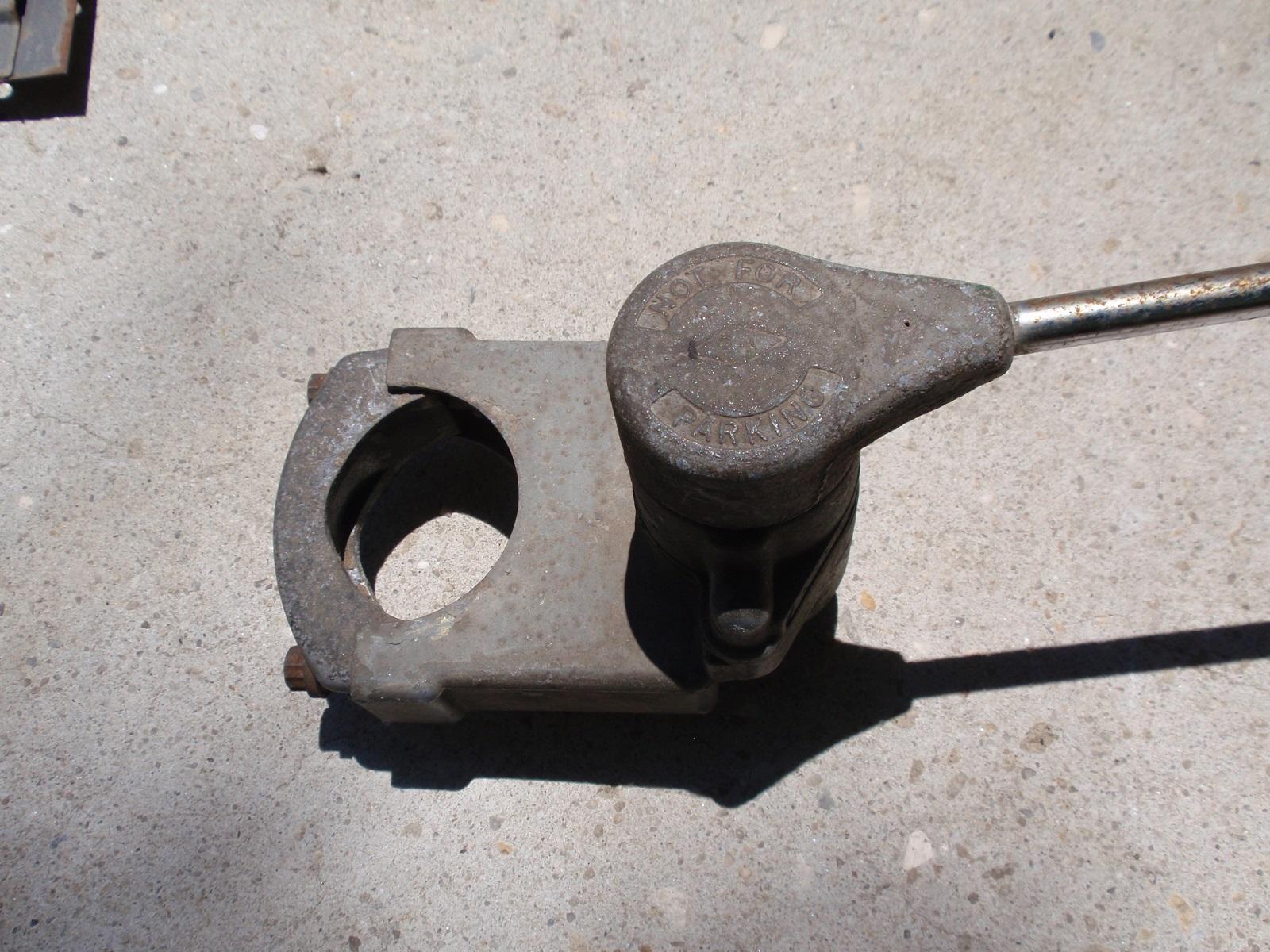

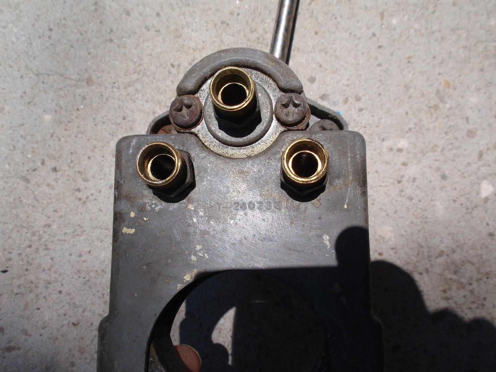

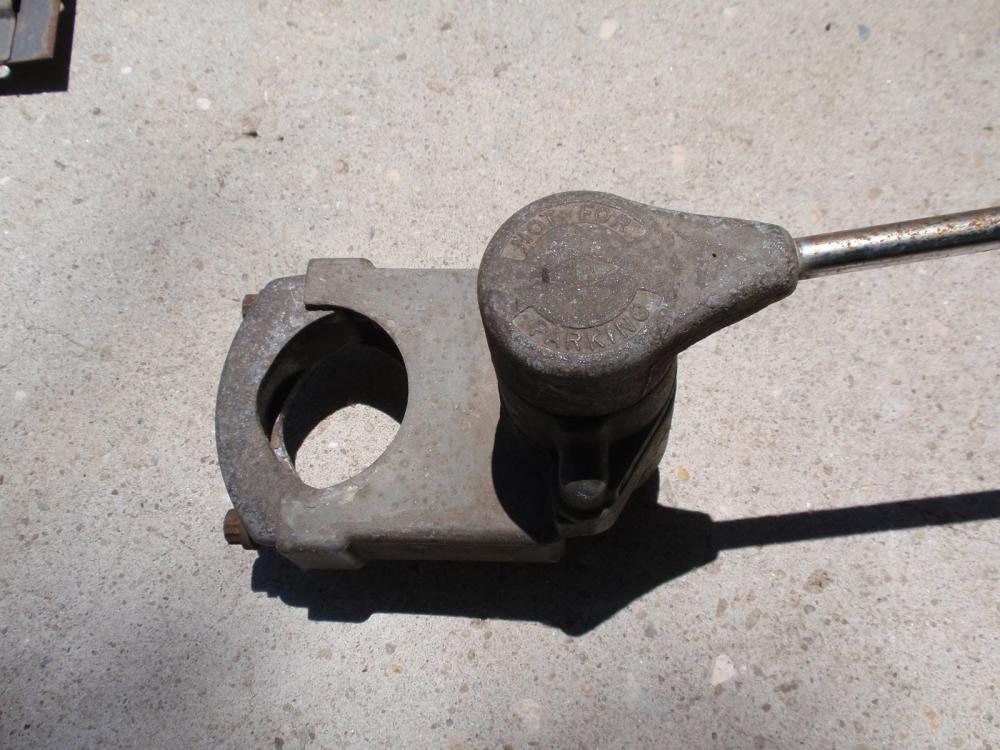

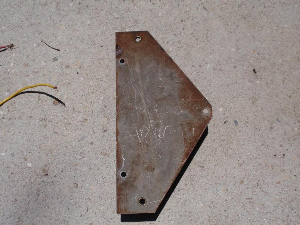

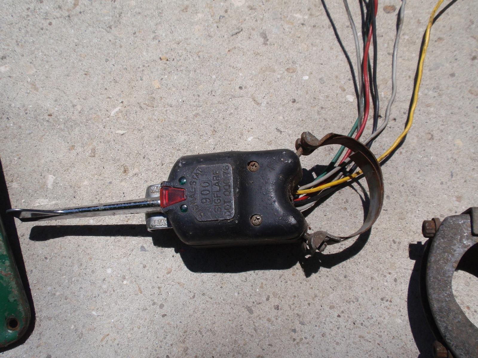

Misc. B-Model Small parts Circuit breaker panel Turn signal switch Bendix Trailer brake bias control Engine thermostat Do-Ray 410 cab light shield Best offer, all or separate, plus shipping from Gainesville, FL 32605
