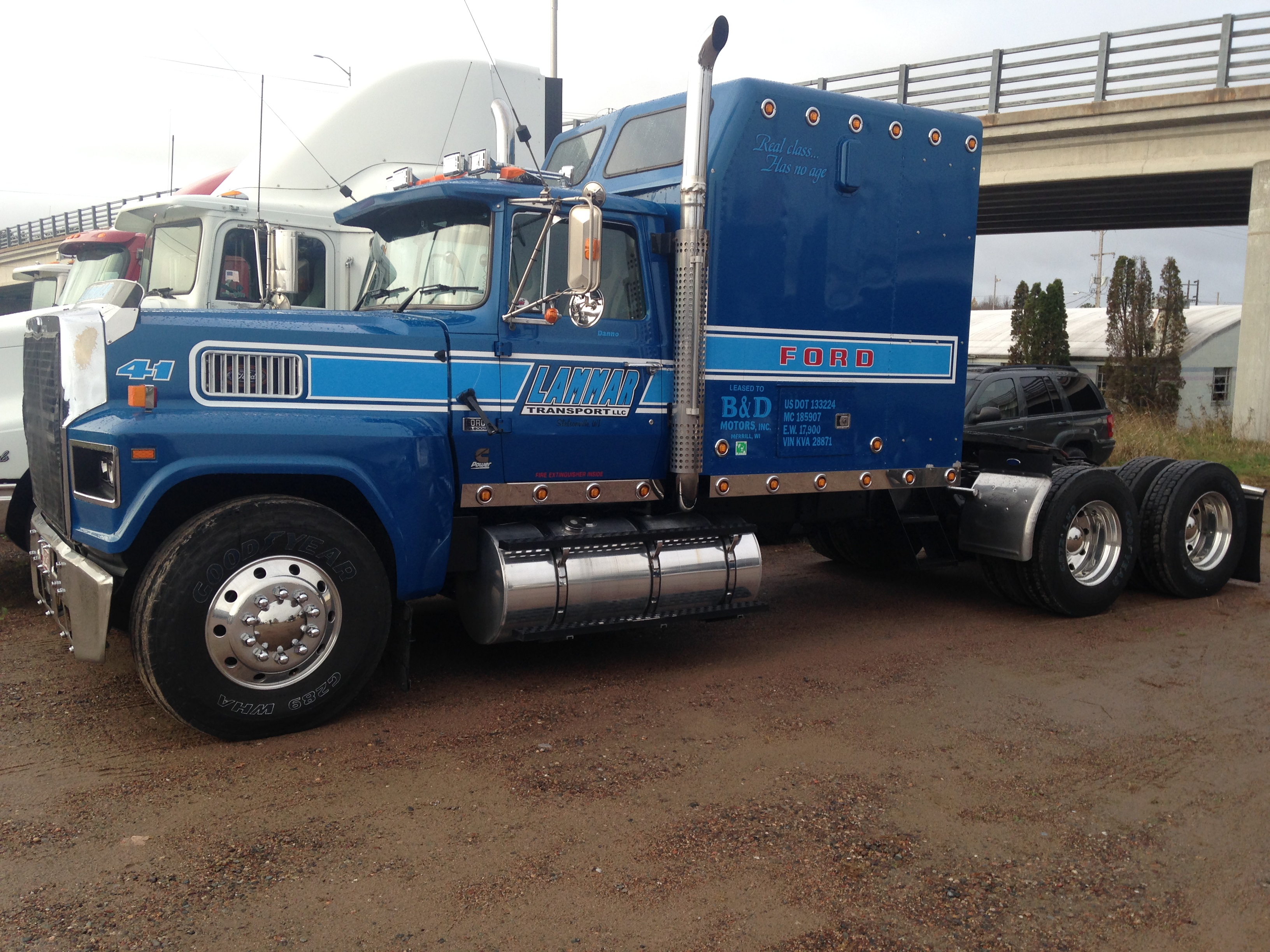

  16. Yeah, definitely not your average coffin sleeper....
