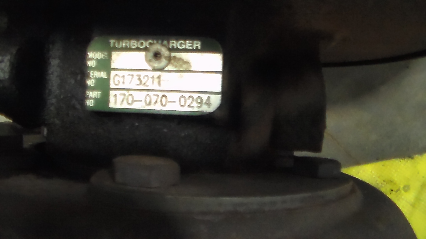

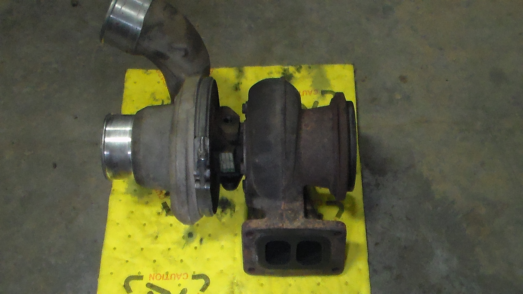

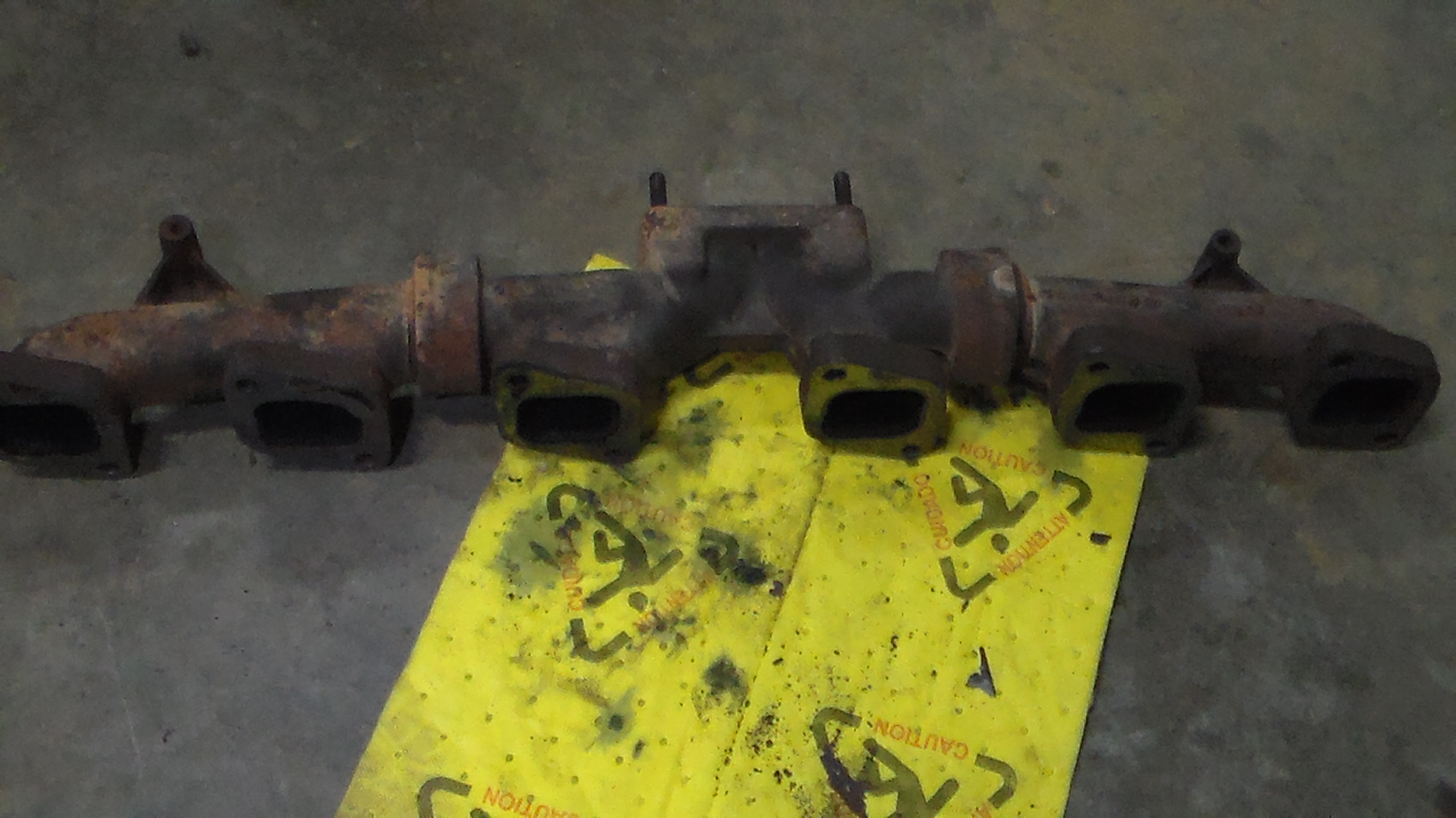

  16. Turbo and manifold in good condition. Take-off from 2005 AI460. Can have both, or just turbo for $400 + shipping. New Turbo price from Mack is $2,318.43. 2 years in service.
