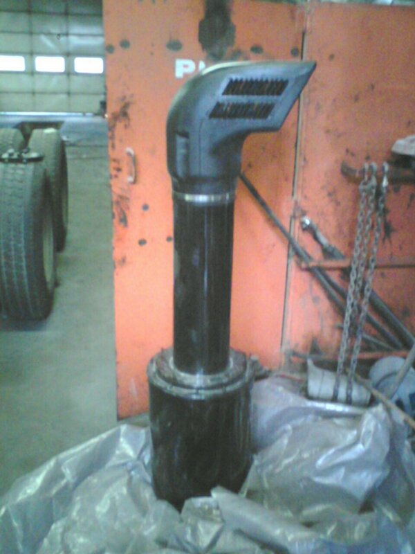

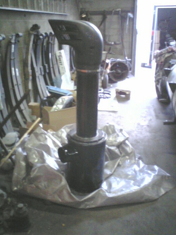

  10. breathers that are going on THE SUPERLINER when it comes out of the shop!
