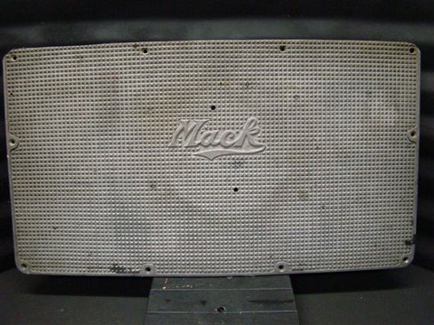

  16. I've not yet identified it. It measures 24" x 13 3/8" x 1/4" thick. Being that thick, I think it's more than a decorative piece. I feel like it's a floor board access panel that you remove to get to something, maybe a transmission, underneath. They would make it that thick otherwise.
  17. It doesn't belong to me but I can put you in touch with the man that has it. It measures 24" x 13 3/8" x 1/4" thick. What is it though?
  18. Severe service welcome mat? Where did it go, on the driver's side floor under the pedals?
  19. What year model would you guess? I have a 1972 CF and there's nothing like this on my truck.
  20. Can anyone tell me what it is and what it goes on?
  21. Can anyone tell me what this is, what it fits, and what it's worth?
