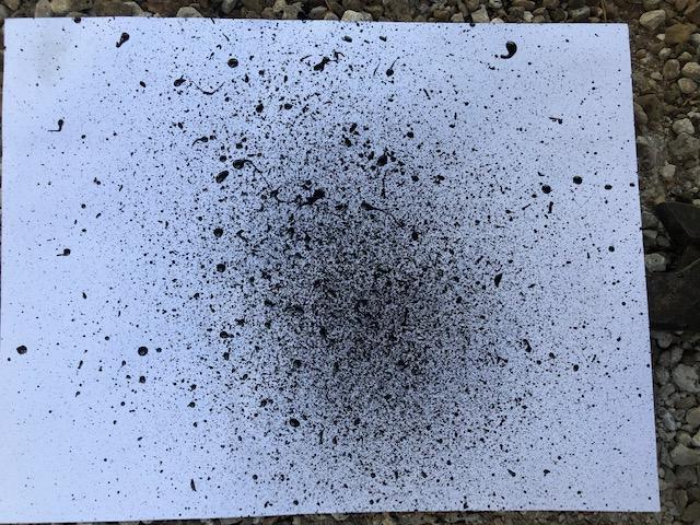

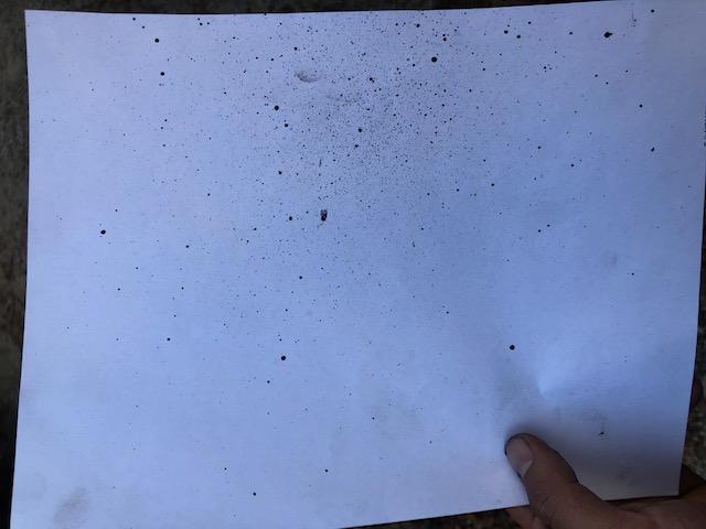

  10. The compressor on my truck is a meritor system saver 318, i cant seem to find any for sale. Any compressor brand should do as long as it fits and same CFM? Im thinking one from bendix as those seem easier to find. I'll have to take a closer look tomorrow.
  11. I just got around to trying to fix this issue, I did what you recommended and this is the amount of oil it put on the paper in 1 minutes time. Any advice on where to check next? I'm not sure how to verifdy if oil is being pulled past the rings of the compressor. Paper was about 24" away from supply line for 1 minute. Update: I ran the truck for 30min and then did another 1 minute paper test. This is the results. Im assuming the first test was maybe risidual, dont know if itll clean up after a while. Thoughts?
