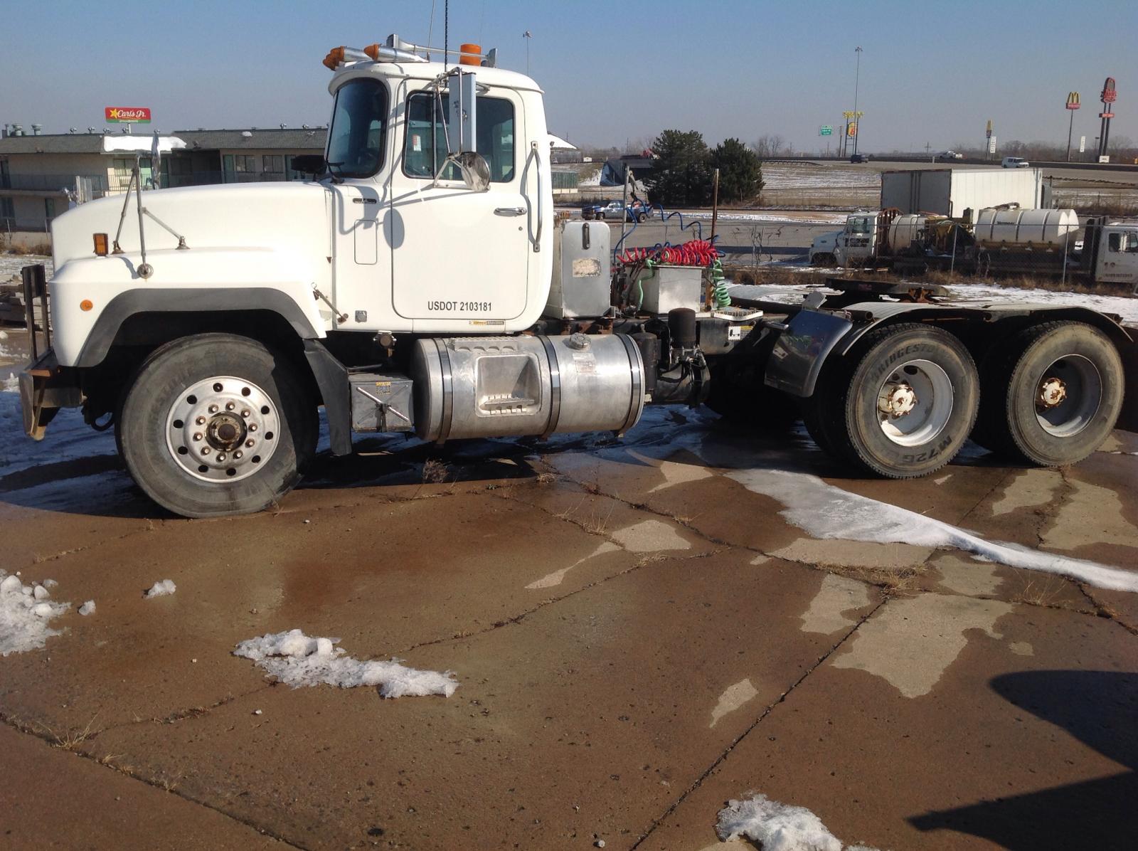

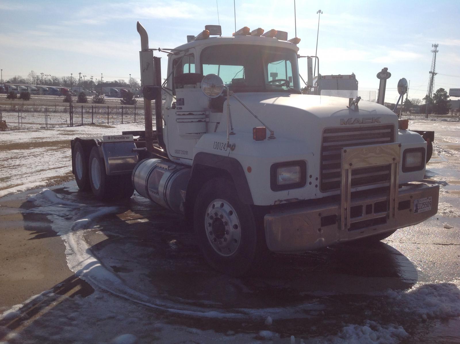

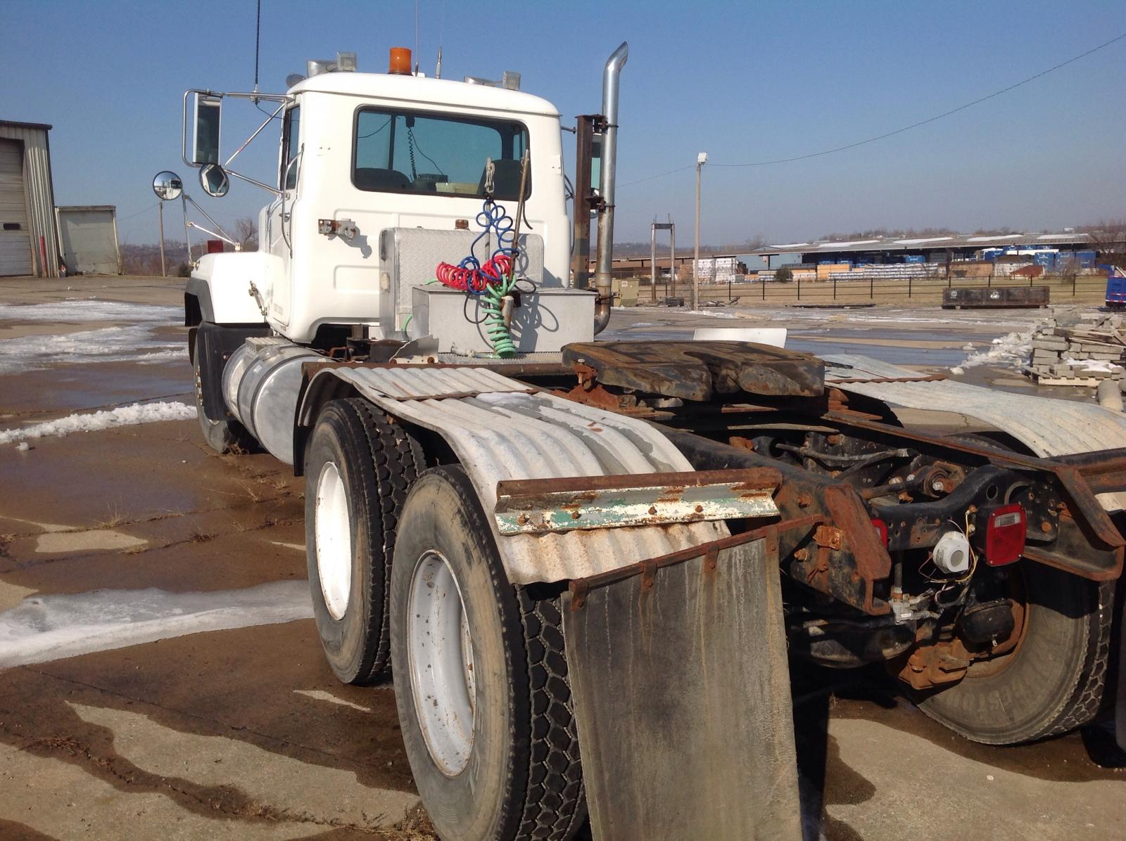

  21. 1996 Mack RD688S-E7-400, Mack T2130/18, FAW12, 12000lb. Front Axle, SS440, 44000Lb. Camelback Springs, Steel Budd Wheels, Wet Kit, Sliding Fifth Wheel. Bad engine. The story on the engine goes as I know it. This trucks engine was supposively rebuilt but they couldnt get the timing right. Brought to us. We timed it and started engine. We let engine run and sounded good, then all of a sudden engine locked up. Found someone had put a bolt in the oil galley hole for the econovance. Located in Tulsa, Okla. I have a clear title. $8,500.00
