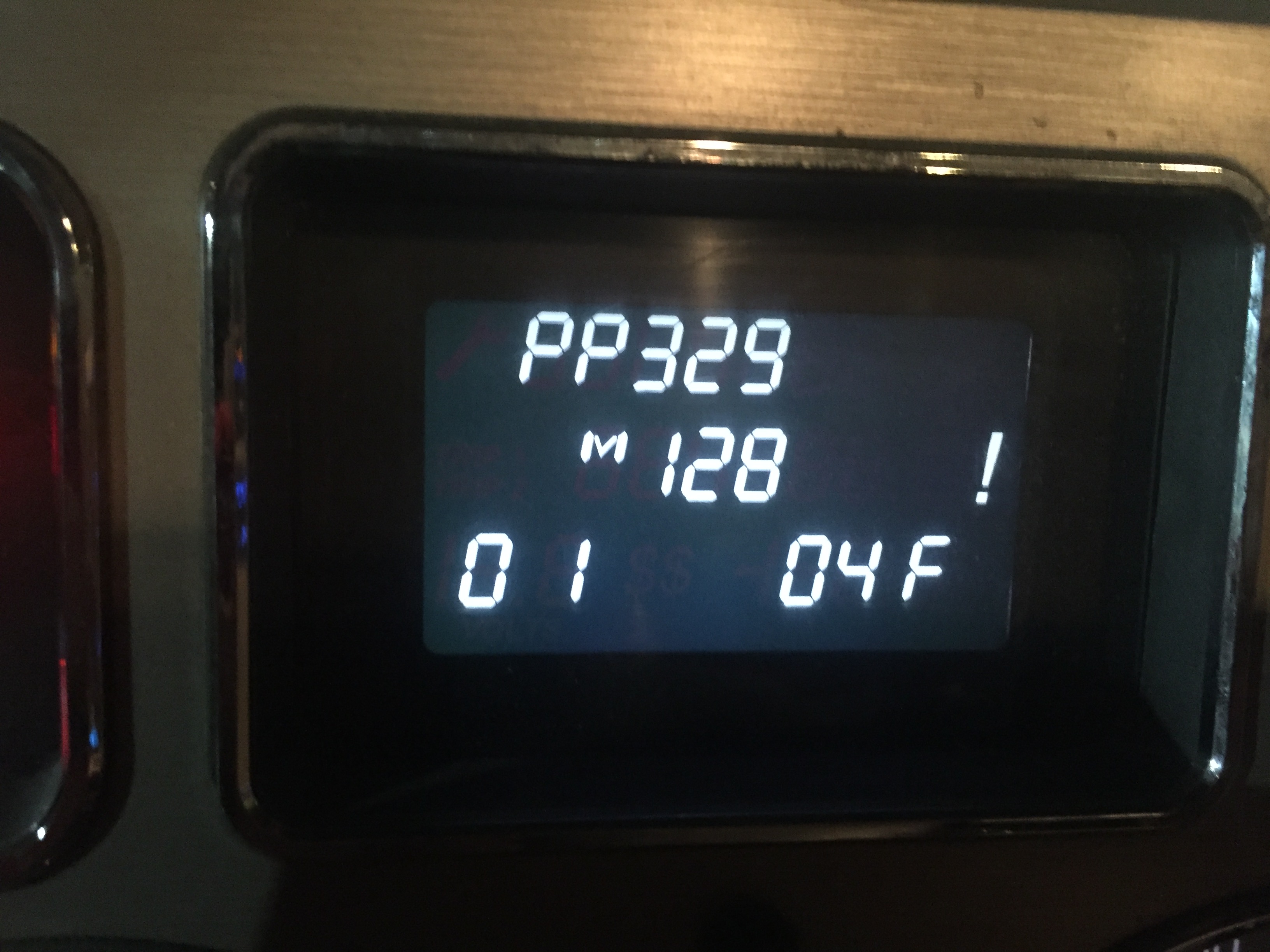

  21. Anyone know what PP329 M128 01 04F is?
