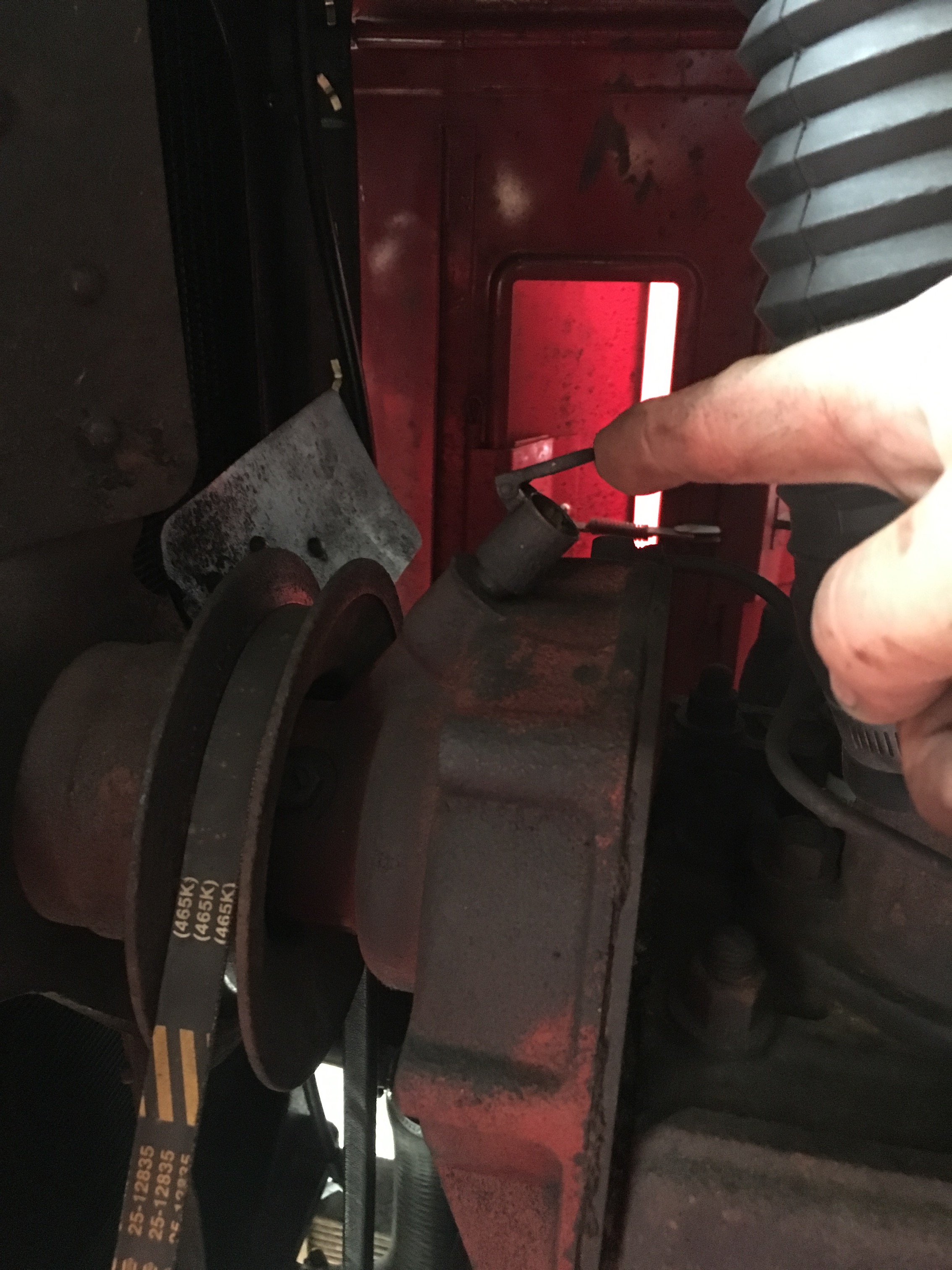

  5. Anyone know what kind of lubrication goes in this little flapper doohickey on the fan pulley? 1937 Mack flat 6. Any other insight would be appreciated. Thanks
  6. Thank you Jim

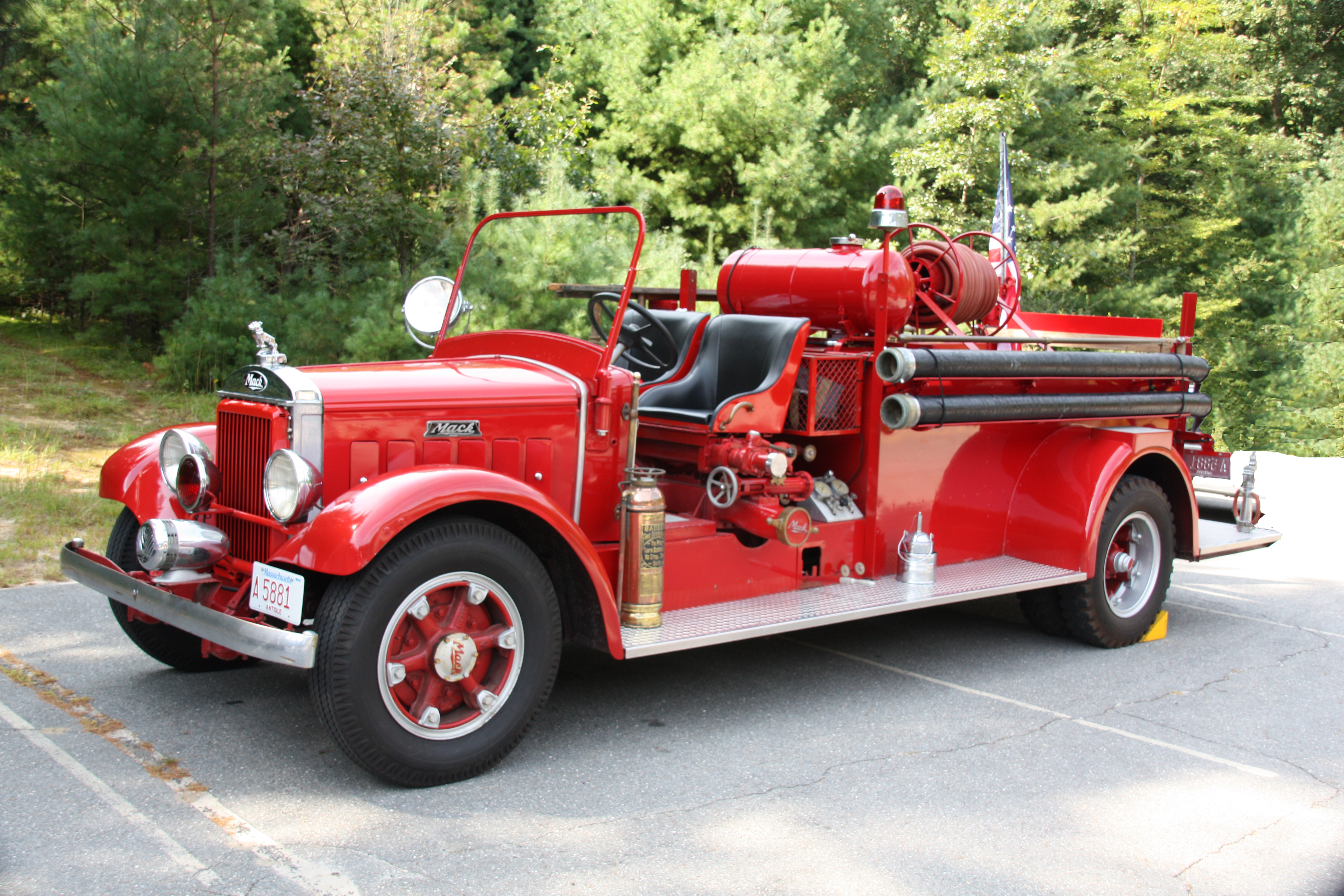

  13. Yep. Here is an article that outlines the history. http://blogs.sentinelandenterprise.com/communityconversations/2015/07/23/saving-a-1935-mack-fire-truck-priceless/ I believe there is a sister truck, one number off down in CT as well.
  14. Not our truck, but there still are a few others around.
  15. Jim you are a wise man... in short yes. Originally purchased by Lunenburg on December 27, 1935 (Yes I have the original bill of sale) it was traded-in in 1961. Then in 1985, some of our members were up at Meadowood for a training and there she sat. In rough shape sitting outside. They negotiated the sale and brought her home.
