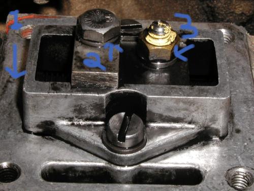

  1. i need some input/help. so i want to crank it up some. do i loosen #2, turn #1 to move the slider towards the front of the truck? what is #3 for? im currently running about 16 psi @ 825*. thanks guys.
