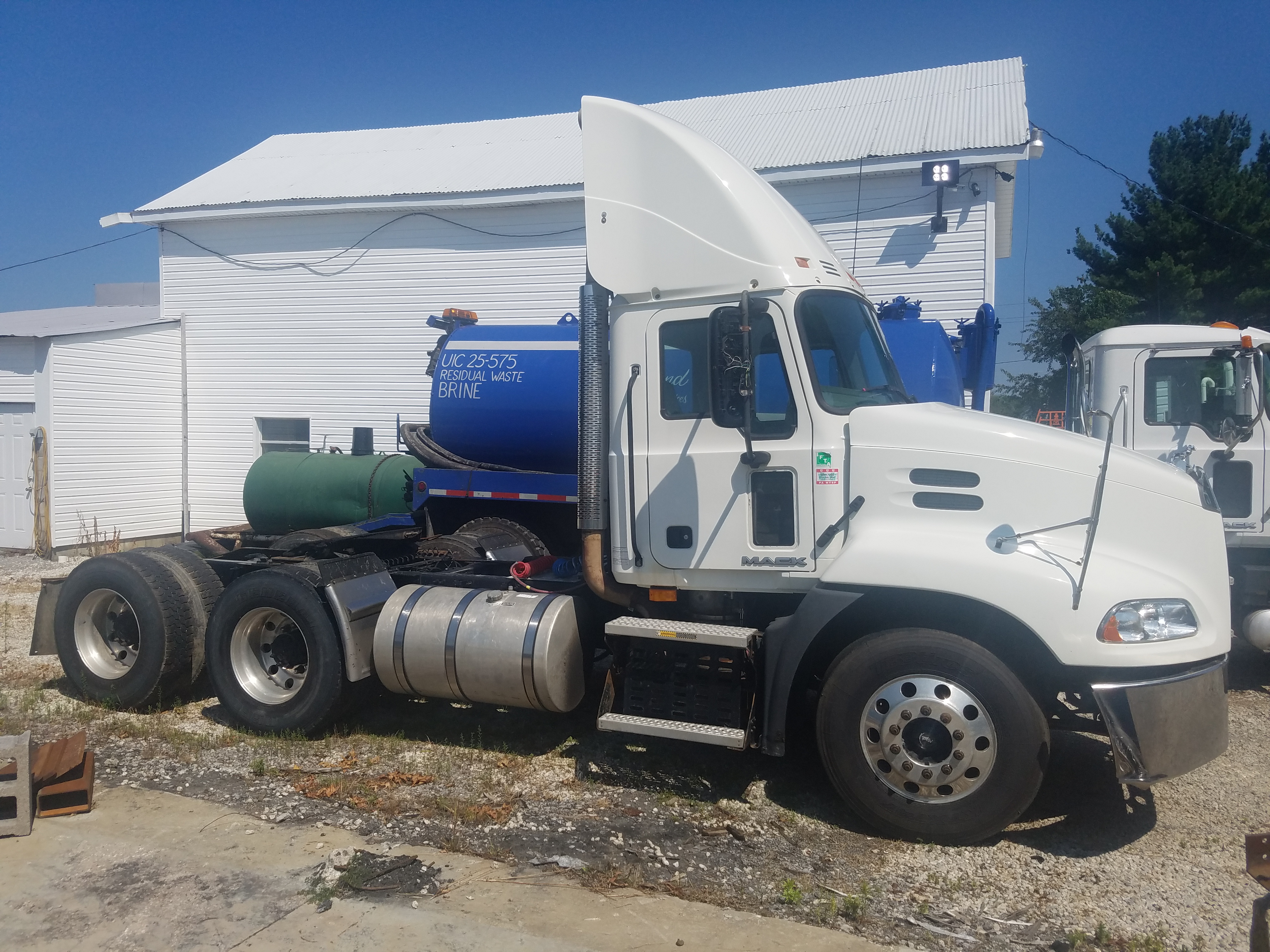

2008 Mack cxu613. Has 760,000 miles on it roughly. Has a pto on it also. Truck has recently been serviced and checked out. Front end is tight with newer steers and fresh alignment. Crack around headlight from vibration but other then that trucks pretty solid. This is a good truck but my wife and I cannot afford to run it over the road. We are in the on-site construction business and this truck is too light duty for the work we do in the mud. I need to sell this truck because we can't afford the payment. Please enquire.

I have a Mack cxu 613 for sale. It has 760,000 miles on it. The truck was well maintained and has just been serviced and aligned. Has a tight front end with newer steer tires. I need to sell this truck because it is too light duty for me to use in my local Oilfield business and I can't really afford the payment. My wife and I used to run this truck over the road but quit after the numbers just were not working and we decided to focus on more local work. It has a pto on it and a hydro pac if the price is right. Crack in hood around Driver headlight from vibration. Reliable truck just can't use it or afford it. Asking 15k call if interested 2348064185 or tulsaruffneck5@aol.com
