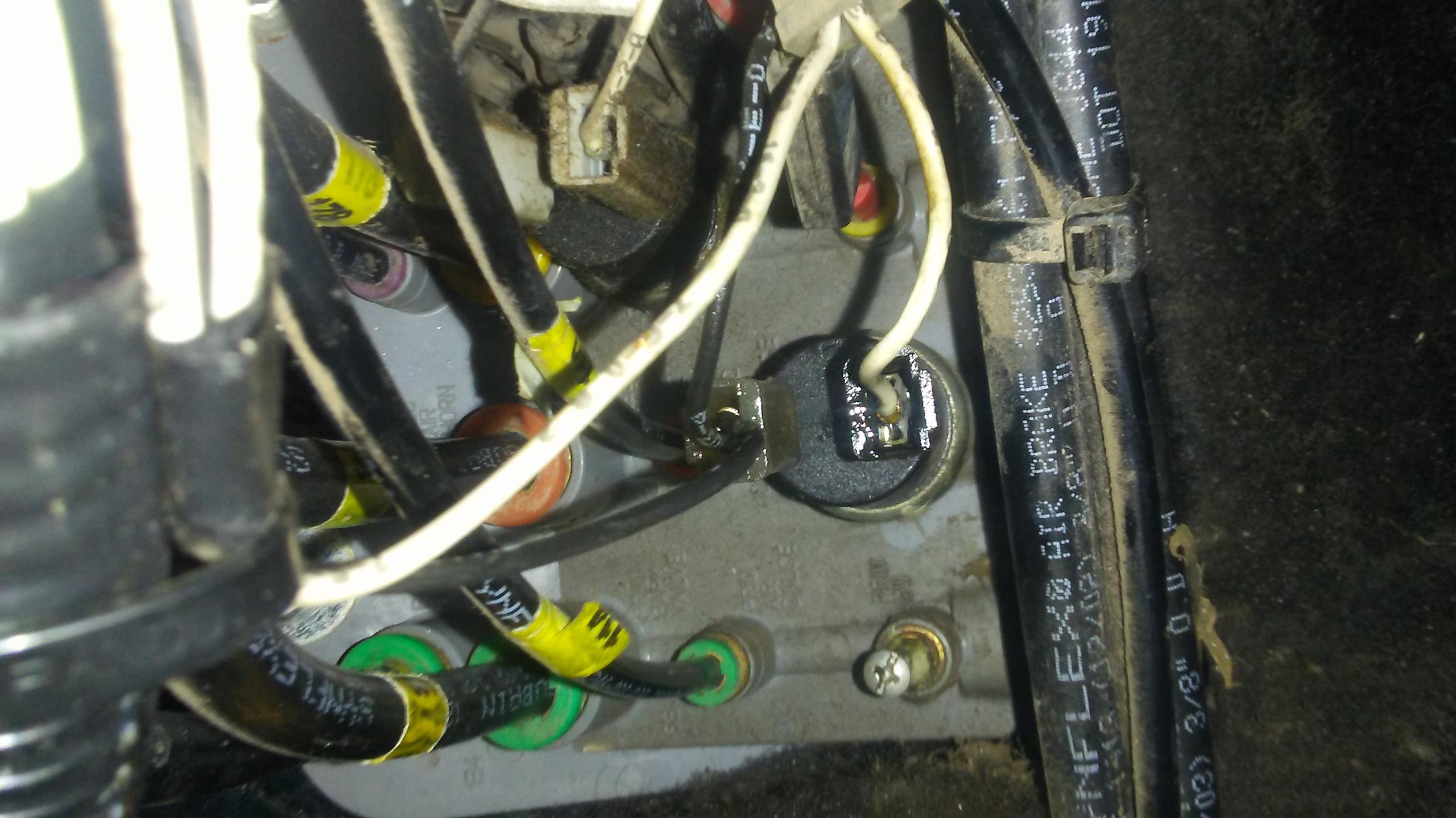

  12. What it was was the faulty sensor , where the white goes into ended up to be cheap fix 56 bucks the manifold was fine i appreciate the input and help
  13. I have a steady flow of air leaking from here where the White wire goes in right above the foot pedal on a 2004 mack, what is this thank you for any help on this
