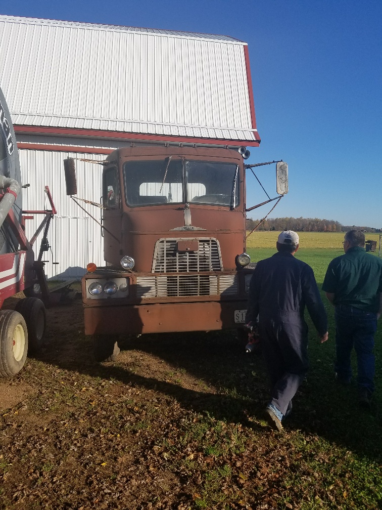

  13. This truck was used on the Antigo Wisconsin potato farms as an irrigation truck after it's useful life of hauling potatoes was up. I believe it was made in 1957. The interior (sorry no pics) was olive green. It's been on the farm ever since. A collector from Wausau, WI purchased it for $1800 last week It runs great. Needs some paint. Will try to get photos of the restoration.
