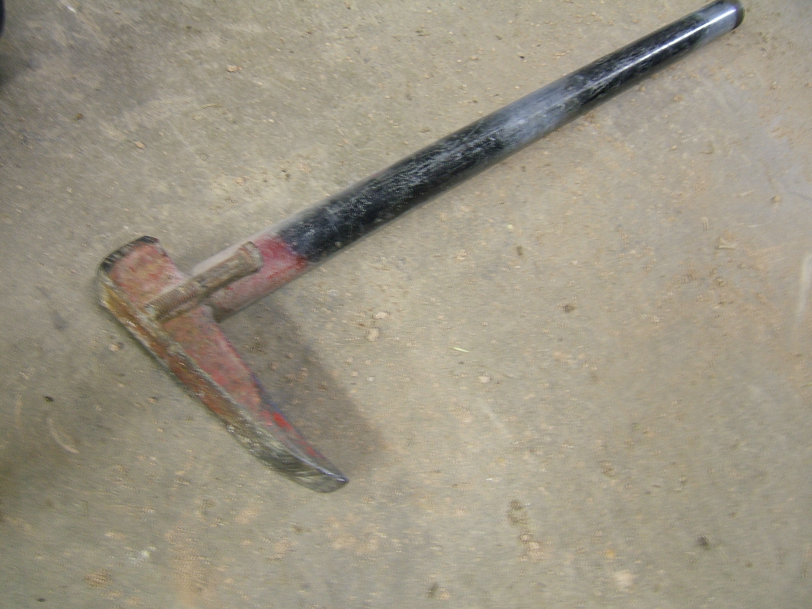

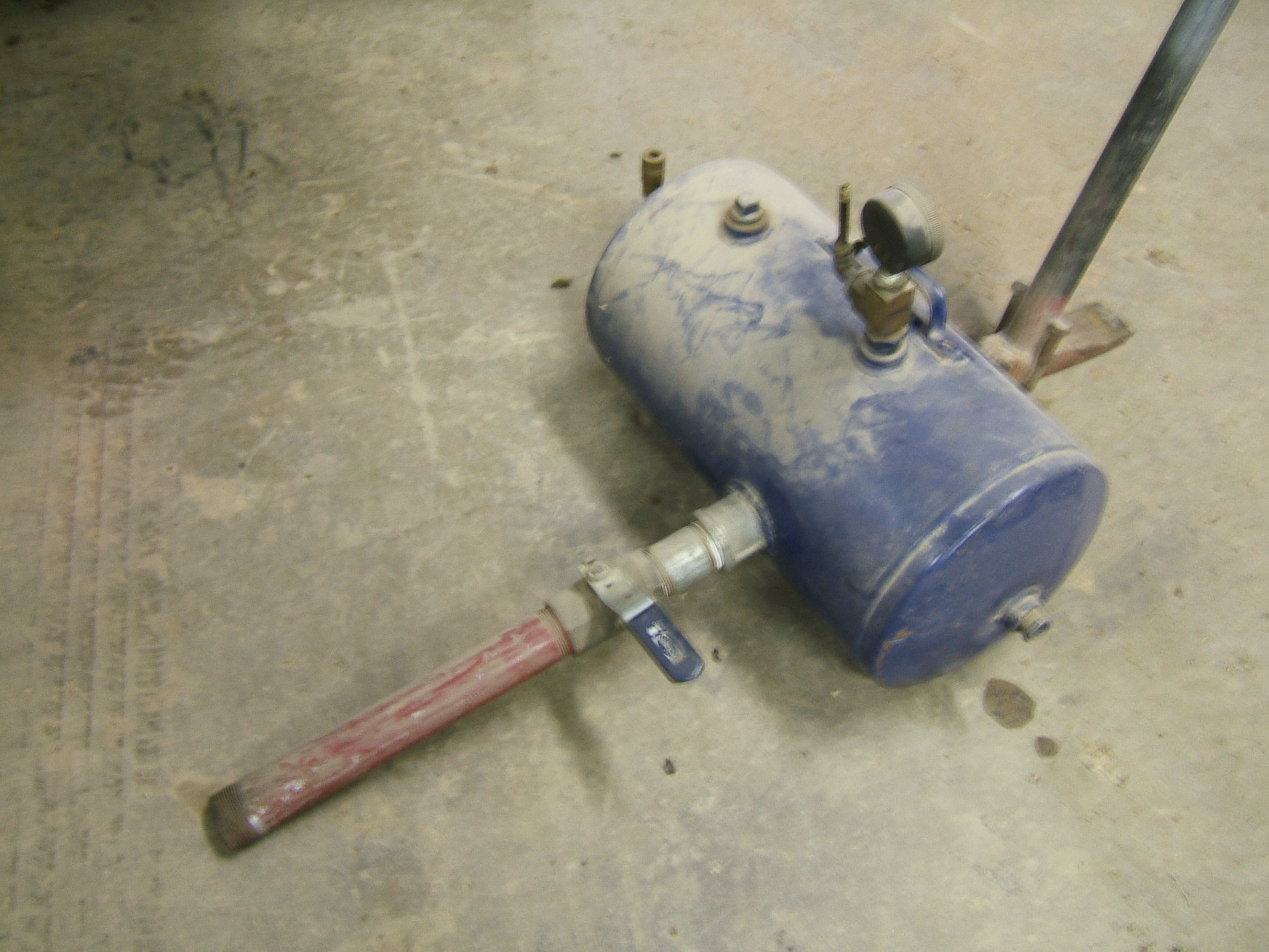

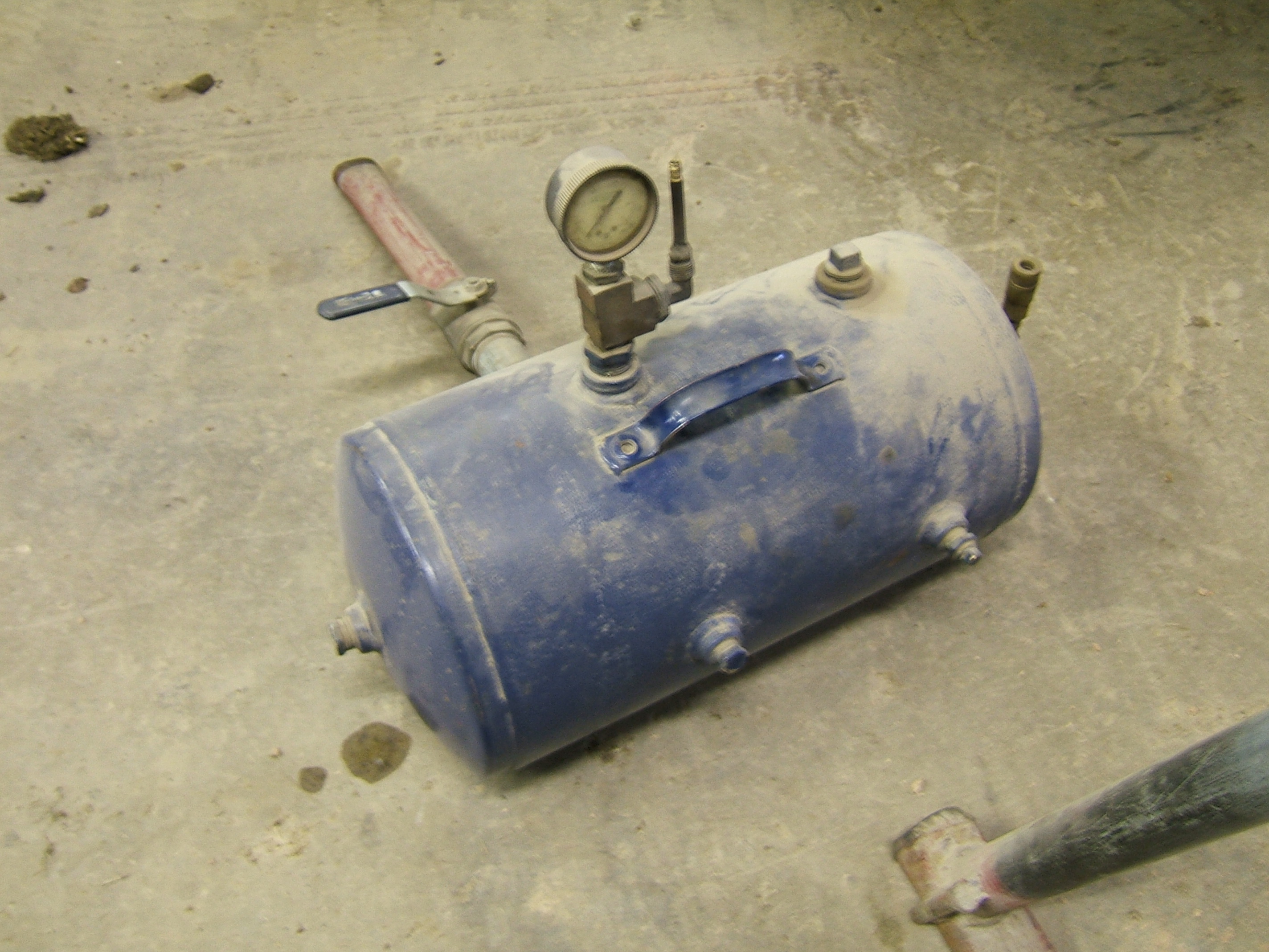

  13. Today after work I took some pics of my homemade tire equipment:: I made that tire hammer from a wood splitting wedge bent over & ground off blunt on the end, and welded to a pipe handle. I made the "Cheater tank", as previously stated, from a truck air tank with a handle welded on and the large pipe fitting welded into the side of it. .

  21. I heard that they're 3 or 4 hundred $. I built my own cheater tank years ago from a truck air tank I had laying around. Cut a hole in it, welded in a 2" pipe nipple, screwed on a ball valve and a 12" long piece of pipe which I squeezed halfway flat at the end, then welded a handle on top of the tank and screwed a schrader valve into one of the unused ports to fill it. Before I made the tank I used the ether method, but the tank is a lot safer. .
