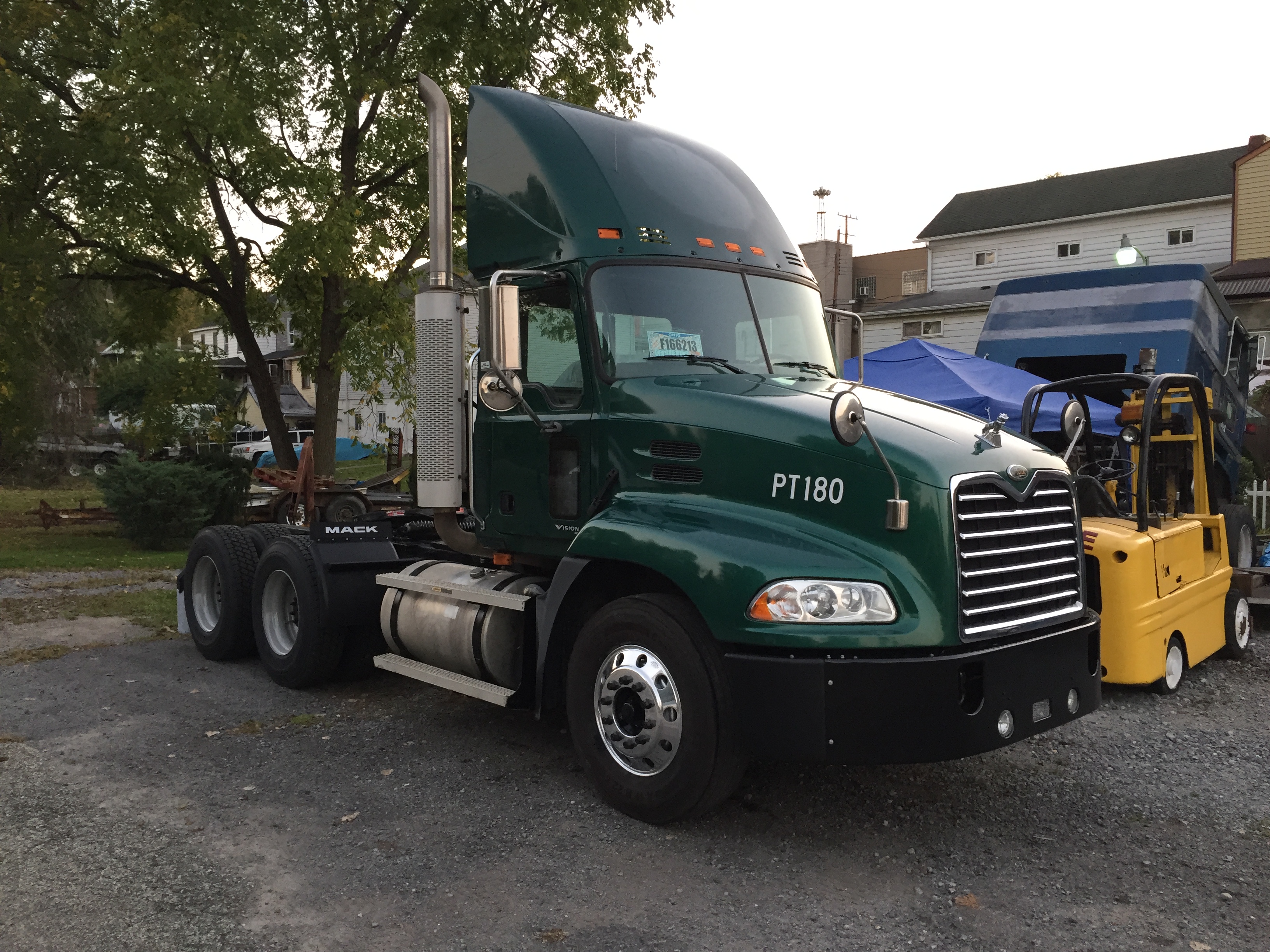

  7. My "newest" one approximately 50' north of where the H-Model was pictured 50 years ago this past summer.

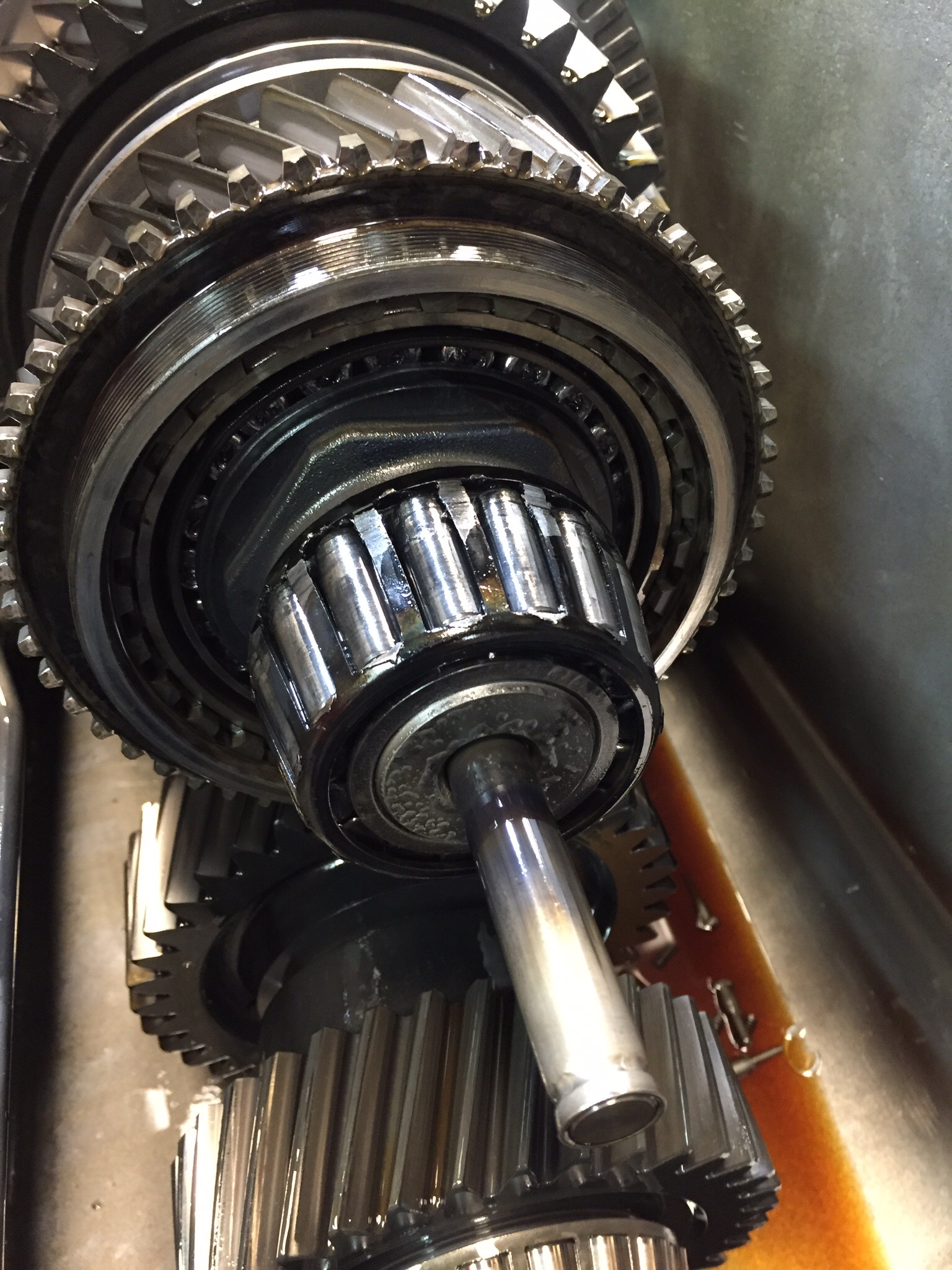

  22. My experience with this problem has been shifter related in that position. When they pop out of the 1/5 position it's usually worn on the beveled edges of the gears and worn on the sliding clutches. A fuller "tune-up" is needed, replacing the gear, sliding clutch, and re-sealing it. The 310 maxitorque with the LL is pretty nice trans. A 10 fuller is shorter in length compared to an 8LL because the back half is longer for the deeper reduction.
