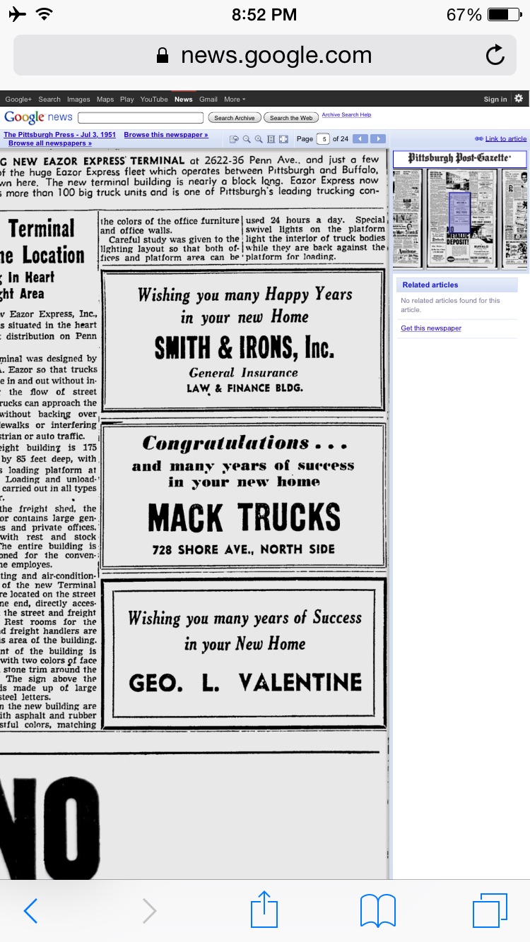

  3. Here's a link to the Eazor terminal getting built in the 50s. https://news.google.com/newspapers?nid=1144&dat=19510703&id=q2IbAAAAIBAJ&sjid=dE0EAAAAIBAJ&pg=1590,924207&hl=en

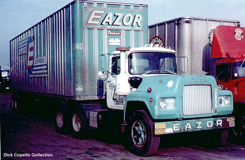

  4. Here are some pictures (credit to the copywrite holder) of Eazors R and F models they ran. At one time they were a big outfit and a big Mack user. I've heard many, not so nice, stories about Eazor. They ran during a couple steel hauler strikes moving steel and were not taken fondly of. Carrying around a rebar for poking radiators or a bottle of Clorox for dumping in fuel tanks was not unheard of and was practiced. I knew some old timers who took part in these activities. I also knew the a driver/mechanic who's task was to go around in Eazor's territory picking up vandalized tractors during that era and pulling them back to Pittsburgh on a lowboy. He always said they could never figure out what seized up those Detriots. The Clorox that's what haha.
