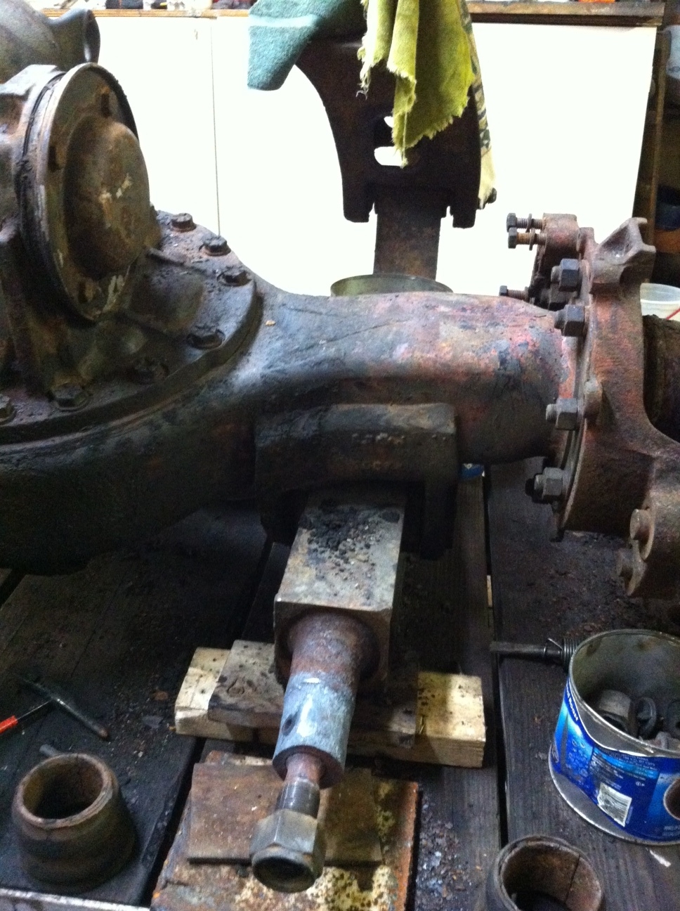

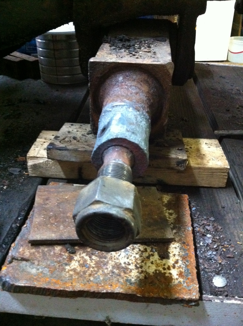

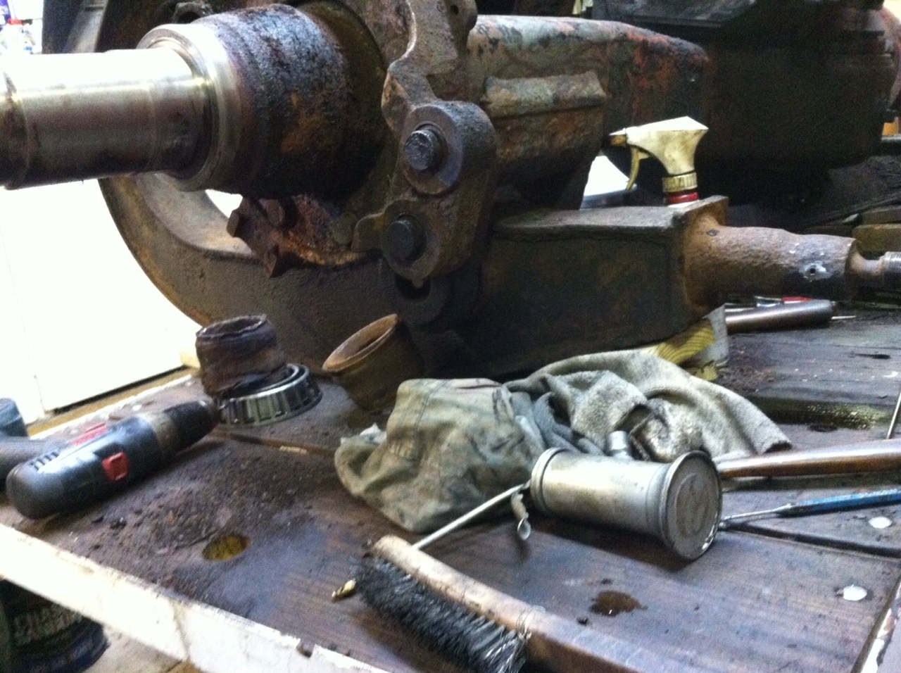

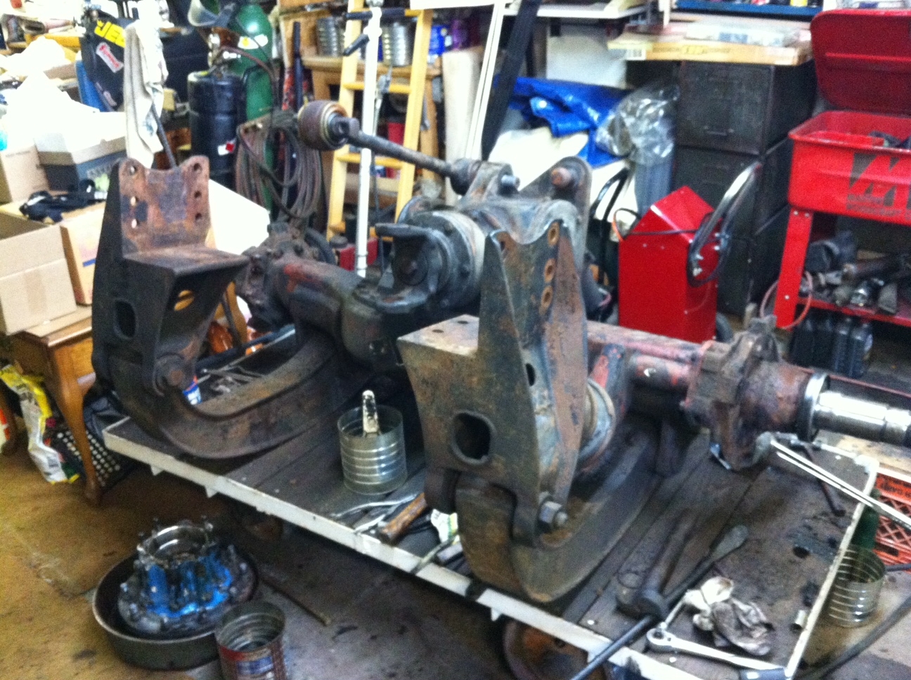

That's good. How does the truck ride since the re-bush on the neway? How did you end up repairing the transverse beam pin where the bushing sits? We just got one set of (both right and left equalizing beam) welded up and ground to diameter. The axle pivot bushing came out with slight ease. We made up puller out of 7/8"x14 all tread and tapped the old bushing to 7/8"x14...seen an OTC Hendrickson axle bushing sevice kit that was pretty much the same thing including the tap. It worked fairly good.

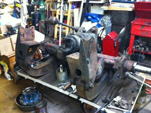

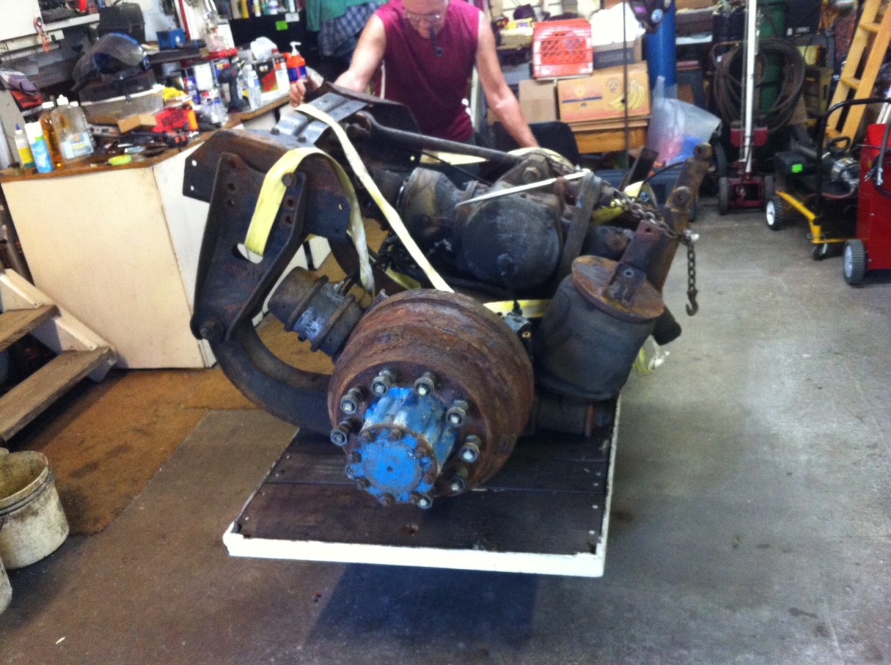

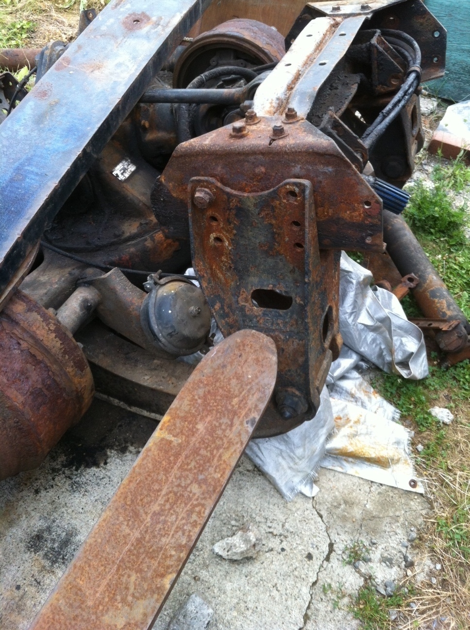

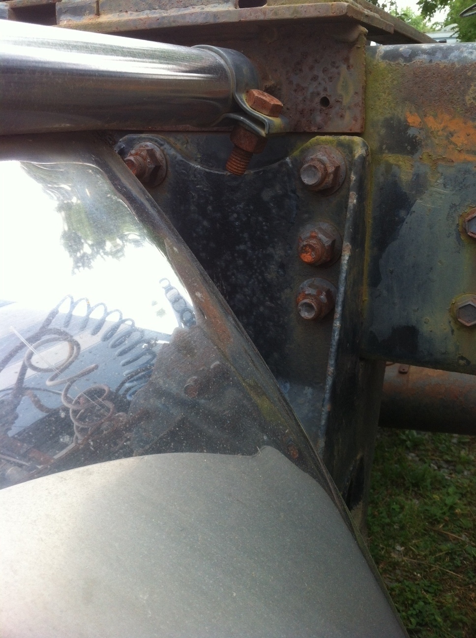

I talked with a local axle repair shop yesterday. I'm going to take equalizing beam to them and see what they can due if I were to weld it up back to size. I also got the pricing back from neway(SAFholland) for a new equalizing beam.....$3065.00 a piece! There would be a month lead time from the factory not that it matters to me. Rob I snapped a couple pics of the hangers on both the 244-6 and the 125-6. The rear hangers on my tandem (244-6) are concaved as well. The hangers on the single axle(125-6) currently in truck are concaved too. I don't know what the reasons as to why they are but my guess is something to due with the location of the fifth wheel? Less notching on different types of fifth wheel frames to go around the brackets maybe?
We must be in the same boat. My pins are wore egg shaped so its time to get "creative" to repair. By creative I mean to repair the pin correctly or replace the arms.
Same here...no luck under the bags for the tag. That's why I had to refer to the charts to identify the different type I or type II parts. The pictures don't help out at all. The existing ard-125 single axle in the truck now has the ID tag riveted on the passanger side hangers not on the bag plate. @rob-It would prob be better just to stick with PG Adams or Ritter (Local Fab Shop) and go with new rails. That way it's less of a pain than messing with a rusty wore frame that would have to be drilled,fitted and or patched up anyways. thanks for the offer though!
You said the frame is shot? What exactly is wrong with it? I know these frames are 2 and 3 piece frames. If the frame is in good shape with no major defects ie twists, cracks or rust out. I might be interested I it? Is the front of the frame drilled to bolt up to the other cruiseliner frame sections or is it just burned off with a torch? Since these frames are in sections I have a few calls into pg adams and a local fab shop for quotes for frame sections to bolt up.

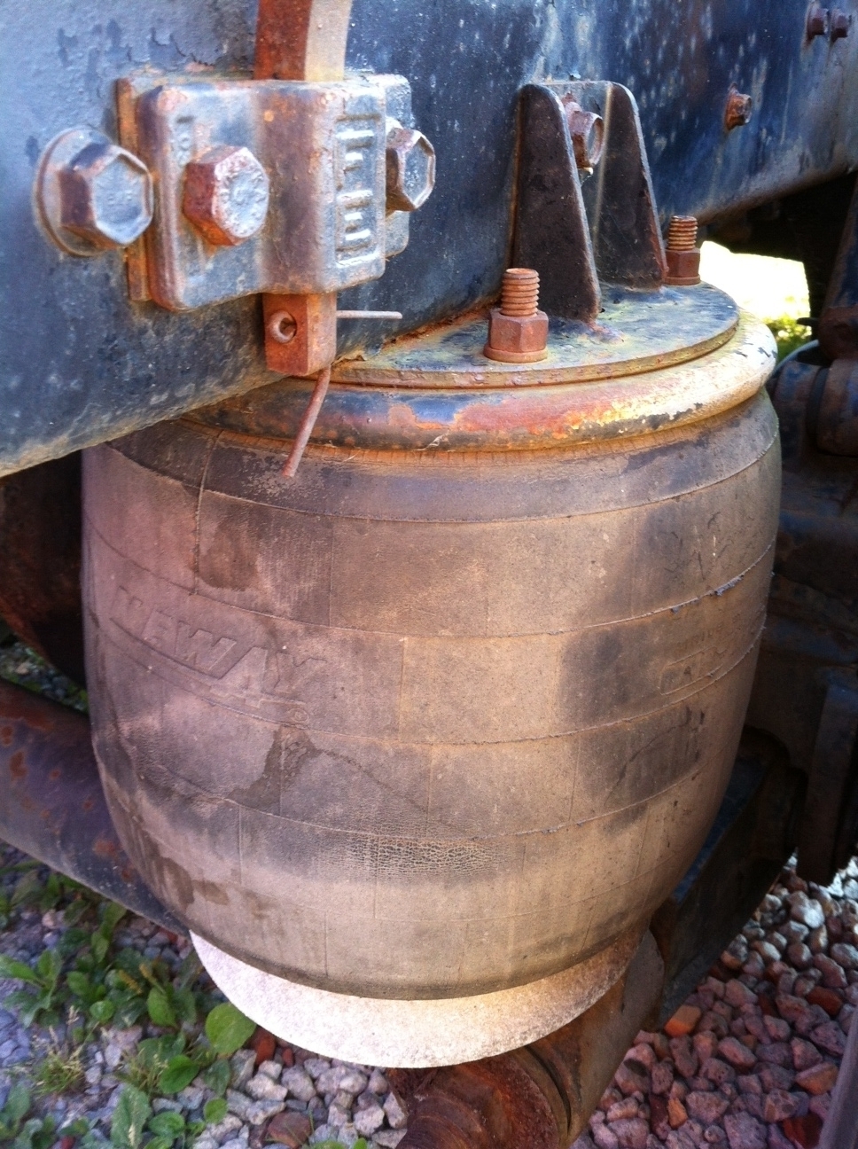

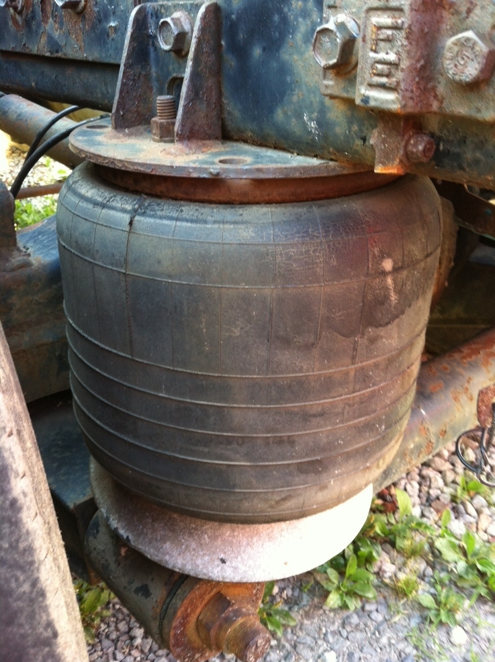

Heres the different airbags. The first picture shows the bag I think would work better with the rounded-over top plate.The second picture has the bag setup thats on the 38k Mack rears. The bags are chaffed and worn near the top from rubbing on the flat flange. This bag isn't too bad but the others are: rusted out top plates and worn bags.
