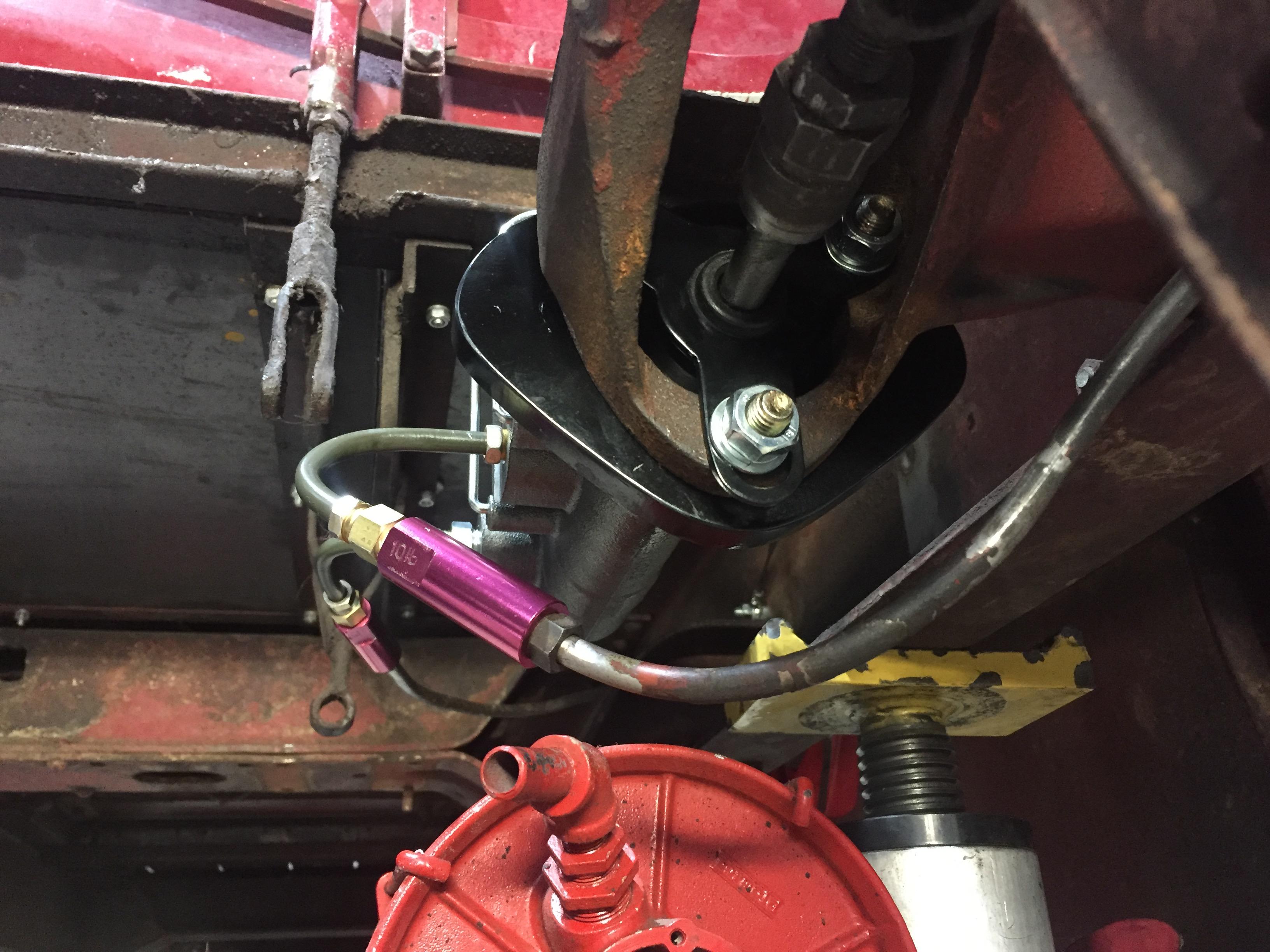

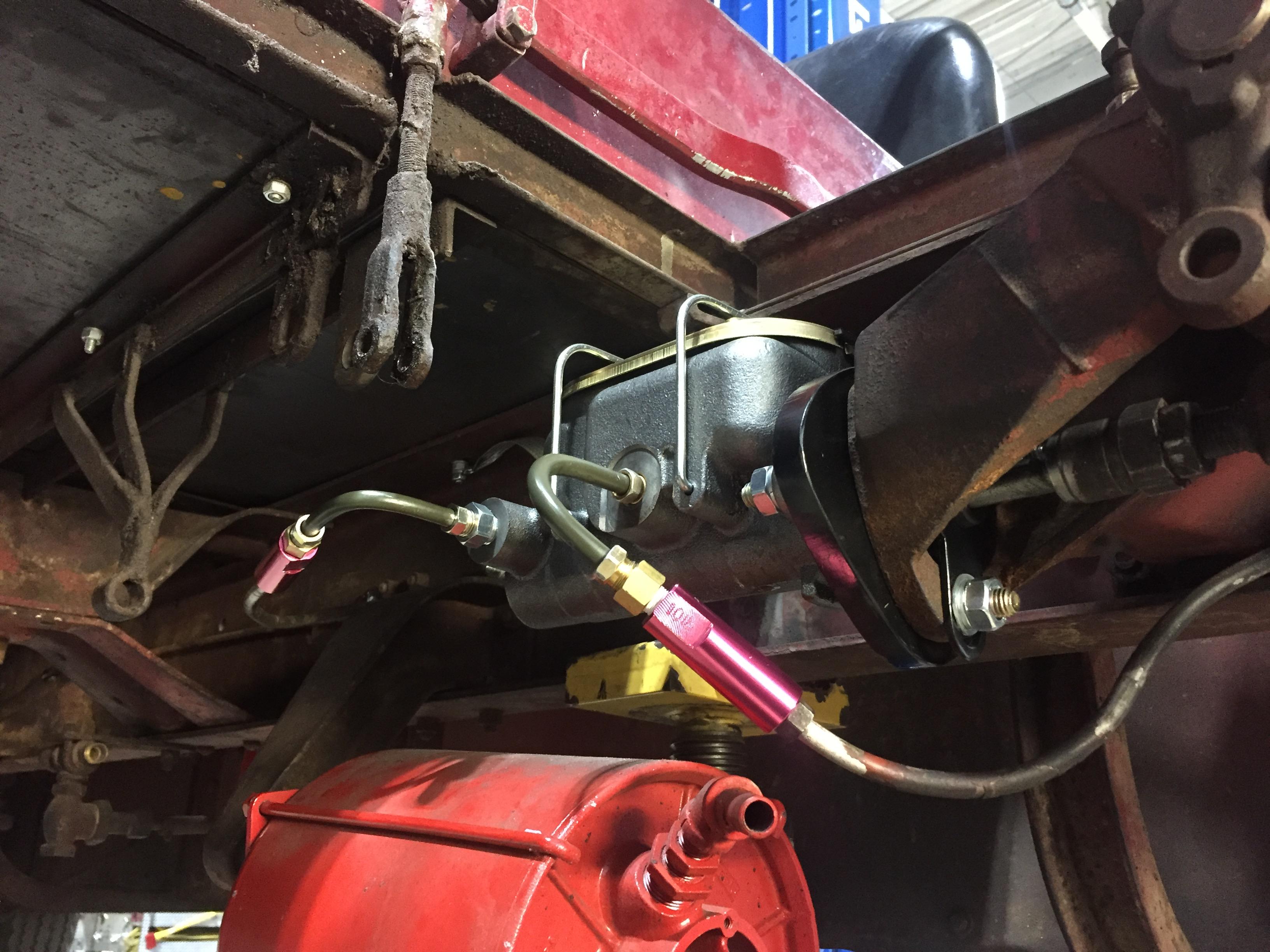

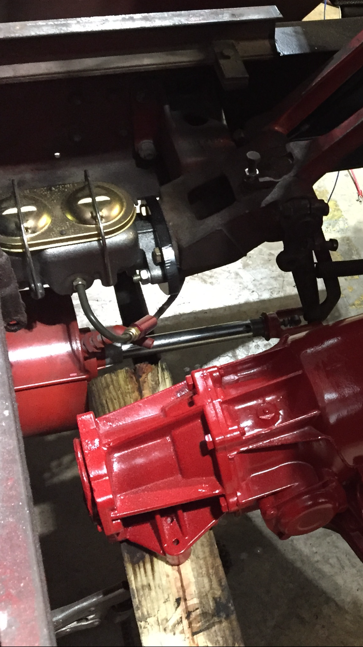

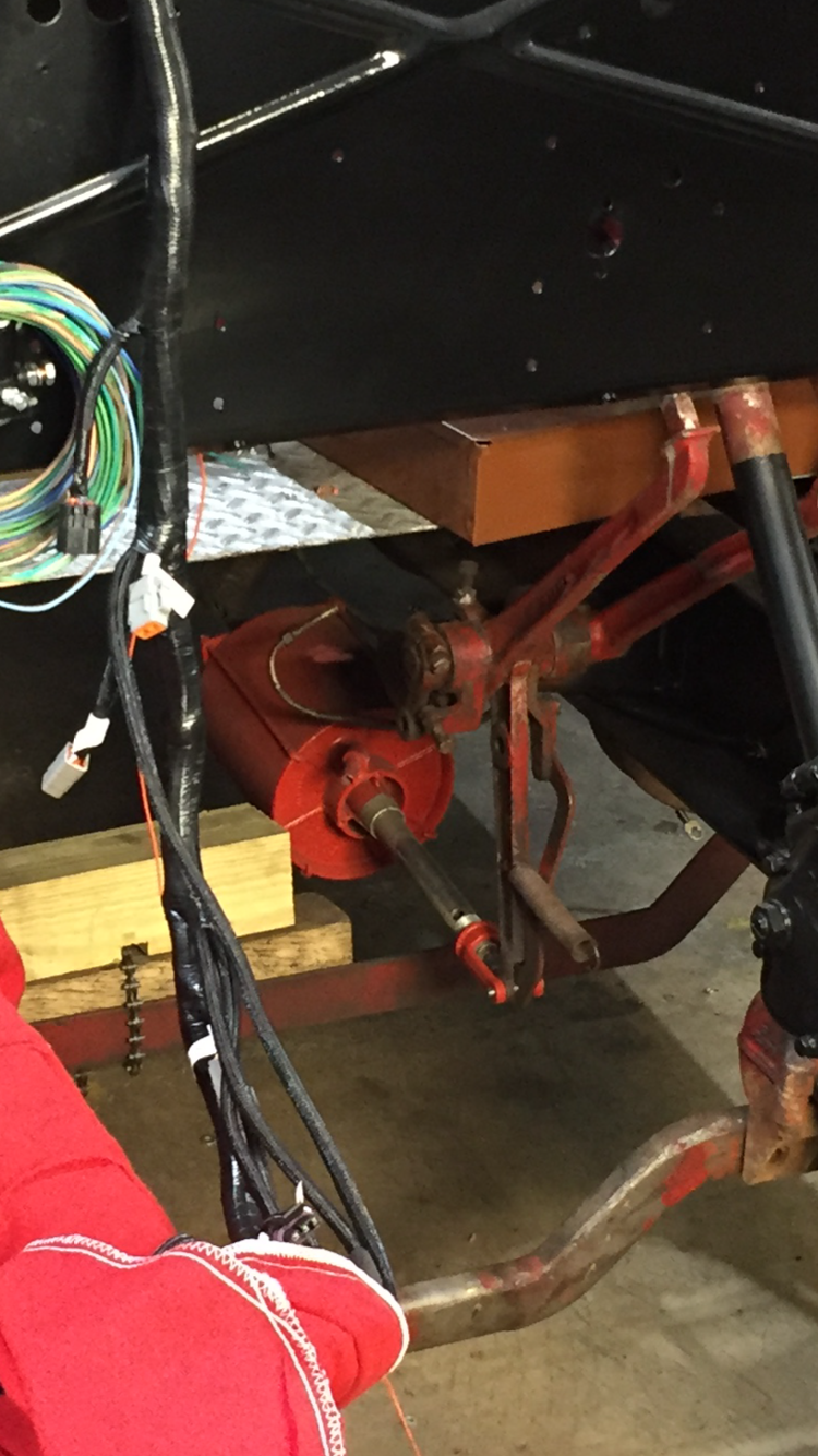

  2. Vacuum boosted hydraulic. I converted it to a dual master.

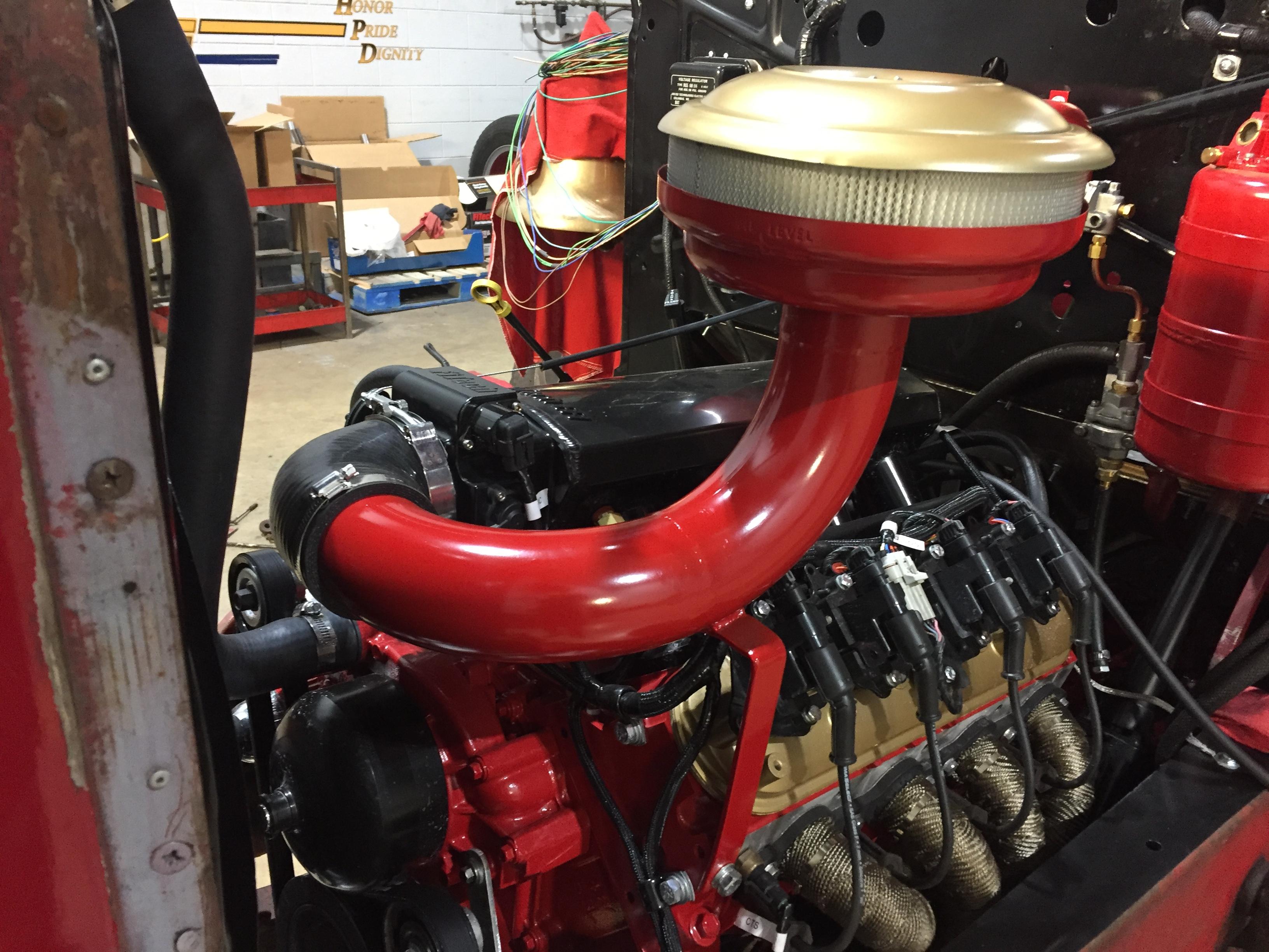

  3. 5.3 LM7 (so its LS family).
  4. I was trying to keep it as “period correct” as possible as far as the engine swap went. A lot of the original pieces either got rebuilt and reused, cleaned or repurposed. I tried to stay away from modern conveniences like plastic wire loom, zip ties, aluminum parts and really anything that didn’t fit the time period.

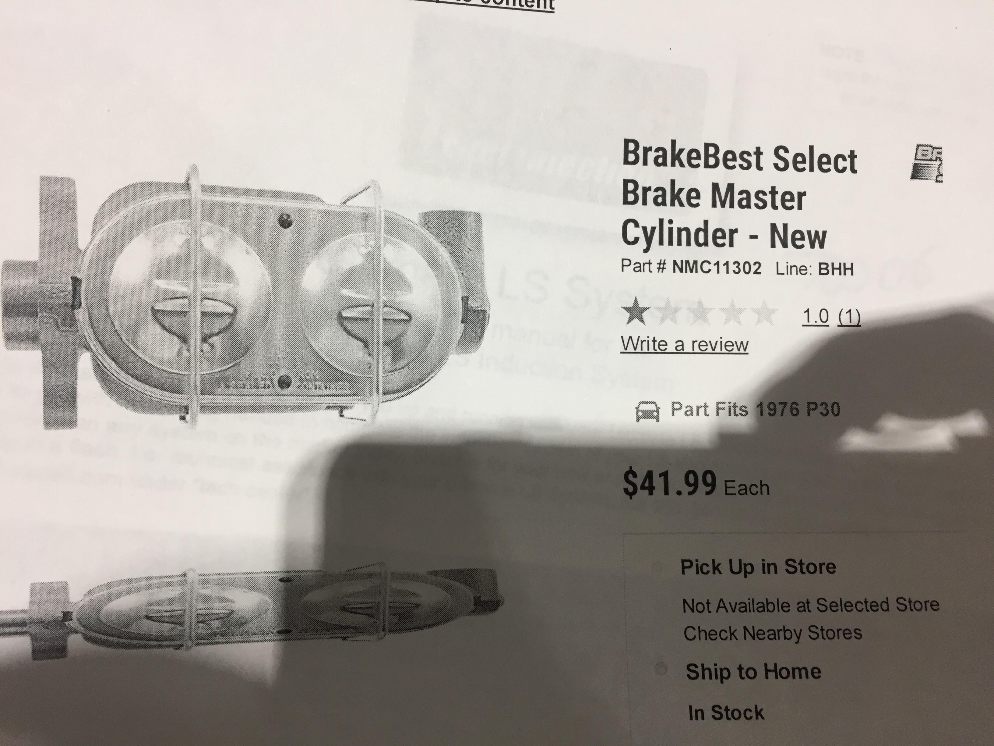

  5. I did not! I’ve never even heard of that. I know where it was stations all it’s life and it’s timeline history but that’s about it. There was a fireman that was supposed to get me a bunch of pics and papers but I never got it before he retired.

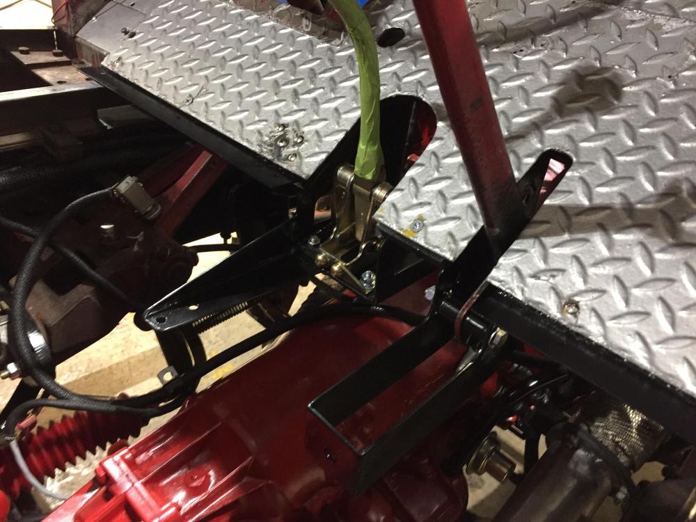

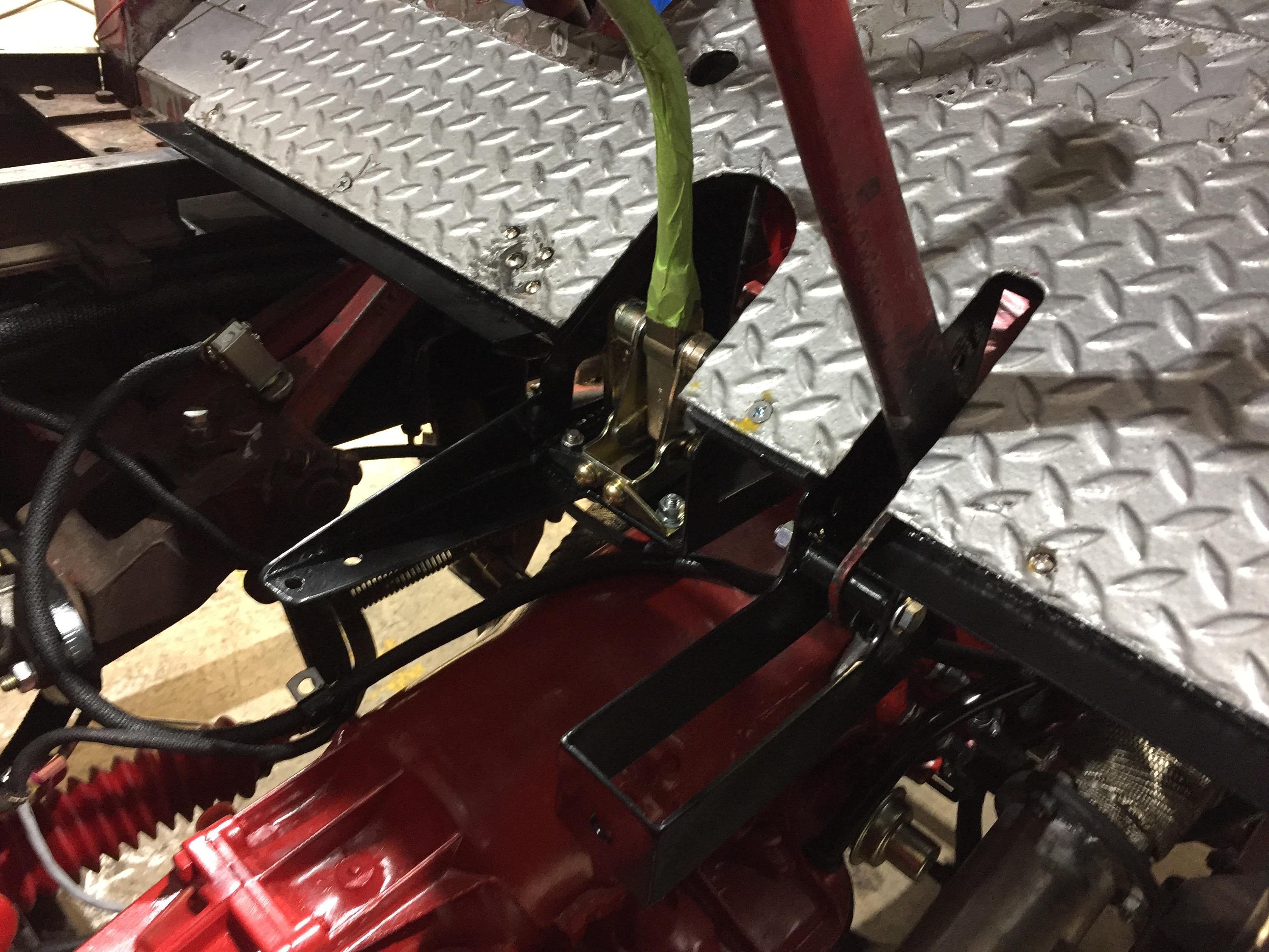

  9. Here is the master cylinder I used. It has the same bore and stroke of the original single chamber.
  10. Thanks. Way safer than the rats nest of exposed wire and wire nuts that was on it when I got it.
  11. Thanks. I did have to make the adapter plate but I did it just with a plasma cutter and basic power tools. I believe the master cylinder is off a ‘70’s or ‘80’s motorhome. It had the same bore size and stroke of the original single chamber. I’ll have to get the p/n when I get to work. The engine is a 5.3 out of a ‘05 Tahoe with a FiTech efi system.
  12. It’s not. Th400 behind a LM7
  13. The booster is a separate vacuum assisted brake booster. It attatches to a mount on the frame and then on the bottom of the brake pedal.
  14. I rebuilt the booster and properly adjusted it. That thing works awesome now. Just by closing the vacuum rod by hand is enough to apply the brakes fully.
  15. It is the booster. My first experience dealing with that particular style. Kind of a bugger to get adjusted.
