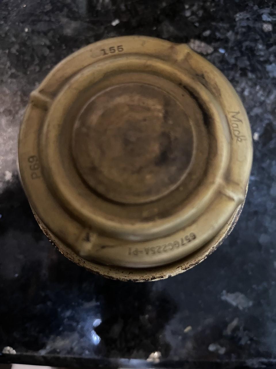

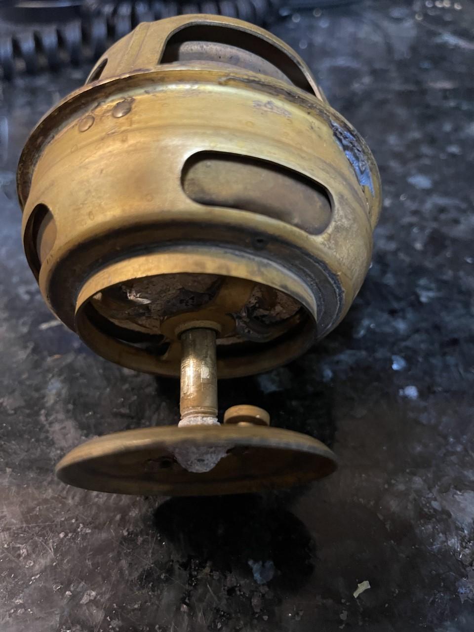

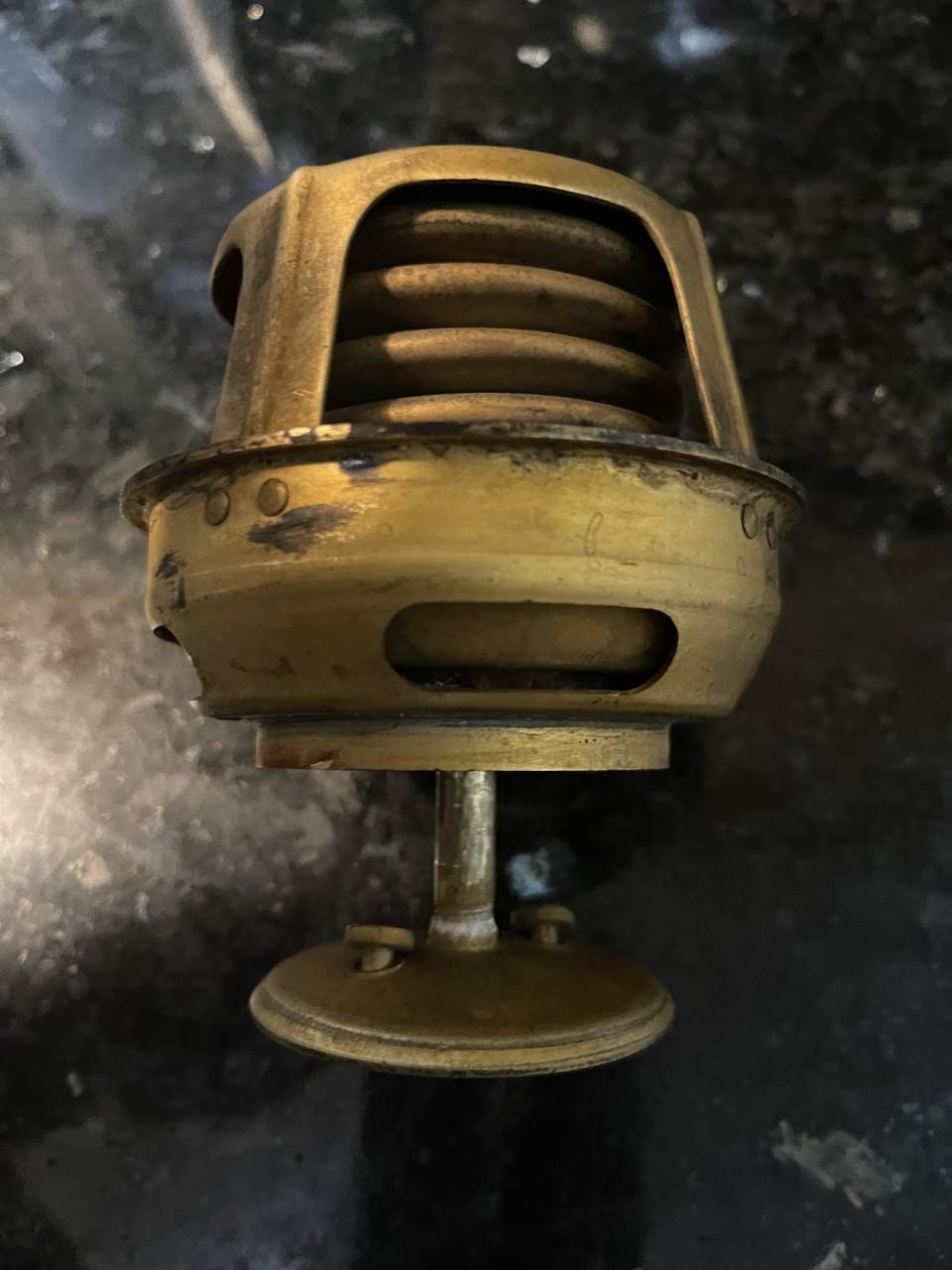

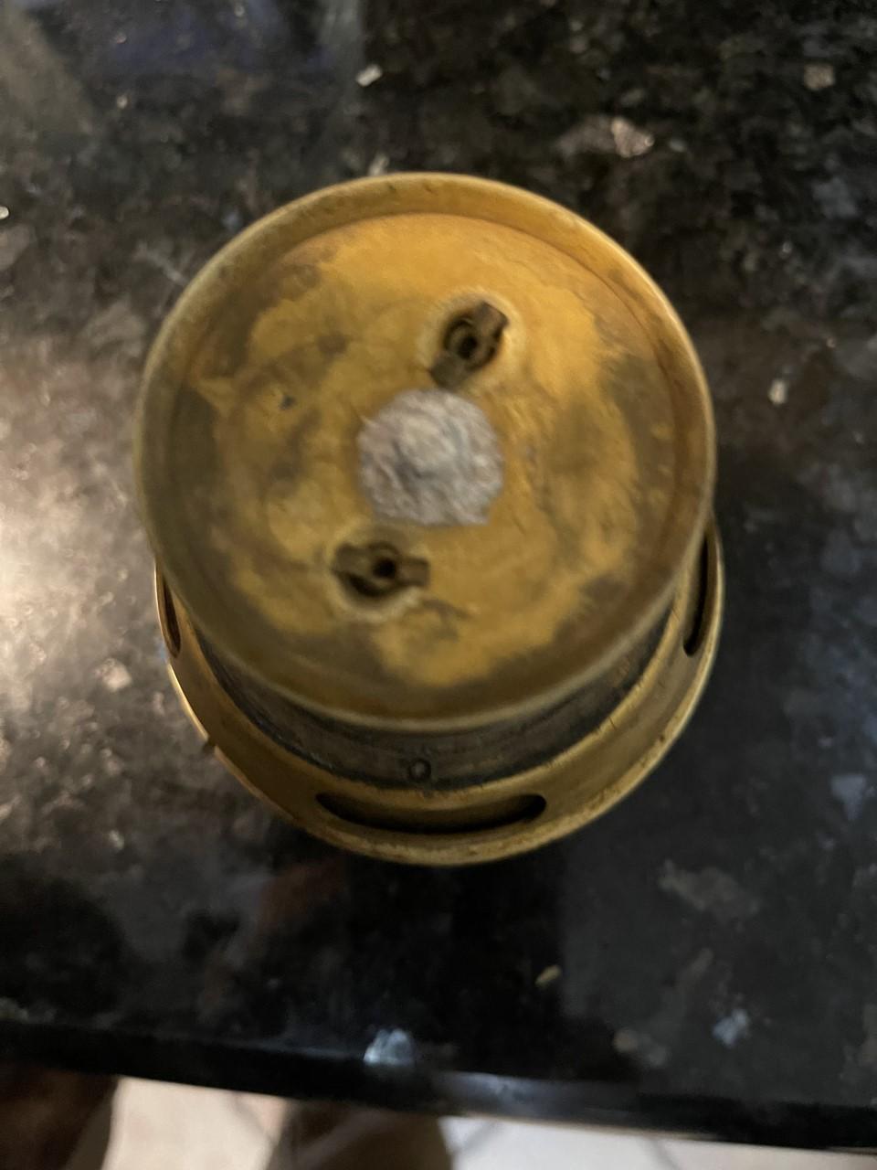

  15. I'm looking for a thermostat for my EN-401 engine, part number is 657GC225A-P1. P69. 155. Any ideas? This is the old one. There is one on Ebay but it doesn't have the stem.
  16. I am still looking for an exhaust manifold for an EN401 if anyone has one.
