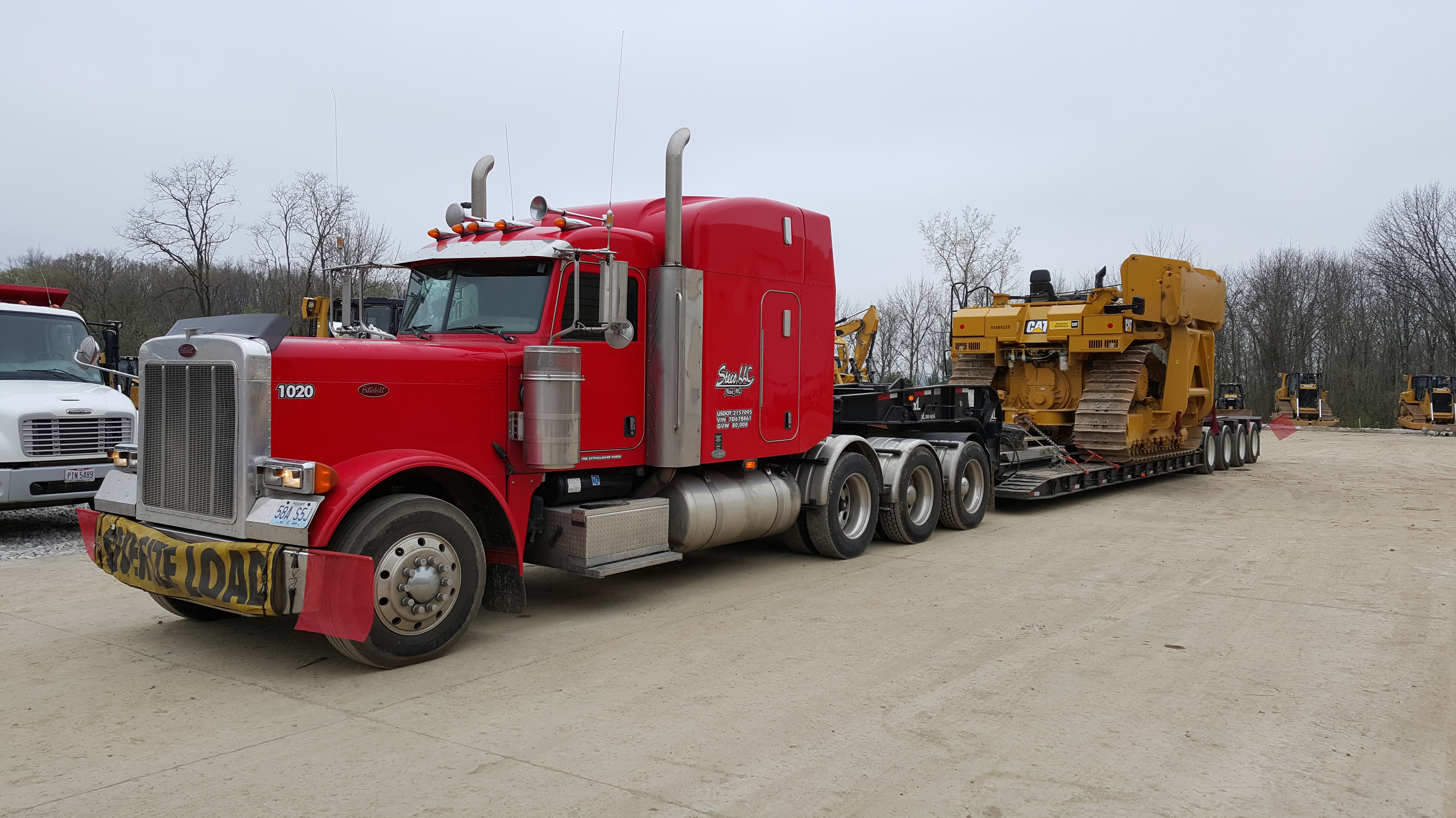

  9. It lays pipe for the oil fiends, it has a big book that goes on the sides
  10. C15 18spd rated 1850trq. This load grossed 149,000lbs. When we had motor custom built for heavy haul, installed a 2250trq clutch, motor dynoed 670hp on the ground. I personal drove this truck 2yrs, never broke it.
