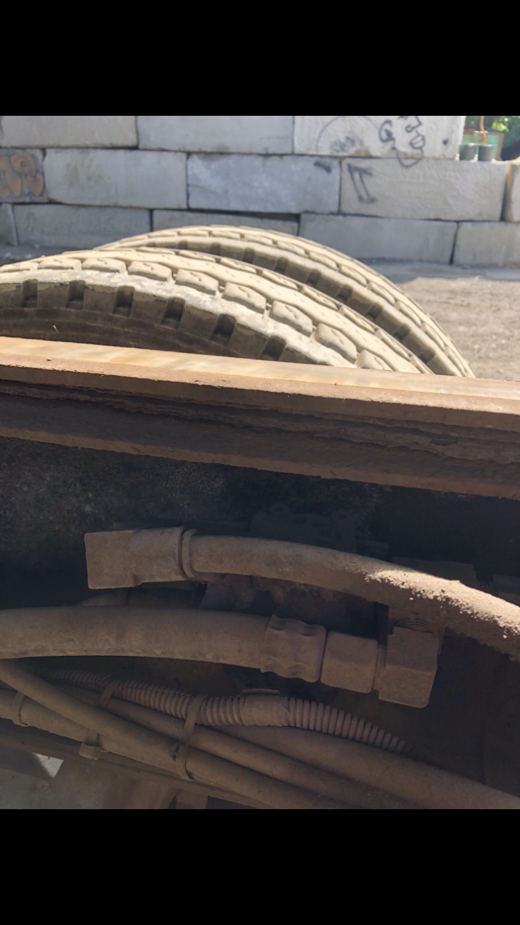

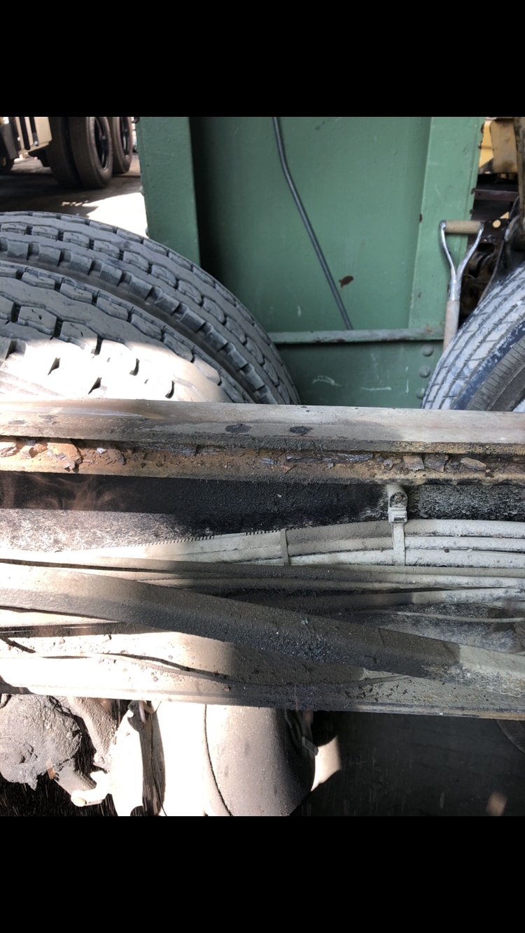

  4. It’s definitely frame related. Took it to someone few weeks ago and he thinks the body destroyed the frame. He thinks the body had so much deflection in it that it caused it to not sit on the frame anymore and the constant pounding of the body on the frame threw it out of wack. Idk it makes sense. I’m fixing the truck a little cosmetically as much as I can and trying to sell it. I have one offer. We will see what happens
  5. Sorry for the late reply, I haven’t been on here much lately. I ended up doing some work on the suspension . Changed springs and insulator pads and bushings and it tightened things up in the back. I’m pretty sure my problems are coming from the frame . I got a lot of flex going on throughout. Area behind cab where hoist for dump body sits as well. We were supposed to sell this truck and the 06 granite and buy a new truck to replace the 2, but the 06’ sold and the 00’ didn’t so we ended holding the 00’ and not buying the new truck yet. Dumbest decision to date. Don’t even get me started On that lol. Gonna see how much longer we can get out of it. We slowed down a lot the past year. We lost 2 of our main contracts and don’t really have the work to warrant a new truck at the moment. Hopefully things turn around soon.
