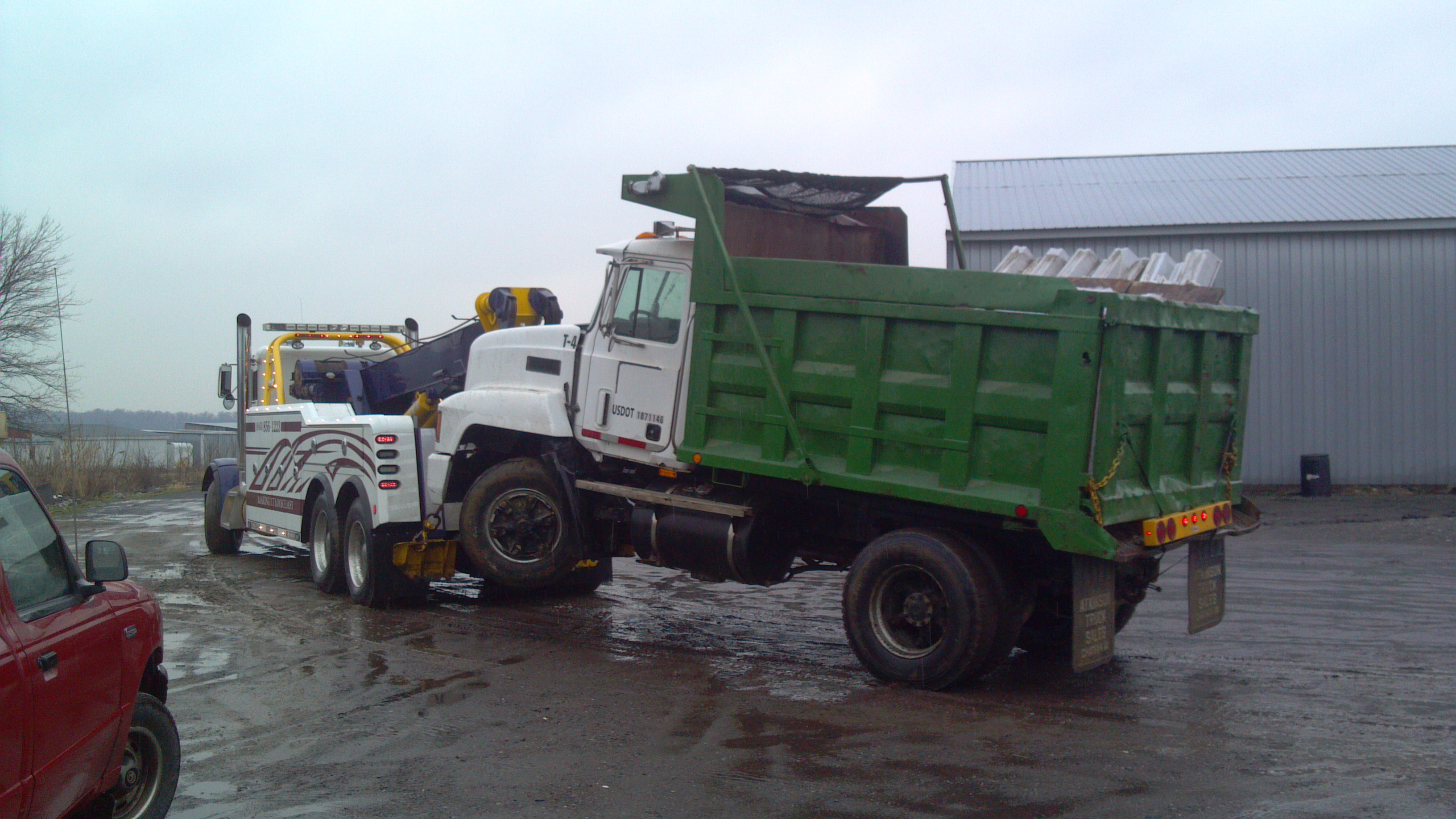

  3. The engine cranks normally. I have fuel to the injection pump. When I turn the key on, everything seems normal. The engine warning light proves out within 10 seconds and I can hear and feel all the relays click in the dash panel. I have looked at the pump but I'm not sure where the cutoff solenoid is. I found the injection timing actuator and the "cam" sensor.
  4. You wouldn't happen to have a link to that TSB would you? I've been having no luck with Google. Tons of hotrod Cummins B series info though! Edit: Also that sounds like the part I checked. It has both power and ground with ignition on. Tapped on it with a screwdriver handle thinking it might open.
  5. Anyone?
  6. I think I posted this in the wrong gateway so I'll post it here. I'm looking for the shutdown cutoff solenoid location on my E7. I think mice may have got a wire. Can anyone help me diag my no start?
  7. My truck is a 1992 CH-612 with a dump body. It has a E7 300 and road ranger 9 speed. Can anyone tell me where the fuel shutoff solenoid is on the injection pump? I think it's stuck or not getting power but all I can find on google is how to make your 12v Cummins faster!
