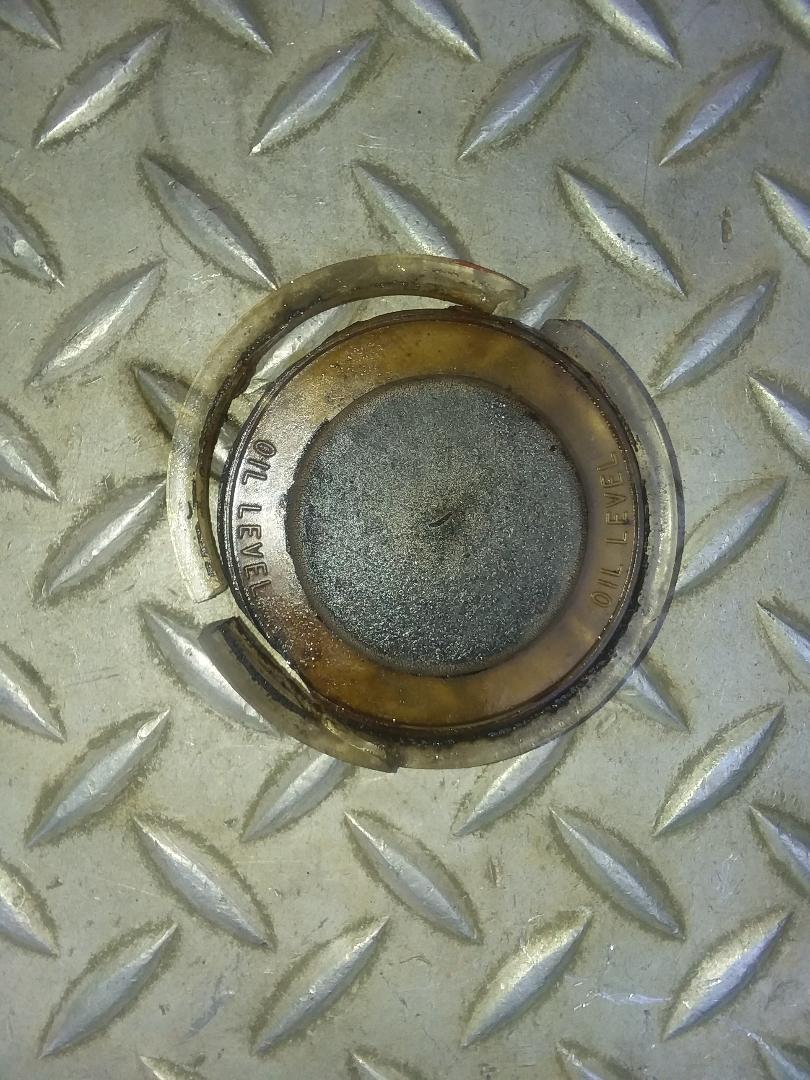

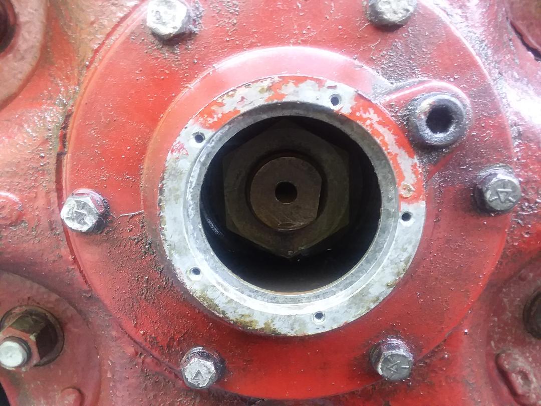

  1. Removed Stemco oil window.

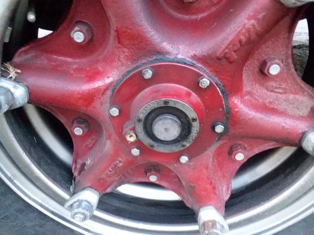

  2. It appears neither side of the inside oil seals are leaking. When I first noticed a leak earlier in March it was on the right side. Currently the left side has become noticeable. It appears the right side leak was reduced or eliminated when I tightened the six bolts holding the Stemco on to the hub. I can't remember when I tightened the right side if I did the left while at it but I'm 99.9% pretty sure I did. The leak on either side has only appeared or shown evident on the outside of the hub with no signs of oil behind the wheel when inspected. If it is just a matter of replacing the Stemco hubcaps, I'll give that a try before pulling the entire hub assembly apart. It seems like the easiest solution at this point to just replace the Stemco. I can see how oil instead of grease could be problematic. Switching to grease might be something to consider but right now I'm not prepared to take on disassembling anything further if the Stemco is the only issue causing oil to escape. I’ll do the left side first for now to see if the problem is remedied. Until this issue was brought to my attention, I've only known front wheel bearings to be packed in grease. I was not aware of oiled front wheel bearings. That was the cause for my initial query to the forum. I didn't want to tear into something I was unfamiliar with causing a bigger issue. Edit: After a closer look this afternoon I found the problem. The plastic window is brittle and most definitely CRACKED.
  3. Still leaking and I guess I'll be replacing the Stemco hubcaps.

  9. This past Saturday I salvaged an air tube and air box off a 1976 CF-600. I need to get a new air filter, clean it up and recondition the parts before I install it. I have to figure out how to preserve and protect the rubber hose from further deterioration before putting it on the truck. When I bought the truck the original rubber air tube had fallen off the turbo to the air box and it was laying on the exhaust and burnt beyond use. I put the air filter shown on the truck as a stop gap while I hunted down parts to replace what was damaged. I agree no need to suck hot air but hot air is better then dirty air and running the truck without a filter at all. Baby steps towards bringing the truck back from extinction. Like I said the maintenance was neglected before I purchased the truck. The previous owner was a hack. The truck only has 37,000 original mile on it and I figure it is well worth my efforts to save it. It was kind of rude and ignorant the way it was kept prior to my purchase.
  10. The truck is equipped with a canister coolant filter as pictured circled in red. I was unable to get a replacement new filter over the counter because they have been discontinued for years but I found a few new unused filters on eBay. I changed the filter while the coolant was completely drained to install a block heater. I removed the entire canister off the engine and cleaned it thoroughly. It was loaded with scum and scale. The removed old filter from the canister appeared the be original. If it was not original it was an original design canvas and tied bag type filter. The new replacement filters I bought on eBay are made of galvanized steel. I had used the truck sparingly prior to the filter and coolant change but I did not notice the engine temp go much above 180 degrees. The coolant change apparently stirred UP the blank because one of the disconnected cooper lines that lead to the removed fire pump auxiliary heat exchanger sprung a leak where there was no leak before. The 200 degree engine temp draw some concern because I never seen the temp go that high before. I just keep an eye on it for now to see where it might lead to or turn up in the future. I might just my ADHD or OCD over reacting to nothing.
  11. I have a CF-600 that has the pump and body removed that has been converted into a flat bed / ramp truck built for hauling vehicles and equipment. I've been working on getting the truck road worthy since its conversion to civilian life. The truck was somewhat neglected before I purchased it since it was retirement from fire service. I most recently changed the oil and coolant and added a block heater. It has a remote oil filter canister and when I changed the oil it had the wrong filter. Been chasing down stupid stuff like blown and worn oil and coolant lines. Trying to get comfortable with the truck to make it reliable and dependable. Next issue will be chasing wires to fix some electrical issues. In the meantime yesterday I used the truck to pick up an air compressor tank for the shop. The round trip was 150 mile the furthest I've driven the truck since I've owned it. It has a ENDT675 engine. I ran the truck up against the governor on the interstate at 66 mph on the flats. It pulled hills and long grades and it did not back down below 60 mph. While pulling long grades the engine temp got up to 200 degrees. Back on the flats and off the throttle hard with the shutters opening and closing the temps stayed a consistent 180. While idling at operating temperature the oil pressure was 45 PSI and up against the governor (full throttle) the oil pressure rises to 70 PSI. What I'm experiencing with the coolant temps and oil pressure would that be considered normal?
  12. Okay, that makes senses. Thanks.
