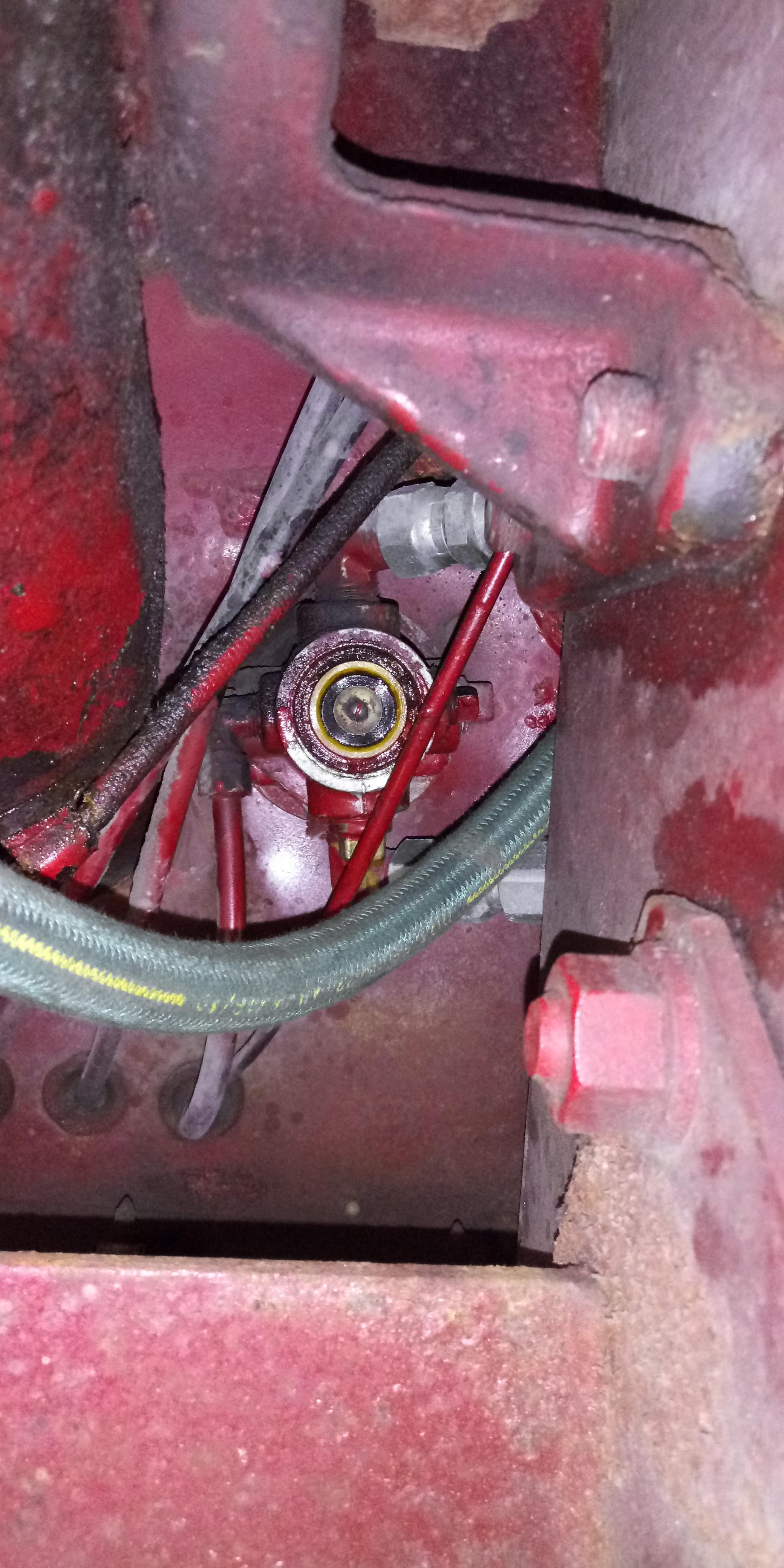

  2. The floor DOES NOT come apart. It is going to be a mess. It looks like I am going to have to be a contortionist AGAIN to work on the truck. The valve will have to drop out the bottom. Nothing but fun owning a CF-600 Cab. Everything was assembled around everything else in the way. I haven't found anything that can't be done but nothing is done the easy way. I'll have to get the valve out the bottom from under the cab to at least see or get an idea what's going on. I've already done a lot of rust repairs to the floor on the truck when I installed an air seat. I might do some more hacking and cut in the area around the valve when I get it out to make it easier to reassemble and to gain access later if the valve ever needs to be replaced again . Do you know anyone who can weld? Thanks for the help.
  3. I've been doing some searching around on the internet. I found lots of choices for complete (new) valves. Just as well replace the valve completely. It is going to be a PITA (wrestling match) to get the faulty valve out. I don't want to do it at all but if I have to do I don't want to do it twice. Question: was there a standard (part number) valve Mack used on their air brake system?
  4. I have an air leak on my 1972 CF-600. I found a few loose fitting today and tightened them up. It got better and I thought I had it figured out but still had a slight leak. I figured good enough. My son walks by and says you have an air leak. No shi_ Sherlock. He says I can hear it. It's coming from the drivers side under the cab. I've been trying to track down the leak for a few months. He crawls under the truck and in less then 5 seconds says what's this. I take look and it turns out to be the Foot Brake Air Valve is leaking. The valve and around it was filthy. I spayed it with WD-40 and cleaned around it the best I could. Still leak. My question is, are Foot Brake Valves rebuildable or do you just replace them? Looks like it could be rebuilt. It's not in a good or easy spot to get to. I don't want to do it once let alone twice.
