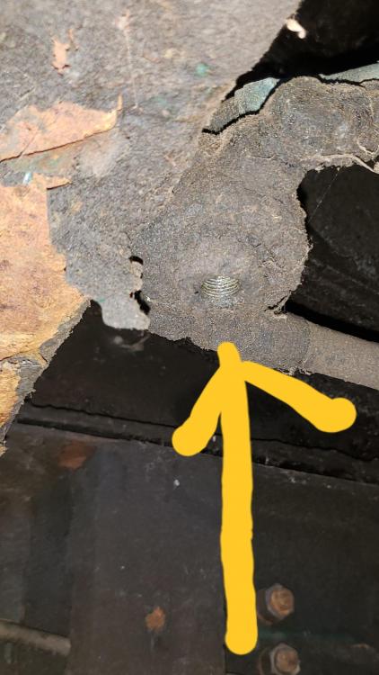

  3. Yes feeds brakes. I put an air line from the house compressor to check the air system and it was leaking from this spot instantly
  4. I have an air leak from this hole. What is supposed to be in there? Can I plug it?

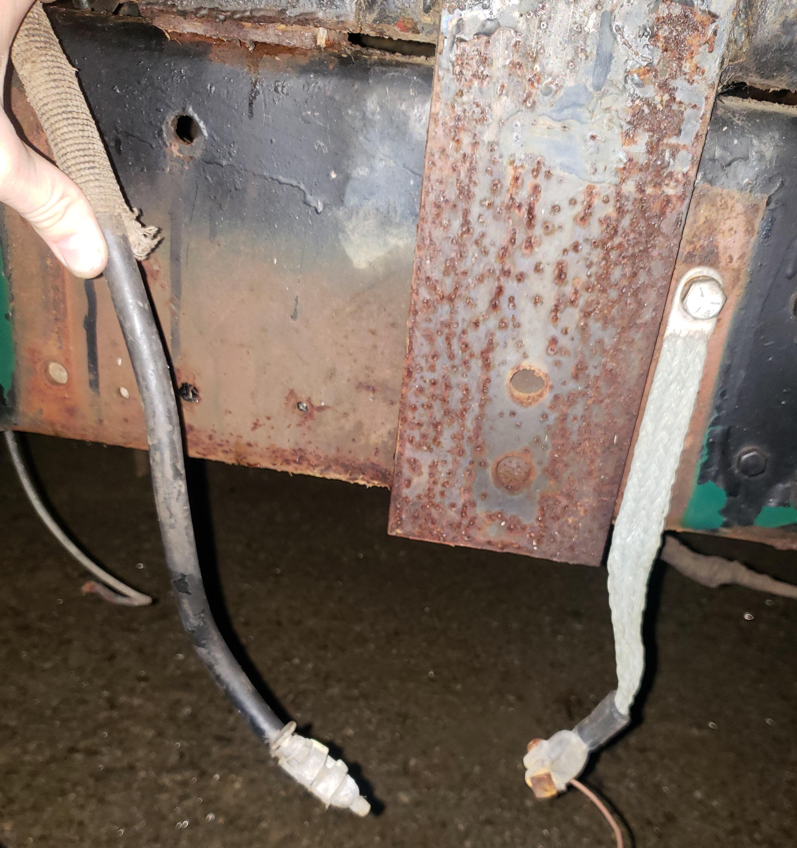

    Ok the cable that goes to the starter is not labeled or marked. The cable that goes to the frame is a silver strap. There were no batteries in the truck when i got it.
