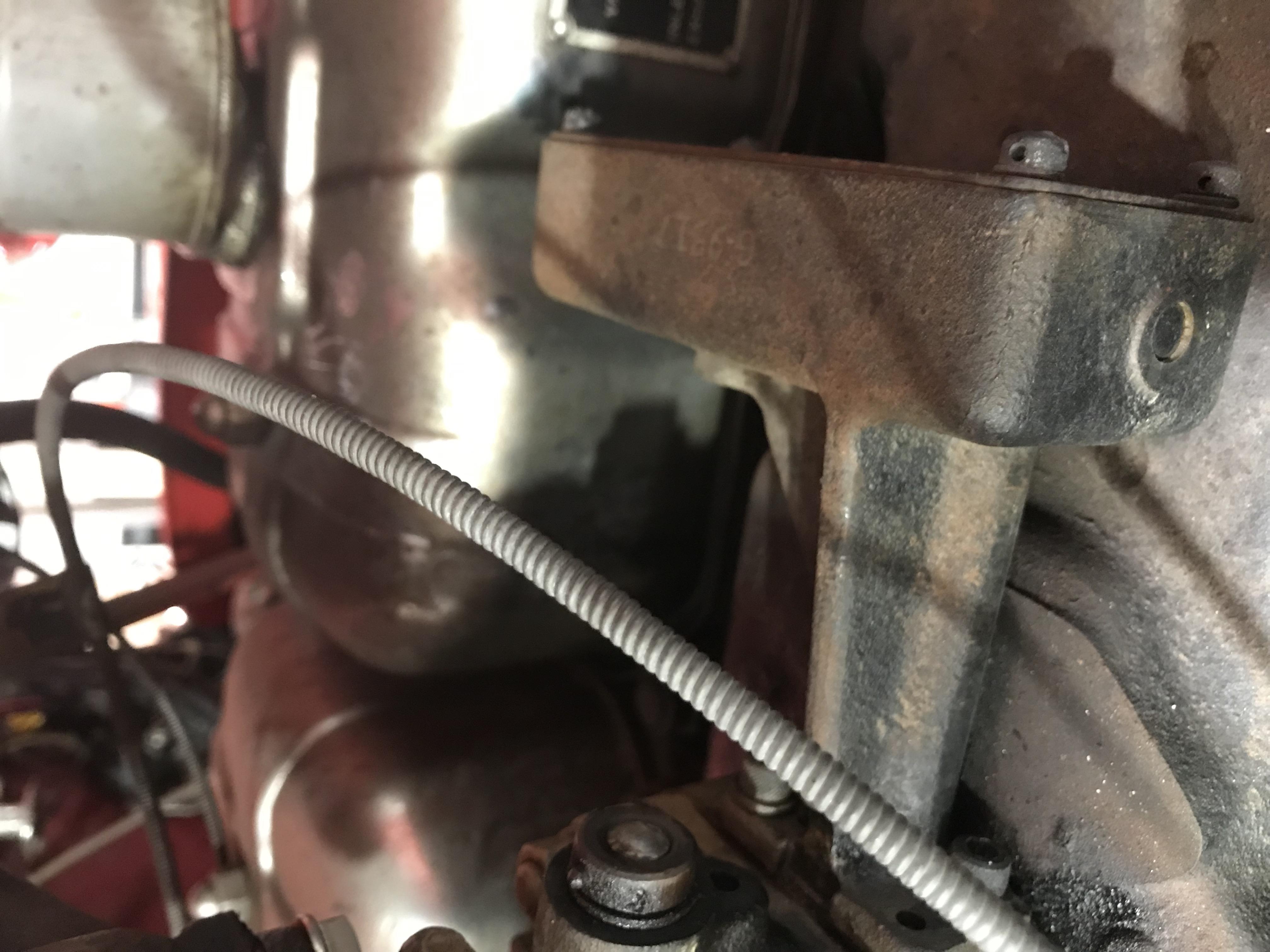

  3. Someone on a B Model page said it was a Vacuum Operated Governor? They pointed out that the screws have security holes in them, I haven't taken the front plate off yet because I didn't know what if anything could possibly come popping out on me....lol....that's my luck

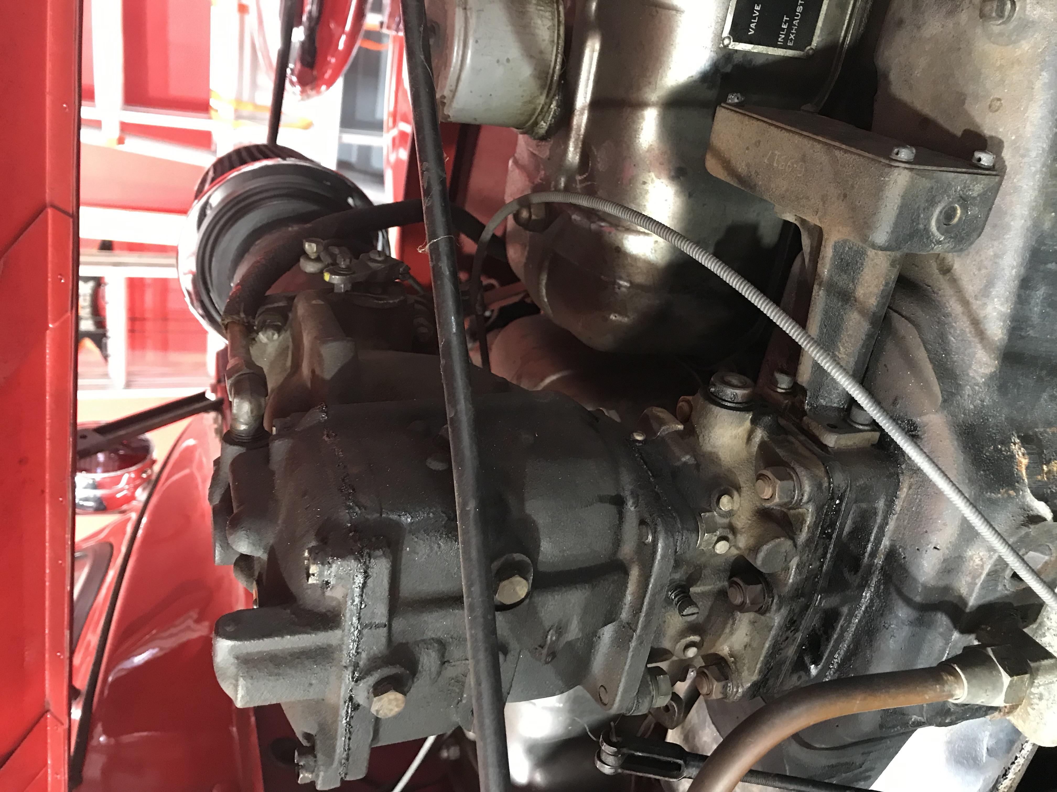

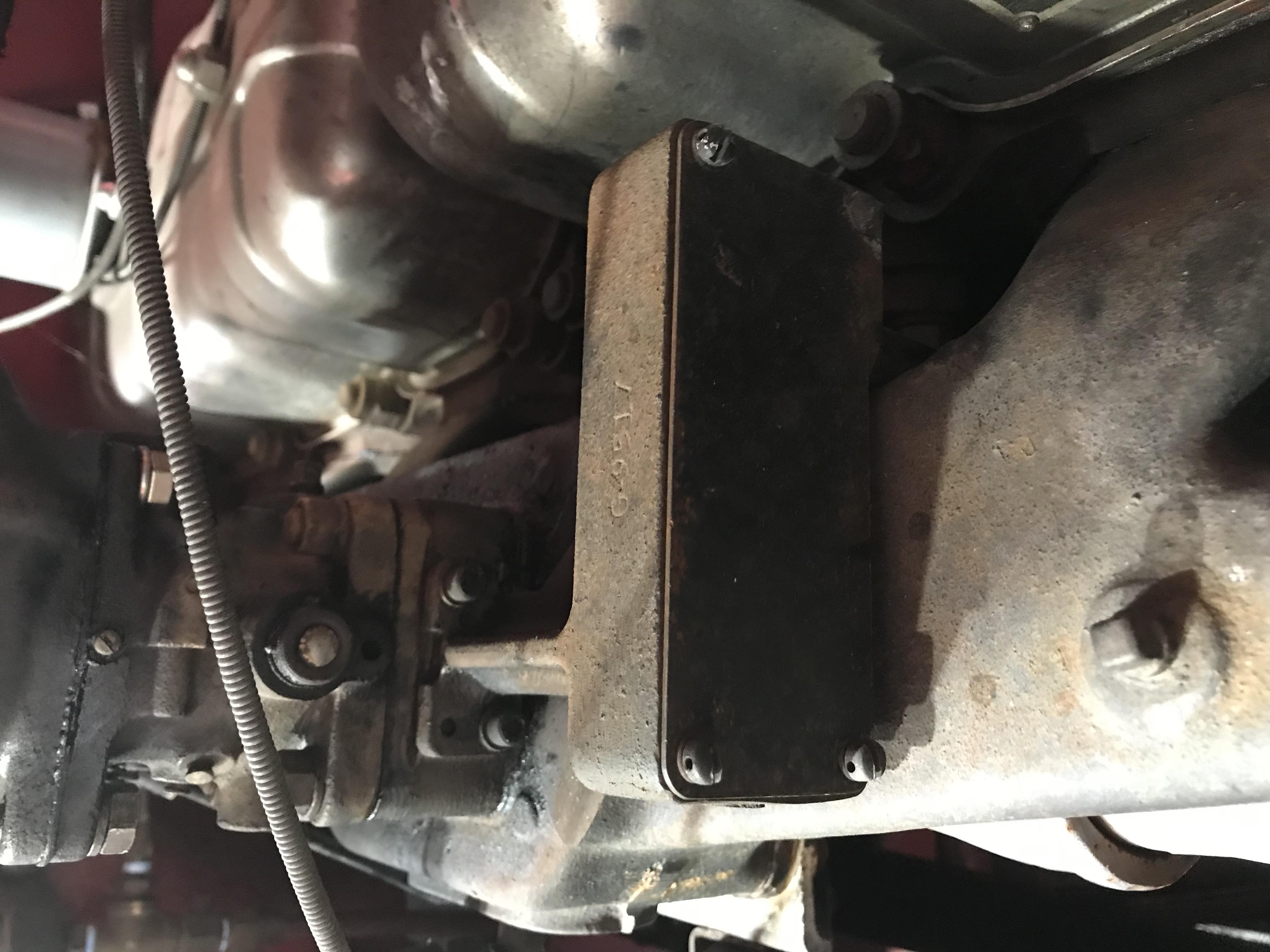

  4. Does anyone know what this rectangular box is at the base of my Zenith Carb. there is a copper tube that runs down to the exhaust manifold. I was wondering if it was some kind of automatic choke valve.... once the motor heats up maybe a spring or something opens in base of Carb???
  5. Does anyone know what this rectangular box is at the base of my Zenith Carb. there is a copper tube that runs down to the exhaust manifold. I was wondering if it was some kind of automatic choke valve.... once the motor heats up maybe a spring or something opens in base of Carb???
  6. Thank You All, I'm going to look into that Tomorrow
