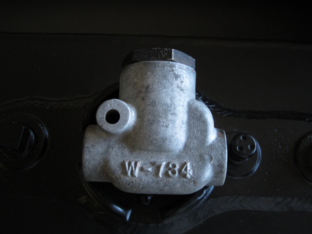

  5. only two ports not a check valve does not hold air in ether direction but seems to limit the air a little when air is put in the direction it was installed does have an arrow took valve apart has big long spring metal disk and in the bottom there is another chamber with a metal ball this valve is in the line from the bake valve to the relay valve for rear brakes this trk does not have front brakes
  6. does anyone know what this valve is and what it does
