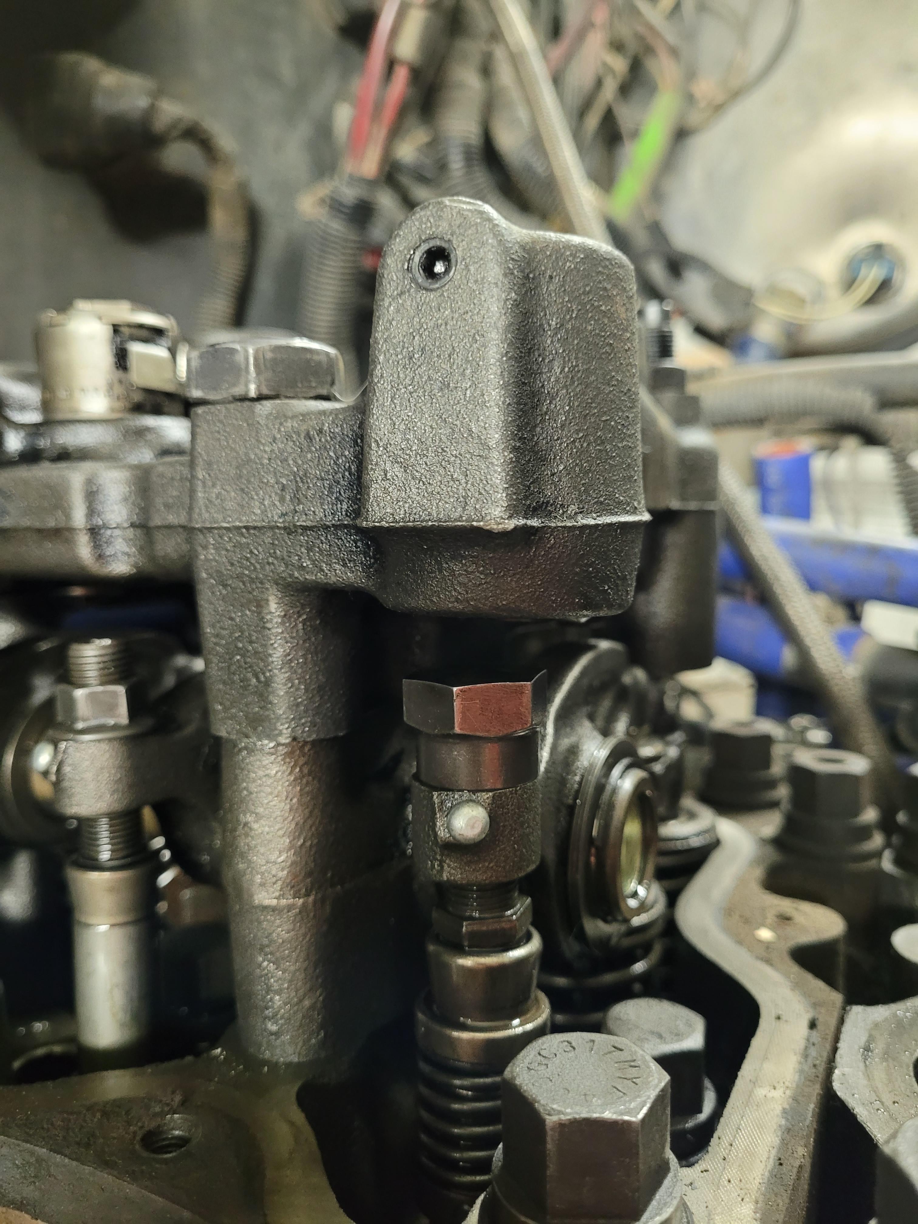

  1. Sorry I miss stated I didn't replace cam. But removed rocker arms and the shaft that pivot on... the rocker arm assembly.... Jake brake assembly. I didn't go that far into the engine...
  2. I don't know about ceramic lifters. Other than it was rebuild about years ago. Yes picture is of number piston. I have not done anything with the exhaust valves yet. I was measuring each exhaust rocker clearances. All are very close to the .35 gap... I haven't done anything with bridges yet... I'm just trying to get started... without a f up.
  3. I had to replace ejector. Now I'm trying to adjust exhaust valve gap. After replacing the cam and Jake brake assembly. With the spring loaded push rods collapsed each exhaust rocker to top of yoke is .365 yes. .365 gap... before I do anything help... I'm 5 hours from a mack dealership...
