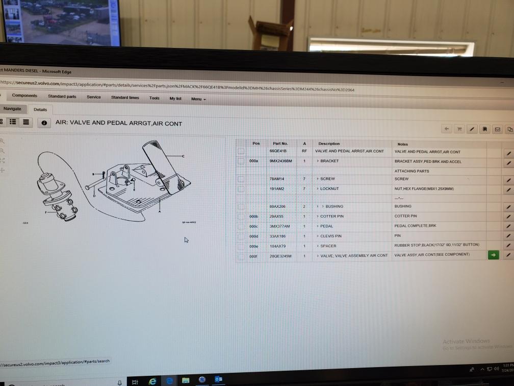

  2. I've got an '84 Mack MH613. A couple days ago the brake valve under the foot pedal broke off where the three bolts hold the assembly to the floor of the cab. I've checked around a few places and so far i've been told that nobody can get the part and it's discontinued. I've attached a diagram below. The piece that's broke is on the top left, with the three bolt holes. It's the casting piece that contains the plunger. That piece bolts between the actual air valve and the cab floor. Does anybody know of a place where I could order this? Or possibly a junk yard/used truck that has one? Or, if it's impossible to find, is there a way to swap out the entire brake pedal assembly to something more common? Thanks!
