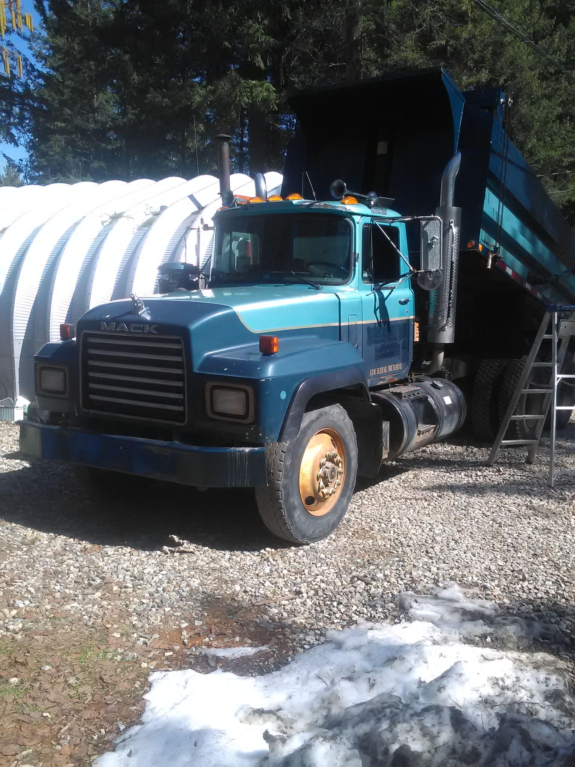

More than a year later.. Love my Mack !!! I custom fit a new front bumper and sanded and painted the truck. Coolant problems are over as I keep the overflow bottom canister empty. It runs awesome except for smoking puffs of blue smoke when using the engine brake.. Anybody knows what could cause this? I'm also still looking for a 20.000 lbs front axle. Would an axle from another brand truck fit? Thanks for your input. (Current job 2 weeks into the mountains up and down a 10-15 mile logging road. Hope my baby survives this.) 🙂 -

Thanks for your help ! Yes I run it now with the overflow tank with a little bit of coolant in it. Regarding the oil splash when on a very steep grade that makes sense. Below a couple of pictures of the start of making the truck look nice. I'm still looking for interior parts and in the future I like to get a heavy duty front axle. Hard to find parts here in BC. Next is fabricating a beefy front bumper. I will let you know how the truck is behaving. Again thanks ! -
