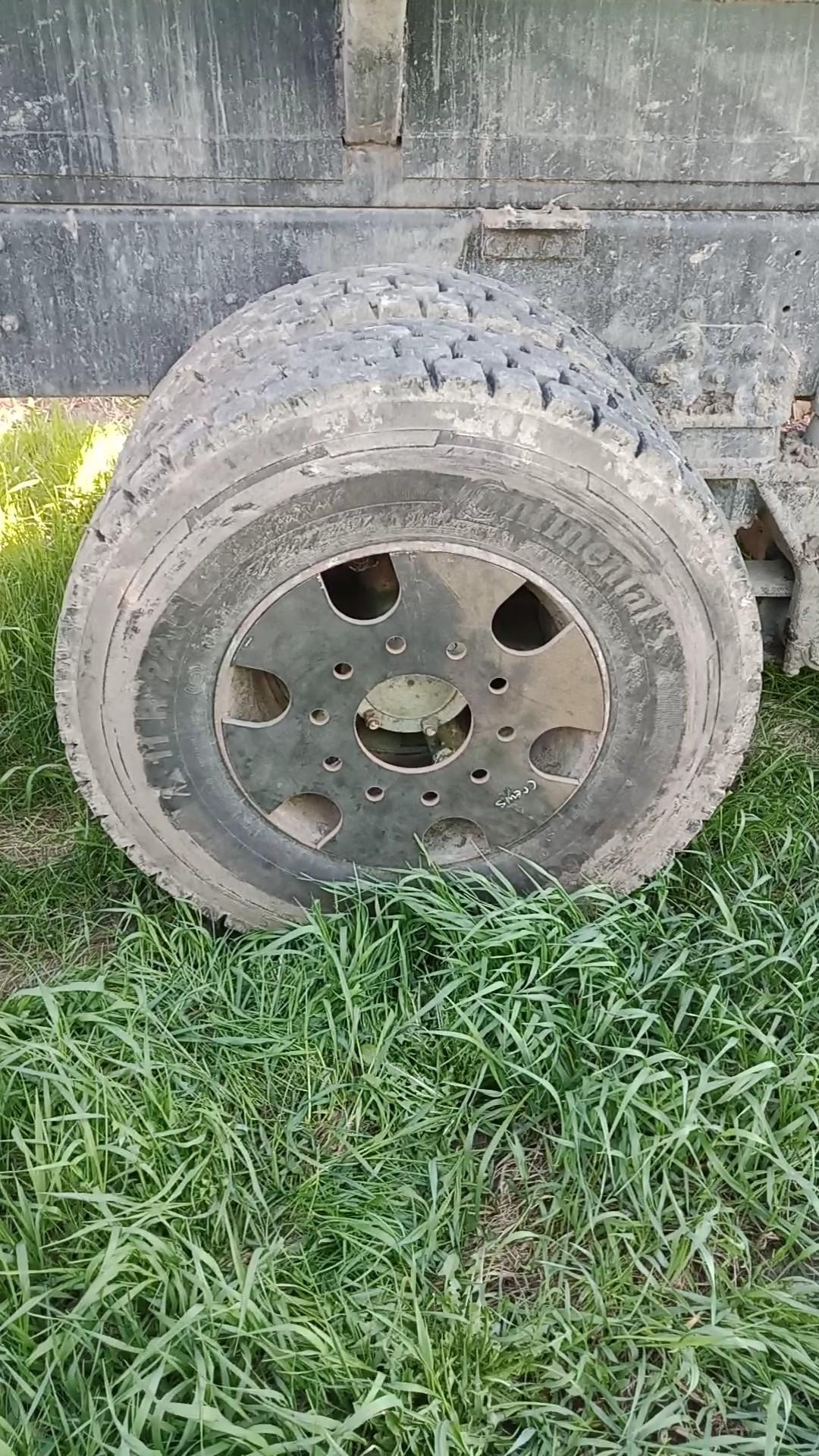

Here are some progress photos. Centering and squaring the plate for welding was easier than I thought, and no additional wobble was incurred. I am cutting some additional pieces for reinforcing the inside, as I agree it will put excessive stress on the edge of the center rim if too much weight is borne by the outside wheel. I also have to make a few small blocks on the surface of the flat adapter to "hub pilot" the outside wheel, as I don't think that I want to get into the complications of special lug nuts. In this photo, the third wheel is secured by 1" bolts. I am considering the possibility of purchasing knurled studs, does anyone know where I could get 40 26mm knurled studs? -

As always thank you for replying. The matieral the adapter plate is made of, is 1/2" (12.7mm) I think you are forgetting my original wheels do not have any centers at all("Dayton style"), so there is no risk of tearing the center out of the second wheel. the six cutouts around the outside are how I will access the nuts and wedges to remove the other two wheels. I may have enough space to weld reinforcement to the inside of the center adapter, but according to my figuring it should be fine. Biggest concern is being able to fixate and weld it accurately in the center. Also the third wheel will be running at half pressure, so the tire will deform if I drive over an obstacle. -

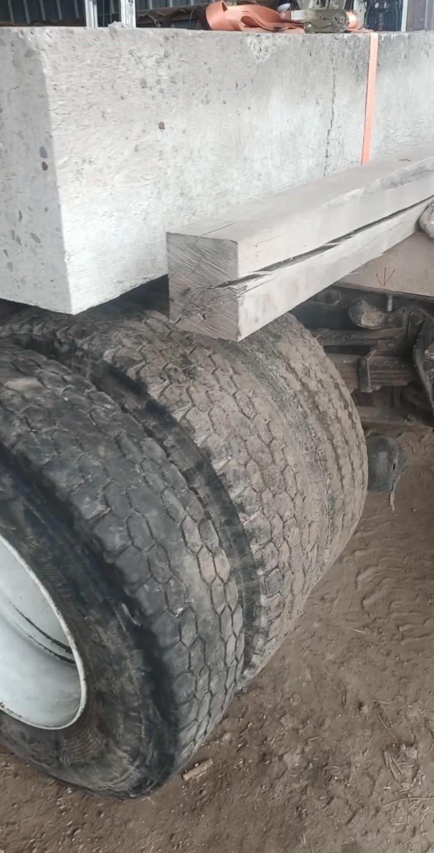

Thanks for the info Vladislav. But have you ever seen Budd style wheels with triples on the rear? What I'm looking for isn't a way to add a bolted wheel to a spoke hub, but actually a way to add a 3rd wheel on my rear axles. 445/65r22.5 singles on the back is not sufficient, I need more like 810/30r22.5 to have enough traction and flotation. I don't see how a mounting plate inside a open center rim would be any different than the mounting face inside the budd rim itself, but it definitely would have to be at least the same thickness. I'll try and build a CAD model so you can see what I mean. -

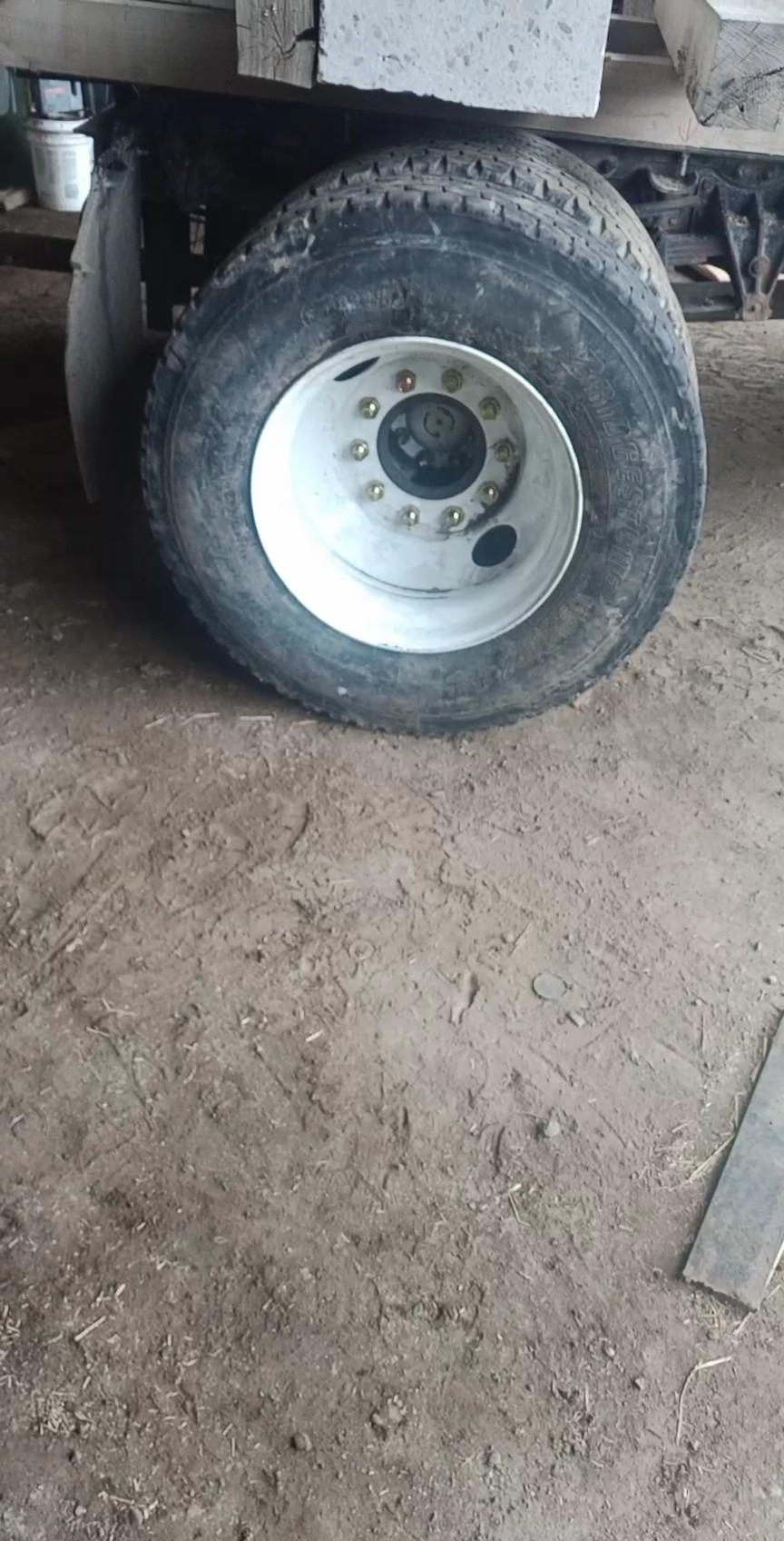

New rubber is on. 650$ per tire 😬 I have gotten stuck once with the new tires but it was my fault not theirs. I got too close to a wet spot and couldn't turn sharp enough to avoid it. Question about the Mack rear ends. Do they all have the "cam type" differential that is supposed to automagically torque bias? I think mine may be worn, because with my lockers engaged I can have only one wheel on each axle spinning if the traction is bad enough. -
