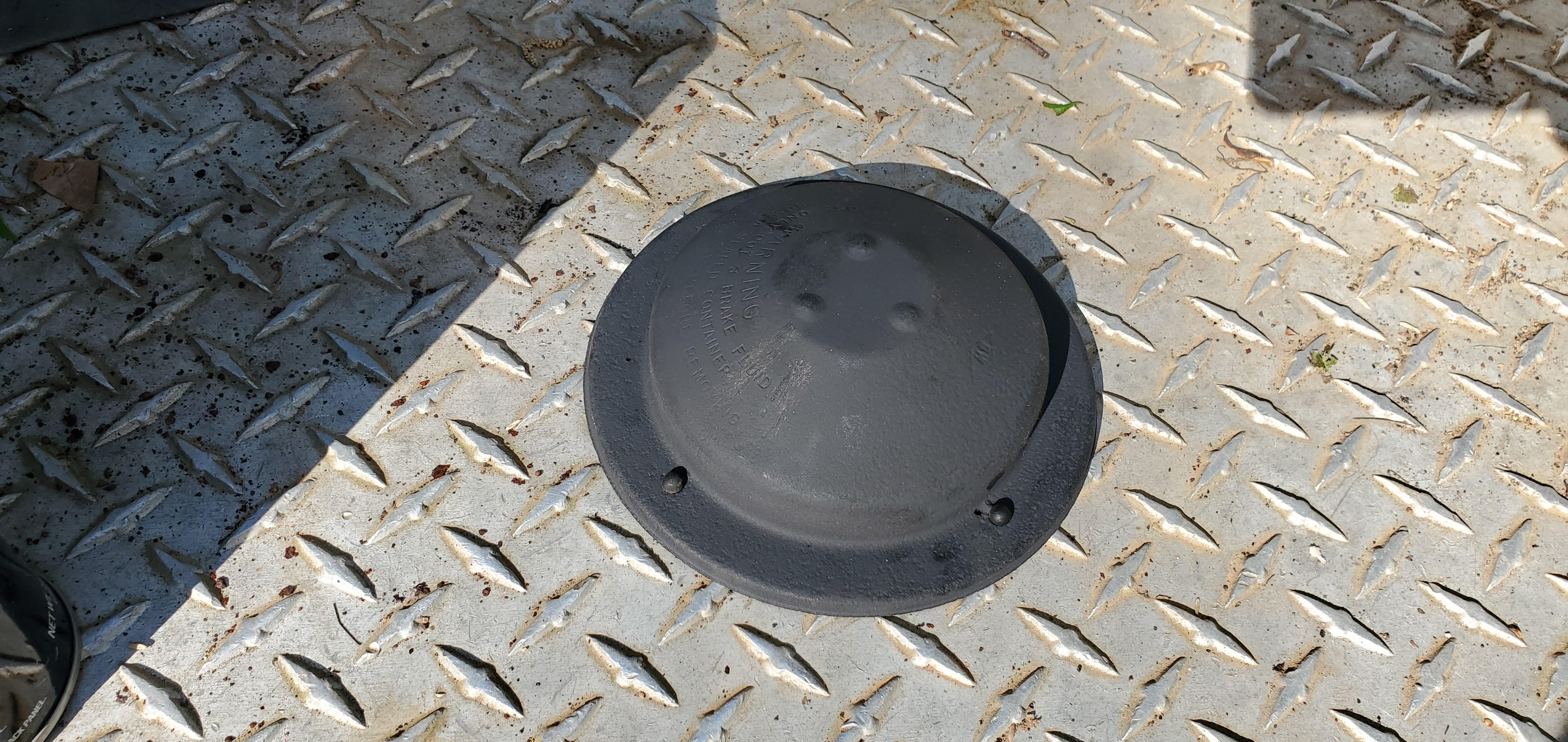

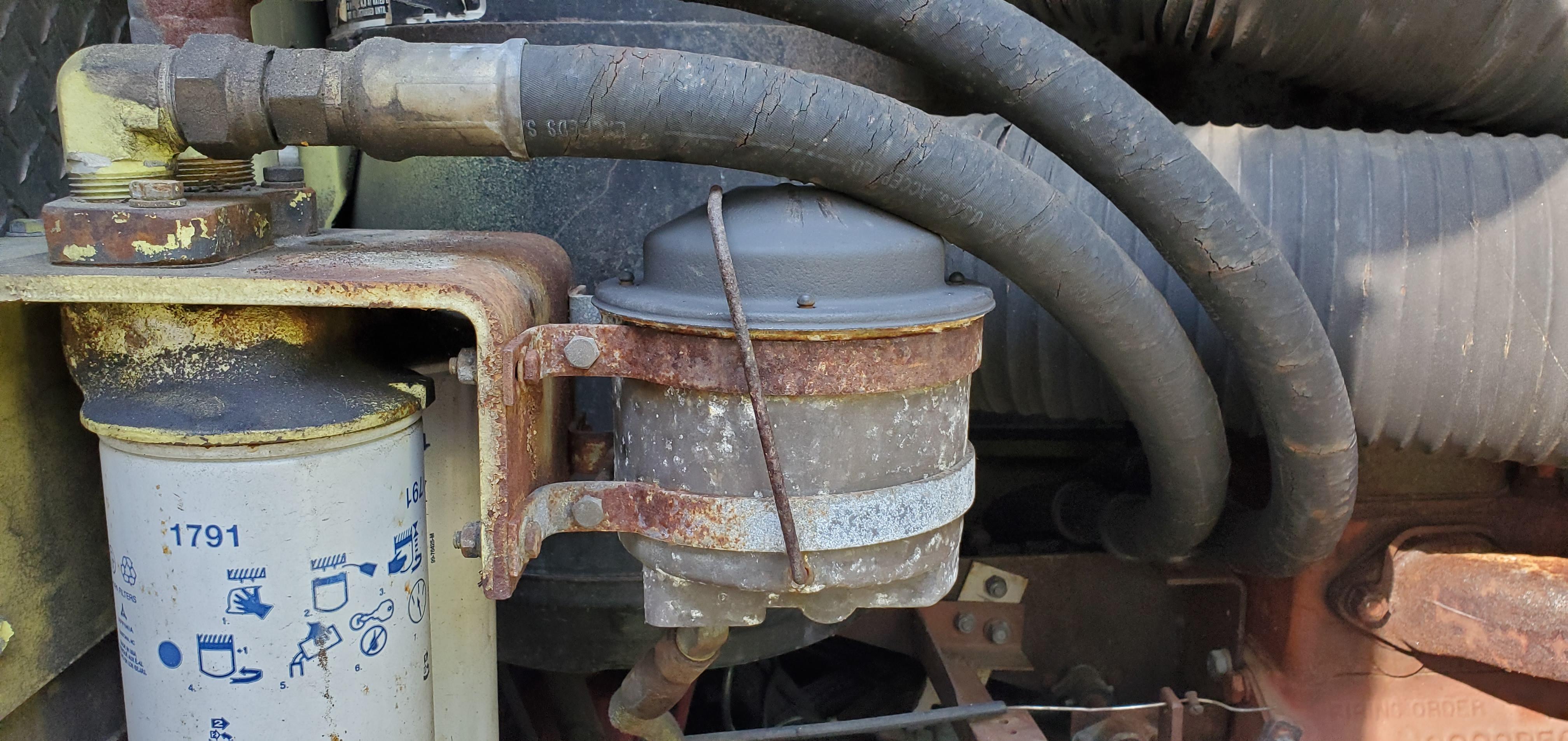

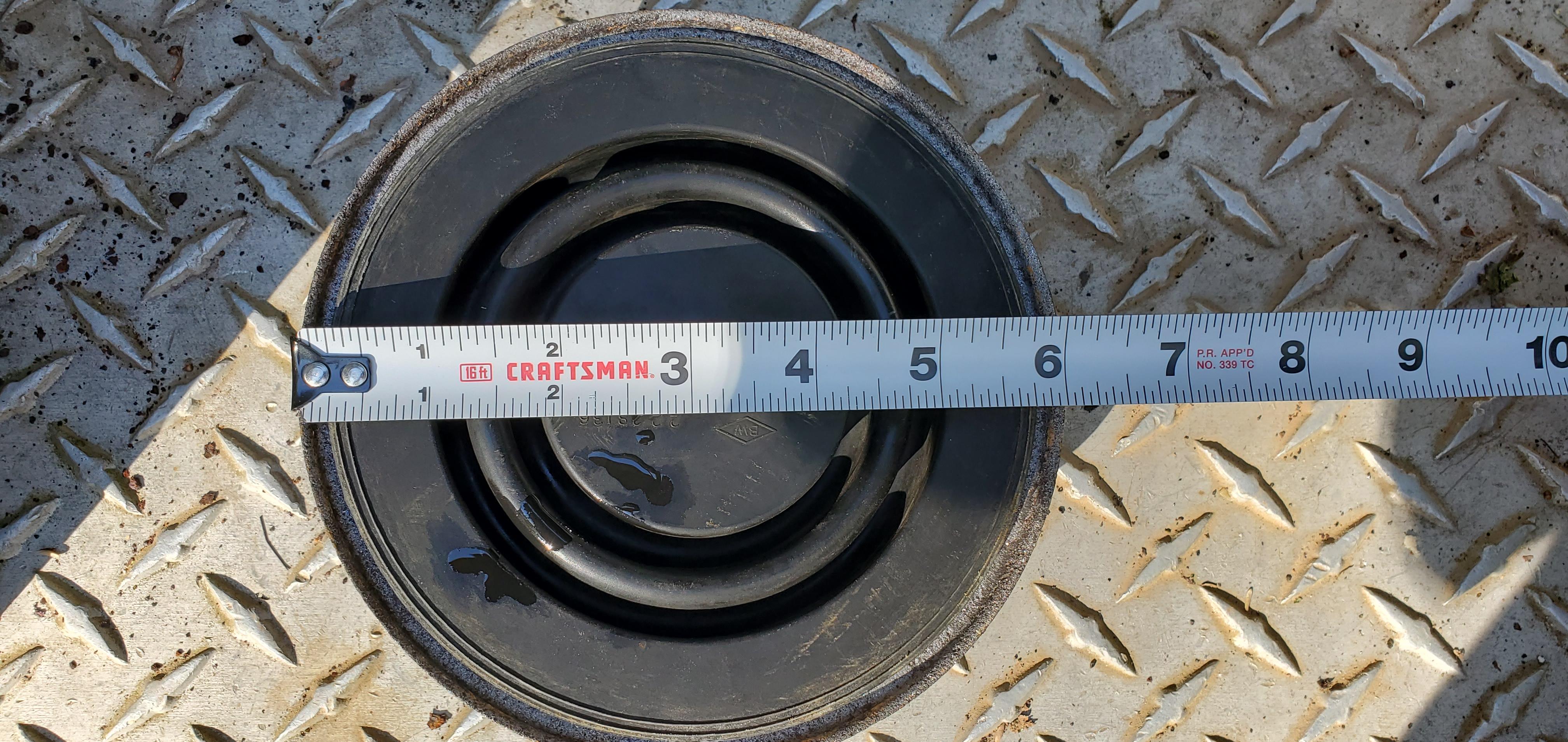

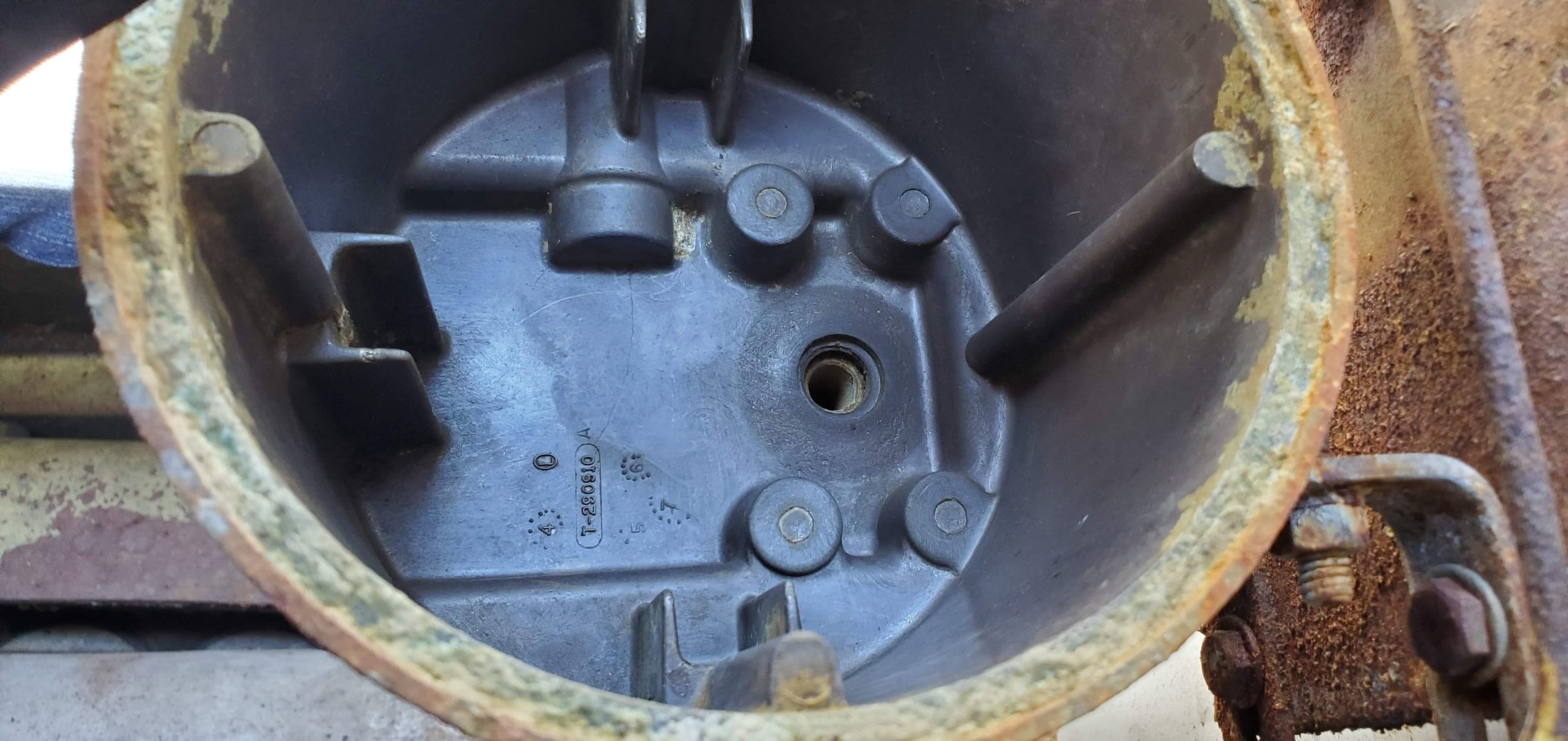

  1. I found a part number cross reference to the rubber diaphram, but was unable to find a part number in any searches or calls I've made for the cap itself or the reservoir.. Part numbers I see on the diaphragm: 2228136,290935. BW(in a diamond) I'm assuming bendix westinghouse Number stamped on bottom of reservoir: T-290910 Cap reads: "WARNING, use only DOT3 brake fluid from a sealed container, clean filler cap before removing" nothing else. I need a replacement cap, or an option to replace the whole unit. Its on a 1980 Mack CF686
