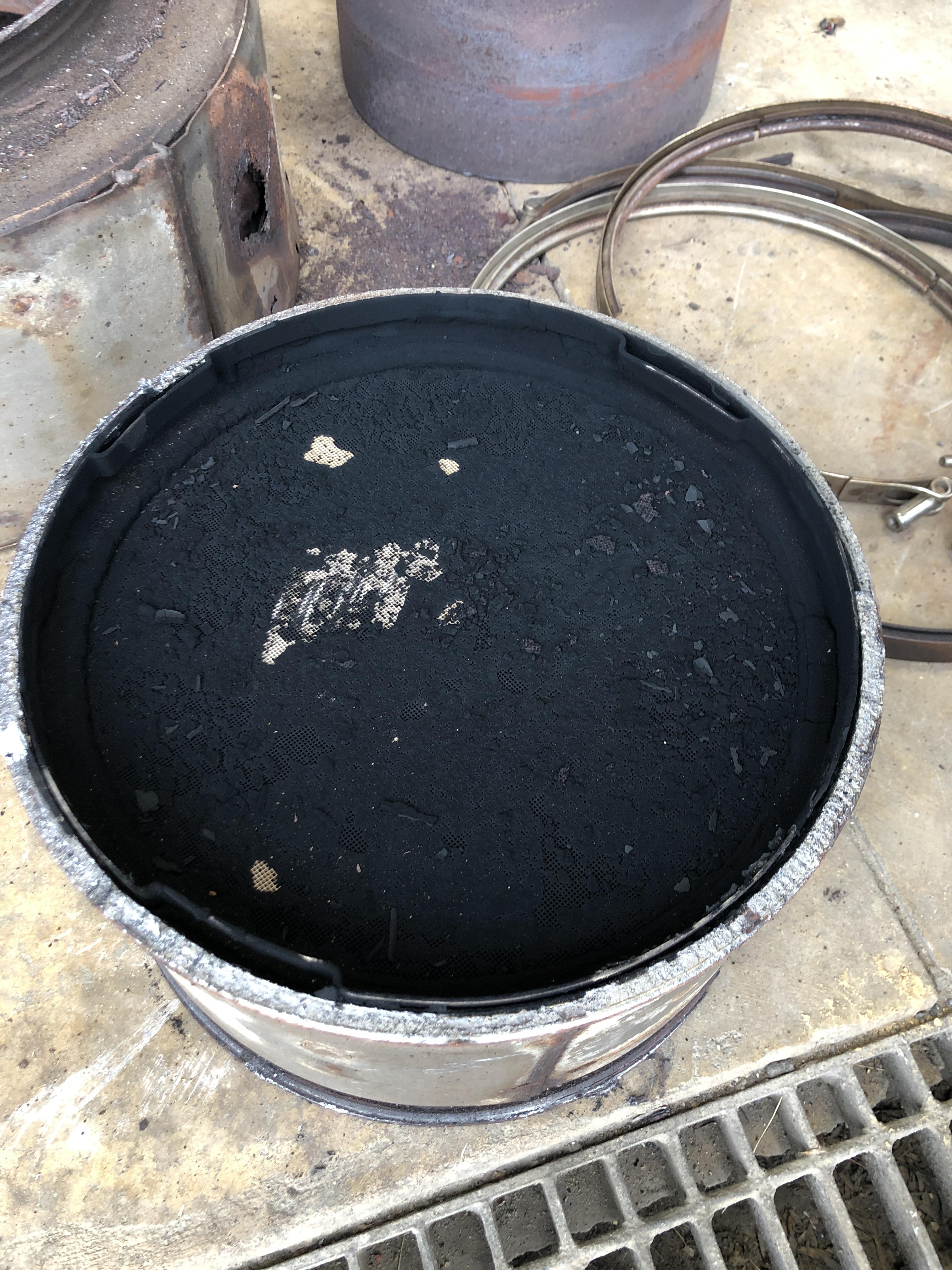

  22. I think that’s the best next step to take. Hopefully you find a lot of soot.
  23. Agreed, I think you should consider taking a look at the filter. I think you will find it face plugged.
  24. I’m not gonna suggest anything extensive before these two read over the info. You have done a great job with your report.
