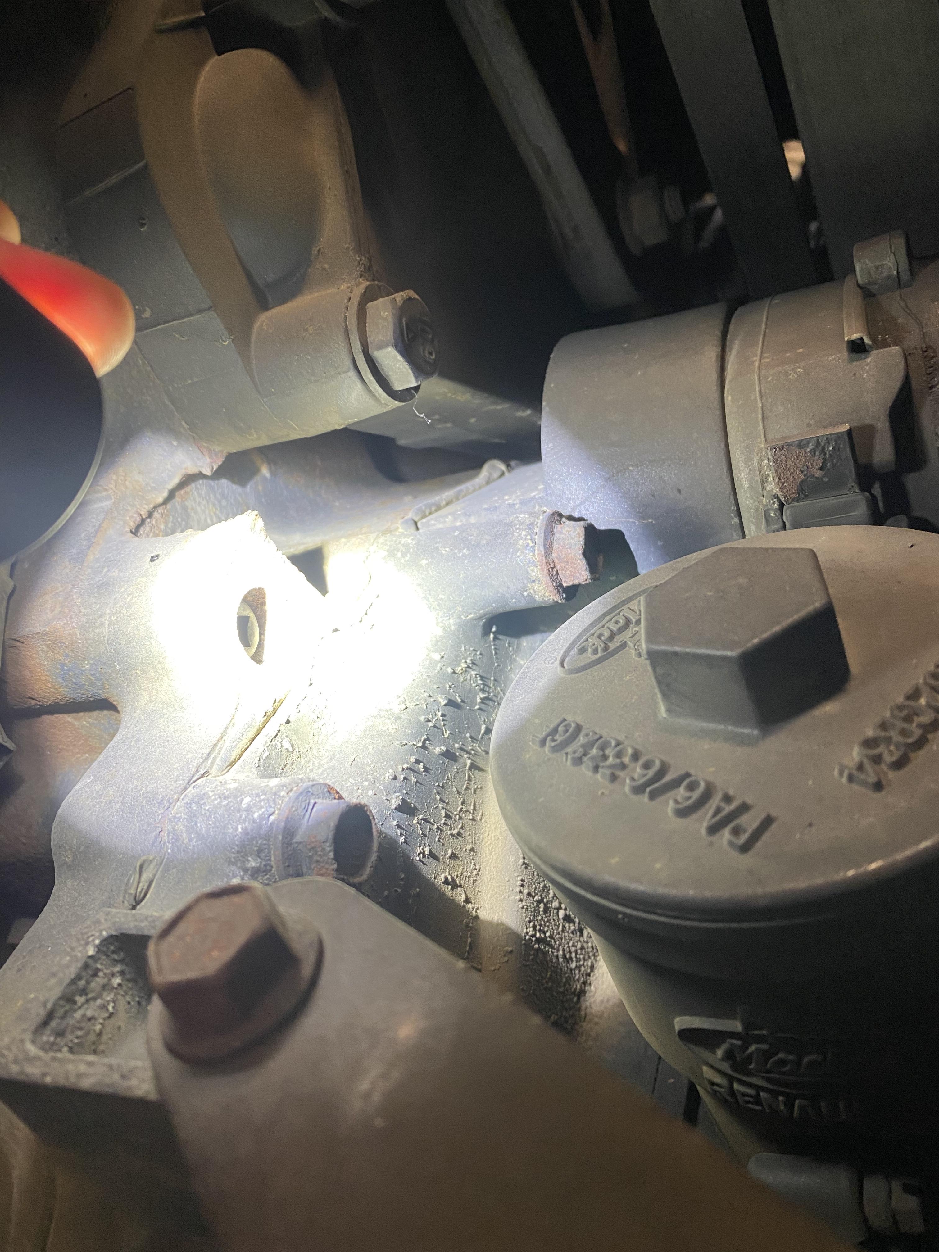

  11. Interesting, thanks Joey. Possible VECU? Clearly do a bunch of tests before jumping to that. I’d say make sure the connector is all the way in and also the pins look good. Then check voltages at the pins and after the sensor.

  16. You can remove that drain back valve and see if it’s moving freely. It’s a 70psi spring. That’s what Mack says in the book anyway.
